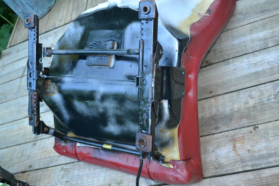

                            F34R, can you go more into detail on how you mounted them? Any pictures of the setup?
                            Also, are they too tall to put headrests?

                                The e24 seat is fiberglass, so I could only weld on the front mounting tabs. I took the e30 slider and mocked up the seat and found where to set the cross members at. Tack weld then flip over the seat and weld them solid.
                                I then bent up side brackets to support them, 5/16 heavy duty wall hanging screws. When you tighten them they pull a bent sleeve of metal tight on the inside. One will hold 85lbs, so I did 3 on one side and two on the other. The seat is 1/4" thick FGlass. Tightened down and bolted in the car. Before installing in my e30 I sat in it and jumped up and down to see if I could break it, I am 235lbs...it did not even creak or loosen up the bolts.
                                Unlike the sports seat or comfort seats these are fixed backs and deep. You DO NOT move an inch in them. The brackets are bent in a fashion to be more ridged. They don't rock from side to side or move around in any way. These are safer than stock seats IMO.
