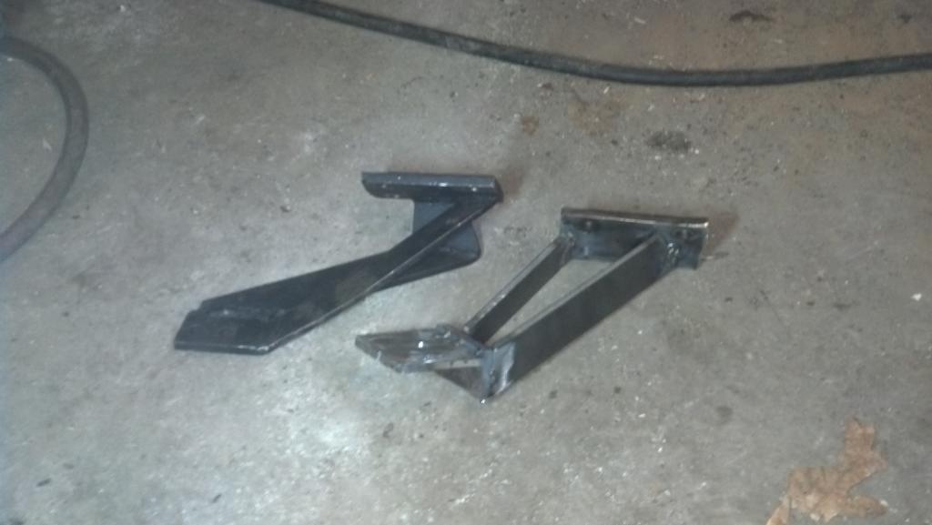

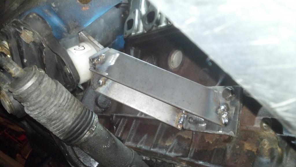

            #290
            Redesigned the M30 passenger side mount. Whoever made these placed them flat...so I made a drop out on the subframe bushing. That moved them down another 1.5 inches but allowed for the arms to be standing instead if laying flat. Tons of clearance while adding a ton more support. Boxing the drop outs in tomorrow and adding little plates to connect both arm beams together.

              #291
              Old design laying next to mine. And mine clear the headers I am making for the M30. Yes you heard it! m30 NA headers.in works and twin scroll coming once I go turbo.

                  #293
                  Man those mounts look so much simpler than the ones you were sent. I liked how they looked in person and the side by side confirms.
