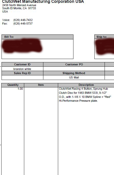

    It is a 4 puck, and I will be boosted by next year. I would have been by the end of the month but I do not want to be without my car any longer. I will do engine work when it is stored :)
    I am excited though, an scca event is this weekend. Looking forward to the improved power band.
    Leave a comment:
  • chance
    replied
    4 button? Does that mean 4 puck?
    If so, have fun. My 6 puck with upgraded pressure plate is hard enough to drive smoothly lol.
    I too put in an upgraded clutch, with dreams of boosting. Your dreams are wayy closer to coming true than mine though.
    Leave a comment:

    Some might know that the m30 is going turbo over the winter. So since the clutch is worn a bit I picked up an M5 flywheel and something to make it all hold the power ;)
    Not much on the front of updates as I have just been enjoying the amazing m30 powerband in a light e30.
    Leave a comment:
