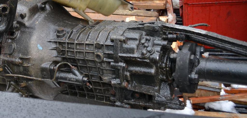

    SETA driveshaft is identical to 87 eta and e30 M3. it is *the* e30 large-giubo driveshaft.
    all driveshaft discussions are pointless without discussing which output flange you have on the 260 - there were three different depths available.
    Ah, good to know
    The output flange came off an 89' 535, I uploaded a cropped picture of the flange I used(fresh from the donor car mid-winter).

    260/6 with the rare SETA(complete front/rear) We should meet up sometime! I'm not far away.Have you heard of the Beer30 meet coming up on the 5th of this month?
    Gotcha.
    My co-workers m30 swap shat his 260. He's swapping in a 265 but needs a different driveshaft for it.
    I did hear about the meet, but I have a retirement dinner to attend the same night, then have to zoom up to winter park for the Bmw cca auto-X the next morning.

    Probably cause your b35 and I'm b34 and probably in different engine postitions.
    Could be, I put the engine and transmission together with the shaft bolted up, then I suspended my engine with a cross brace and made the mounts where it sat :D

    Originally posted by F34R
    Nope, I just put the splines together and it is a flush gap.

    Did you have to shorten yours? Im running same DS and had to take 1.5 inches out of mine i believe.
