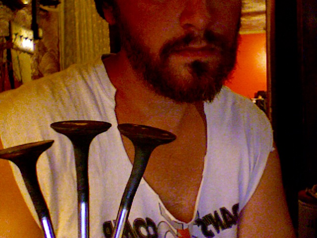

                                Little update:
                                Sent the head off to get cleaned and a valve job done. Turns out the springs were TOAST and the previous owner over rev'd it a few times. They found that ALL of the exhaust valves are bent(pic below) Intake ones were perfect and ready to rock. I ordered up new parts to replace those and while I was there got the springs, guides etc. In short total rebuilt head for the turbo motor build!
                                The shop said they will have it done this week. Valves are getting seated and I had it taken down a bit to remove the uneven wear from useage. The place I am having the work done at is a high performance engine building shop. So they work with boost builds and dragsters etc ;) It is going to cost sigh but it is being done right =)
                                Here is three of the valves.
