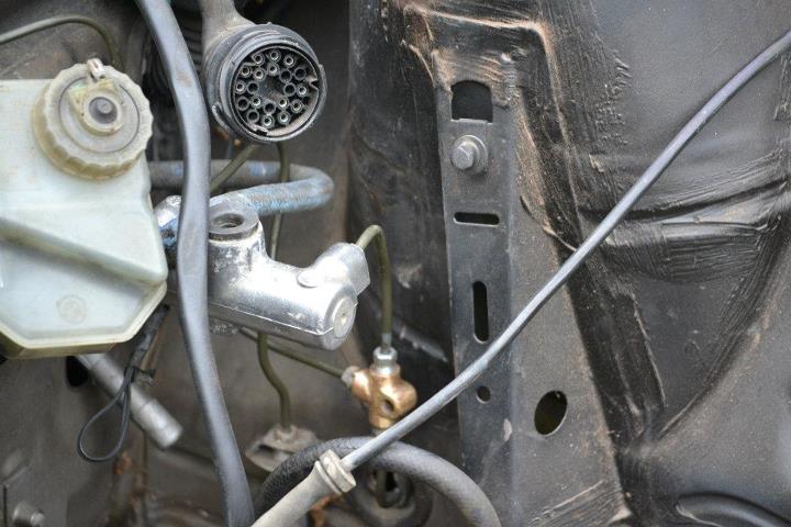

                  Back on topic I forgot I cleaned up the brake lines since I deleted the ABS unit.
                  Also swapped a 1.9L Z3 rack
