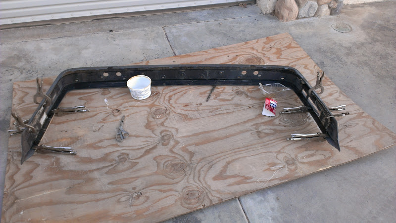

This weekend was mainly to get the rear bumper shortened, fiber glassed, and ready to paint. Also the hope was to get the valance welded...but not likely to happen.

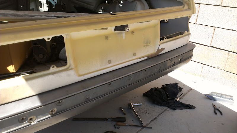

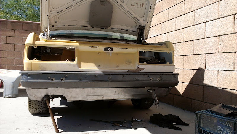

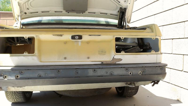

So here are the pics, mockup and fiber work. Mockup was mainly to check for the gap and the slots I made for the bumper shocks. I think the OEM gap is a little bigger and I am not sure if I will drop it down or not. Alex (iwantspeed) said he liked it at the height its at now. Let me know what you guys think.

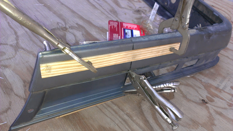

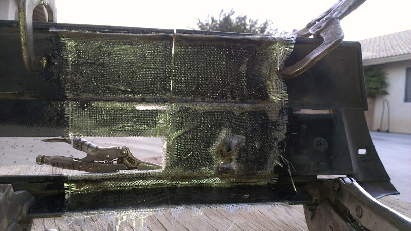

Some fiber work. I only put down the first of 4 layers...wanted this to cure and will add more tomorrow tills its nice and strong. Also took a tip from Janderson about using the stir sticks as a brace, worked perfectly. I noticed on Janderson's conversion he kept the inner brackets from the bumper. I didn't see the need for them other than perhaps strength and we aren't even using the brackets that they hooked into. So for the sake of simplifying things, I cut those brackets out and wont be using them.
