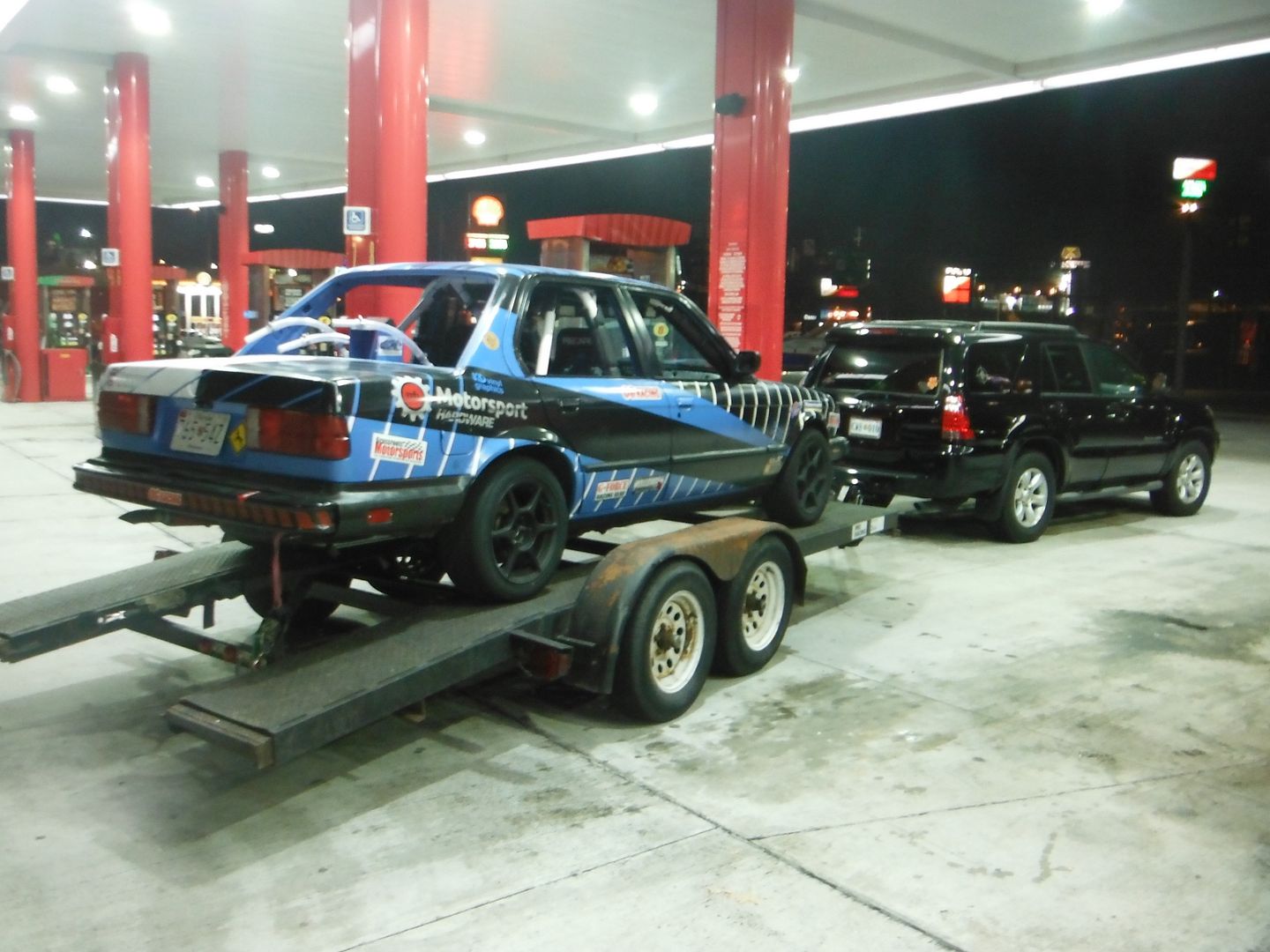

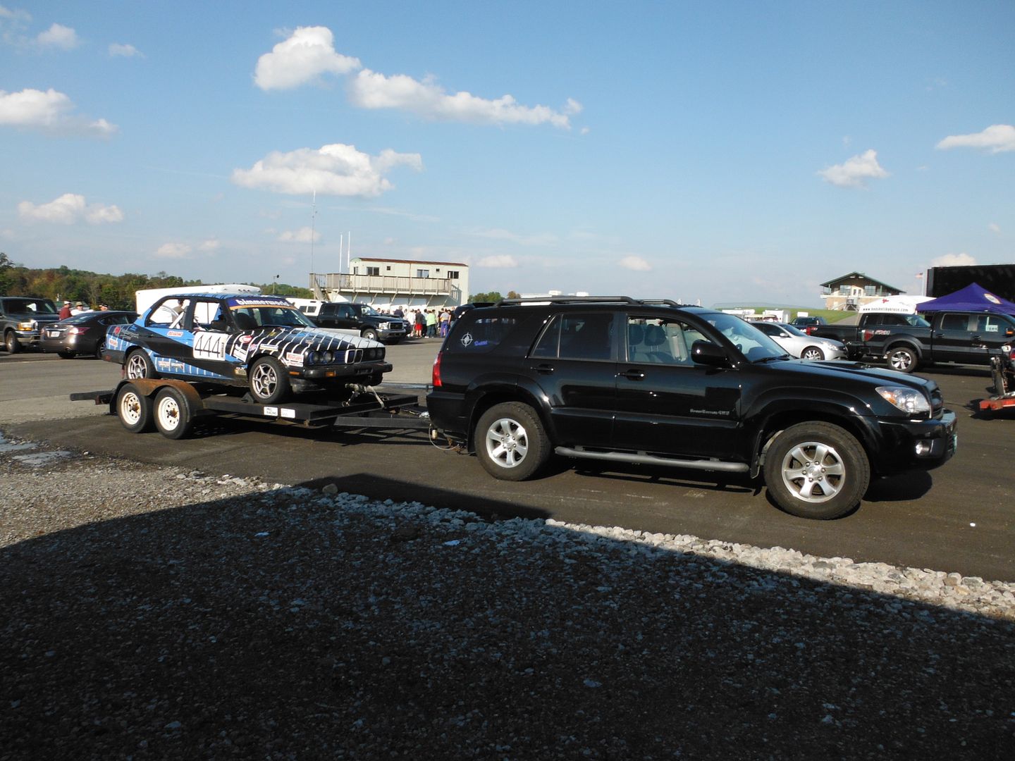

Actually it did great. We towed a 1700lb trailer and the 2400ish lb car. I have a brake controller and the trailer had electric brakes. Also installed a tranny cooler just to be safe. 4Runner pulled great and was stable while running 70mph through the Applachians.
I have the standard hitch on my V6 (not the weight-distributing one that comes on the V8), and didn't use sway control. No problems at all, no issues, etc. Only time it struggled a bit is when we had to take a rural highway that was VERY hilly and I got caught a few times at the bottom of hills by slow cars and couldn't keep up speed. But otherwise sometimes I forgot the trailer was even there. As you can see in the pic, it sits pretty level. I loaded the trailer to get a tongue weight of 400lbs or so (my estimate) so it wasn't too much hitch load, but not too much rear trailer load (which causes sway).
That said, i did make two passes of slow cars on the rural highway, which was kind of fun with a trailer, lol.
All in all, it did much better than I expected. I also towed the e21 home from W.Va. on a Uhaul trailer (those are like 2300lbs + 2400lb car, so a heavier load and only surge brakes). That was a bit slower but still a pretty easy tow.
I think the 4Runner is great for many things, and it's just fine for towing here and there if you're towing a light car/open trailer. Now if you want to tow 6k lbs or something cross-country or all over the place, something bigger and/or diesel is probably the way to go. Or the V8 4Runner.

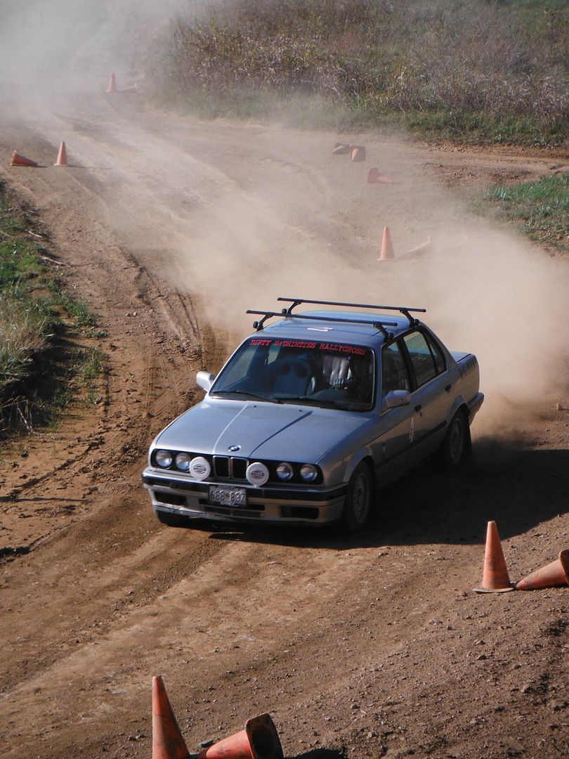

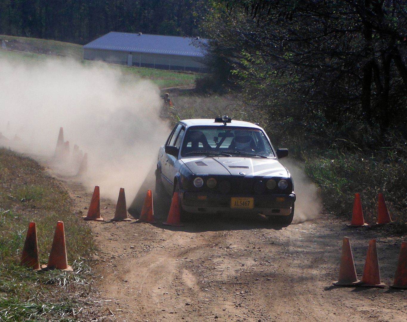

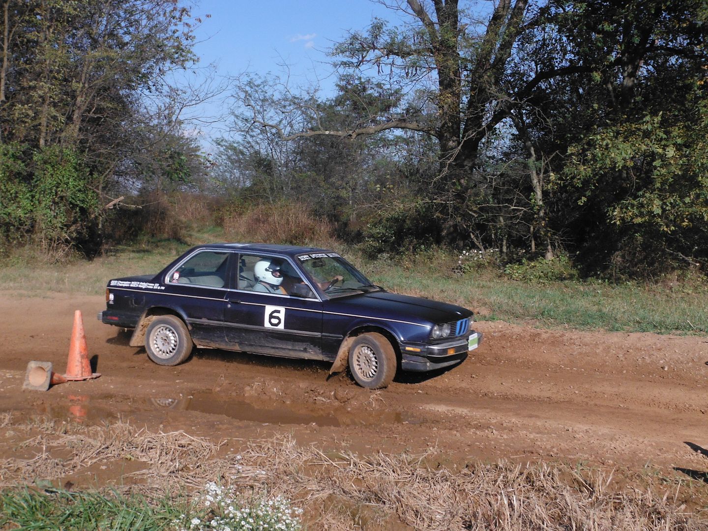

So, a quick update from today's event. This is series event #6 out of 7. Coming into the event I was sitting in 2nd place, but to have a chance of winning the season I needed to win both of the last two events, or at least finish ahead of the class leader Roberto.
Today's event was expected to be on the "Barn Course," which is my fastest course and which I've won both times we've run on it this year. Unfortunately, due to all the rain last week Barn was heavily rutted and couldn't be used. Also due to post-ponement of the last event about 15 cars dropped out, giving us a smaller field, so they decided to use the "Gravel Course," which can only handle 40 or so cars due to a limited paddock/grid area there. Also unfortunate is that usually Gravel is my worst of the three courses, as it is usually very loose and deep/fluffy stuff and IMO is more of a "power" course than a finesse course.
Got lucky today though - all the rain really firmed it up so not much loose stuff. Also still damp enough that we had no water truck visits and the course ended up by the afternoon being hard-pack and rocky - more my style :)
Also today I had a co-driver. Chris Nonack, who ran his V6 MR2 very fast the last 2 seasons (but kept on breaking it) and then ran his 85 Celica at the last event before bending the control arms. He said he wanted to know what all the hype was about with e30s so I let him co-drive with me. I'll add that he is a better driver than me, I already knew that. But he had never driven my car so that should be an equalizer, right?
Long story short....we did 13 runs today with overall comp times running about 700-800 seconds, so a lot of seat time. In the end, Chris edged me out by 12 seconds to take first place in my car. He was actually about 1-2 seconds faster a run than me but coned alot. He drives in a "flatout" style rather than the "precision" style I try to run. So he had 10+ cones on the day and I only had a few.
More importantly, I managed to edge out Roberto in the end by about 2 seconds total (though I had a 8-second lead with 3 runs left so I drove "carefully" with no cones, while he grappled back going all-out).
So that puts me in a position where a win in the last event would give me a tie for first on the season series. Hardly a foregone conclusion. THe last event will be on a VERY long "Big Course" that Roberto is generally a bit faster than me on. So it'll be mostly on the conditions to see who can pull it off. 3 weeks from now.
On the other plus, Chris noted that of all the MR cars he's driven locally (including the RX7s, MR2s, and others) mine is probably the fastest and best set-up. So this goes along with what I've always thought about myself: I'm very good at building a car "for purpose" but I still need to improve my driving aggressiveness. Building has always been a stronger point for me than the actual driving, annoyingly.
I have no power/handling mods that I can get done before the last event, so I'll probably put a bit of effort into shedding some more weight and go all-in......rear door glass will get Lexan'd perhaps (if I have time), passenger seat will be coming out for sure (it's pretty heavy), and I may do a few other small things. I don't think it will make a huge difference, but maybe it will be a mental assist.
Anyhow, some pics from today.

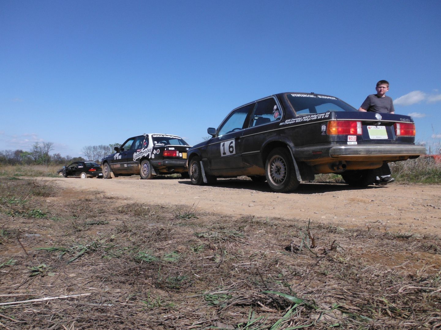

The ETA boys, locking up a 1-2 finish in PR and also a 4th place in MR.

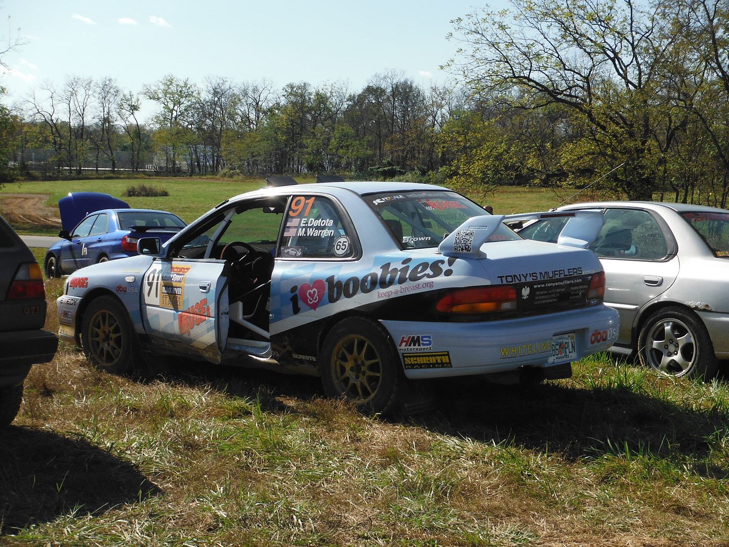

Erika Detota's Atlantic-winning FWD stage-rally car. Nice

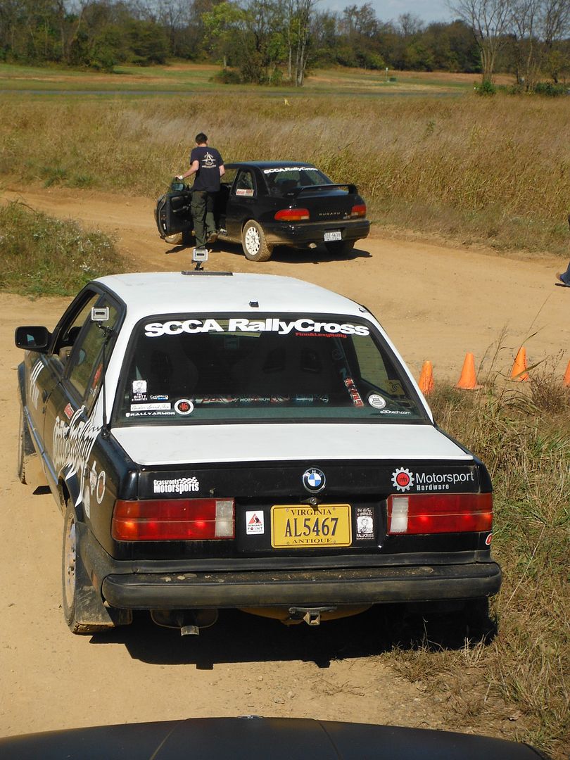

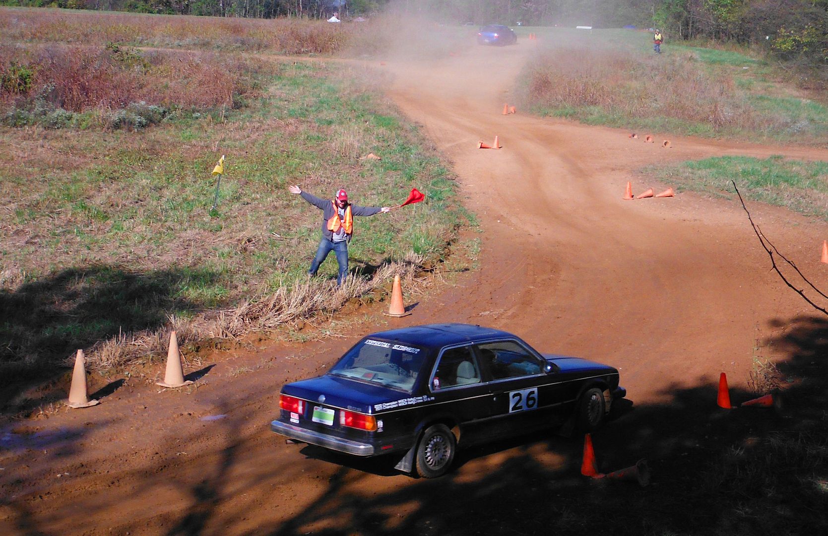

Jim red-flagging his own teammates due to a Subie spinning out up the hill...

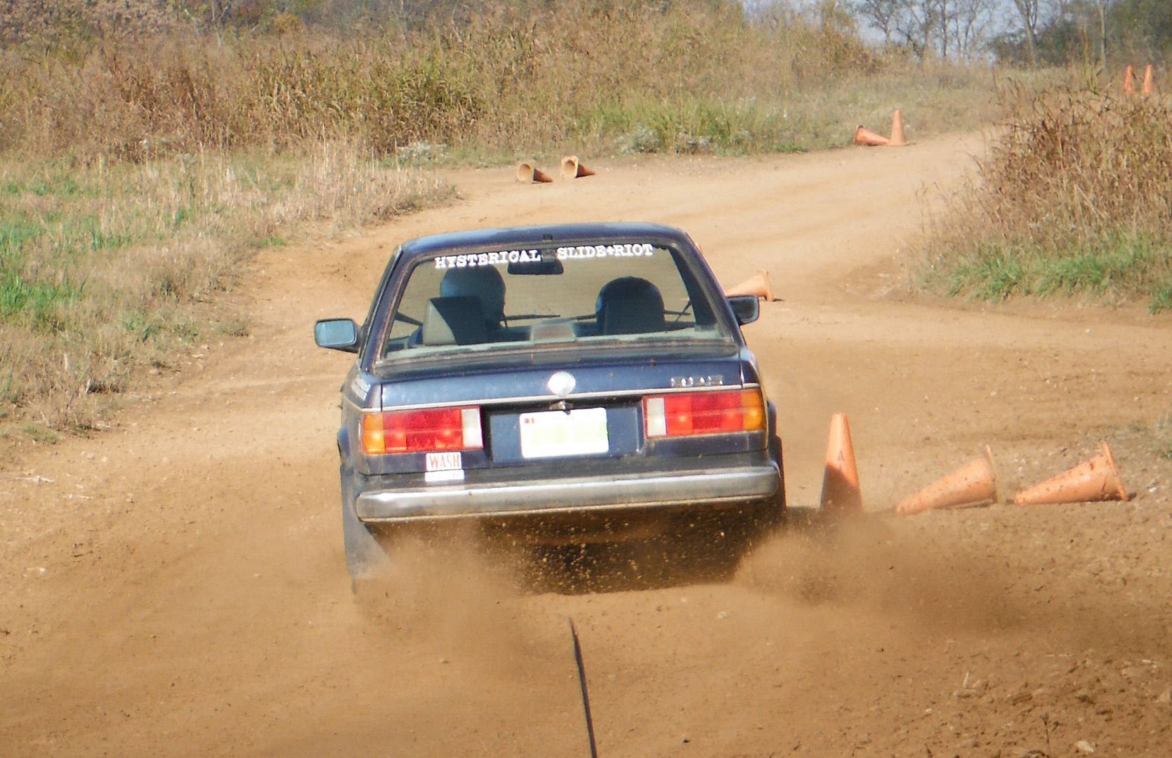

the slide riot

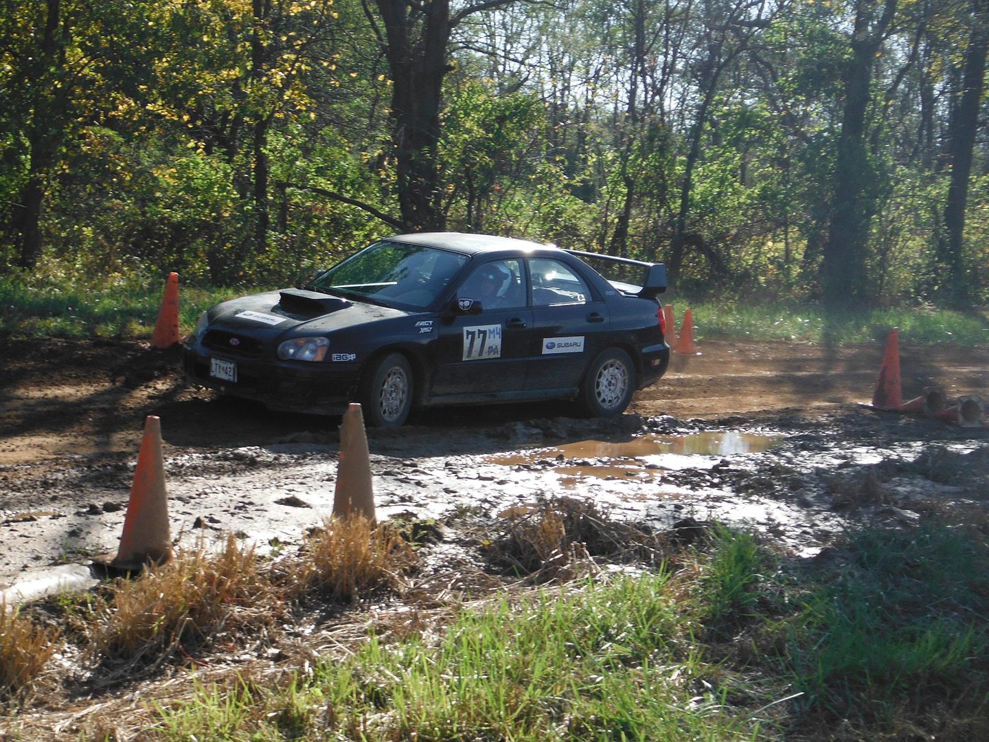

Adam K, one of the M4 front-runners and head-dog for WDCR region

(Your last photo is of Mike Vess)
(It's okay, black Subarus are boring and all look the same)
(Oh, you fixed it in your second post)
