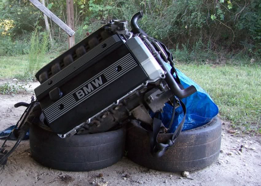

    And this is our M50
    Here's the motor after I cleaned up the plastic panels and I repainted the valve cover.
    Yesterday, we pulled what was left of the block, trans, and driveshaft out of the car.
    We just bought the engine mount arms this morning so we are waiting to get those in. So hopefully we will have the motor in by this up coming weekend. We still have to have a couple custom things made but it won't be too much longer.
    We are also trying to build this whole car under $1k. We only spent $160 on the motor ;)
