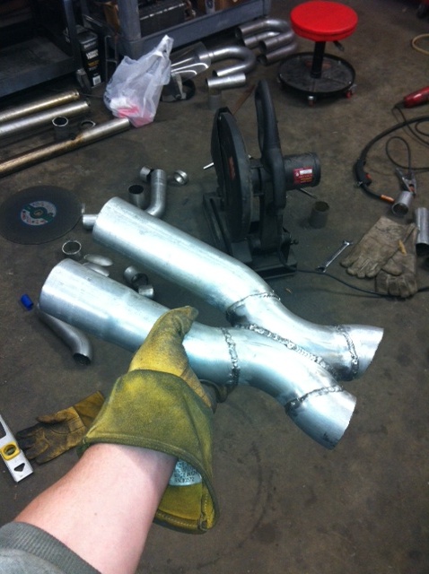

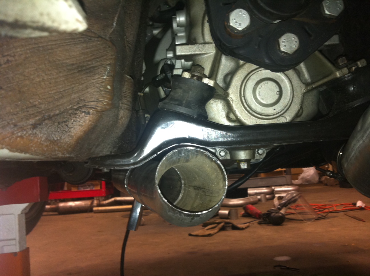

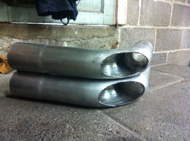

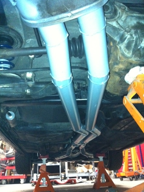

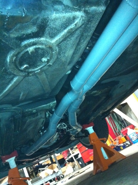

Started on the exhaust today. I'm really happy with the progress so far. I've got the front pieces tacked together, ready to make an x-pipe next.
The complete repair, rebuild, repaint, and v8 swap of my early model sedan

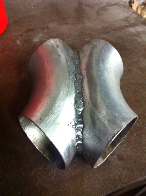

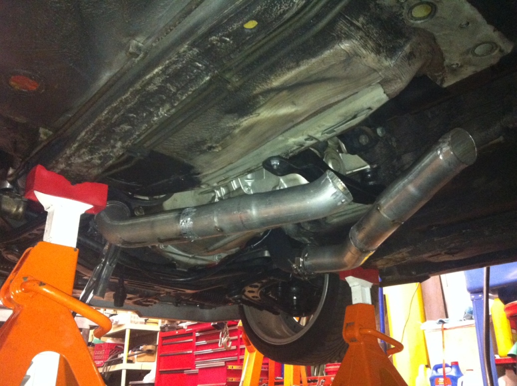

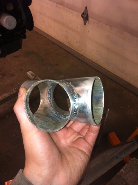

Lots more progress today. I made an X-pipe, and welded the front parts of the exhaust together. This has been really enjoyable so far, I can't believe how miserable it was the first time around. I guess that's the difference between working on an unlimited time budget, vs. trying to have it done yesterday.

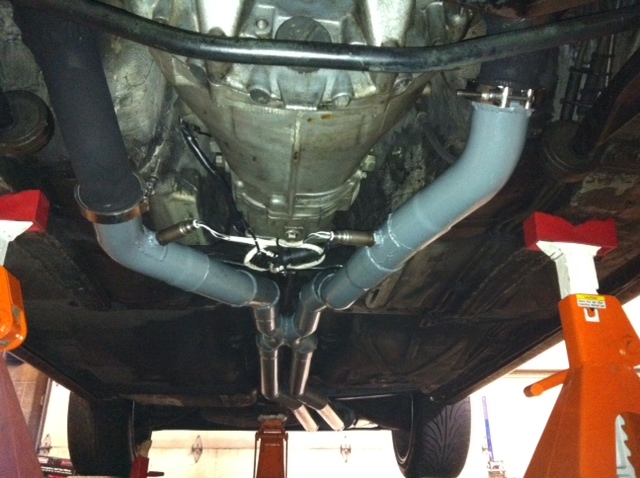

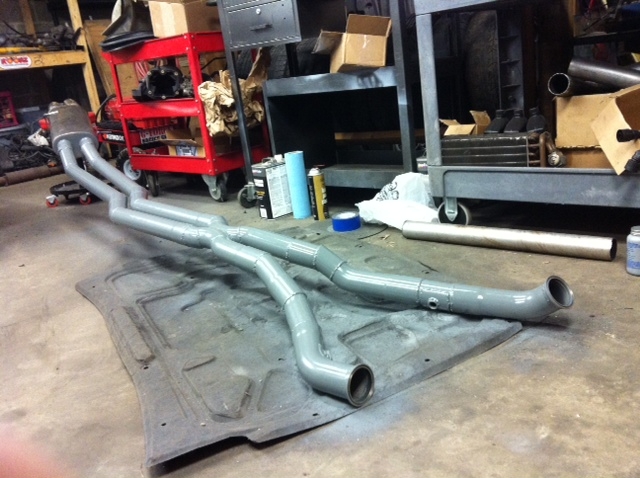

Finished the exhaust. The car sounds so much better without leaking manifolds, and with the x-pipe. It's got much more of the expected deep v8 rumble. I took it for a 10 minute drive with the o2 sensors hooked up, to see if I finally put the issues to rest that have plagued the car from the start. The car didn't even try to stall at all, which is VERY good news, but I'm not getting my hopes up yet. It still hesitates for a second when getting on the gas after engine braking for a few seconds. I've also got a new engine code coming up, "ignition secondary monitor", which is strange. May be a flaky coil or boot, but I didn't touch any of them, and I've tested/replaced them all during previous troubleshooting. Or maybe the DME is finally throwing a code to hint at what the problem has been all along. Either way, I'll need to track the cause of that down.
I can't say enough good things about the Boost Depot's male/female stainless v-band clamps. Very high quality pieces at an affordable price. I will never use another style exhaust clamp. Not even a normal v-band.
The car and I aren't huge fans of cold weather, so back in the garage we go. I'll wait until a nicer day to put some miles on it and continue troubleshooting and working out the bugs.
