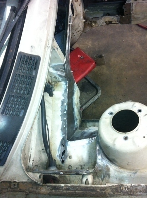

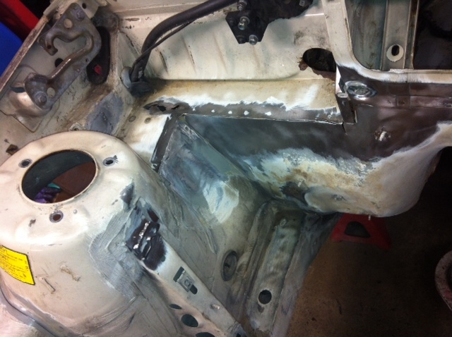

Removed the battery tray today. This frees up a bunch of usable room in the engine bay, to be able to work around the engine easier or possibly even allow room to mount something for the V8 swap. I think it looks cleaner as well.

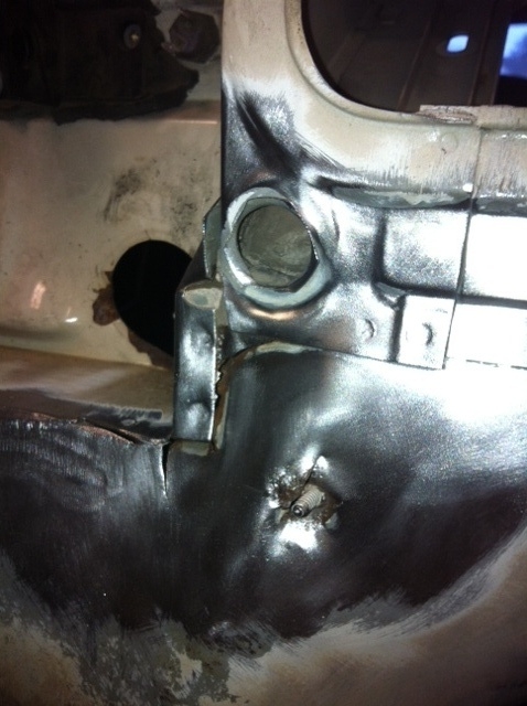

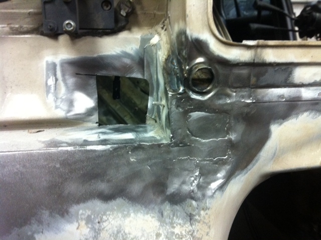

Also fixed the cowl area cracks and rust, and cut out the old mangled and rusty engine wire harness hole. I'm considering closing this hole off and mounting the e34 DME box in the engine bay if I can find room.
Before:
After:
