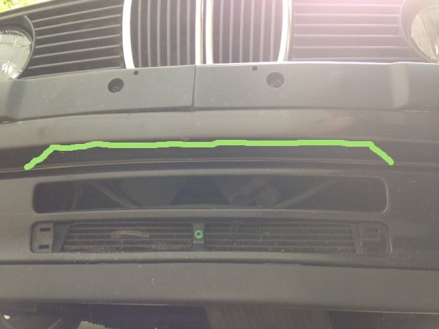

    yeah I got it, I'll probably do that, also I would grab another hood to cut not my current one. I'm not going to make the holes ovals as the circle holes are less noticeable.
