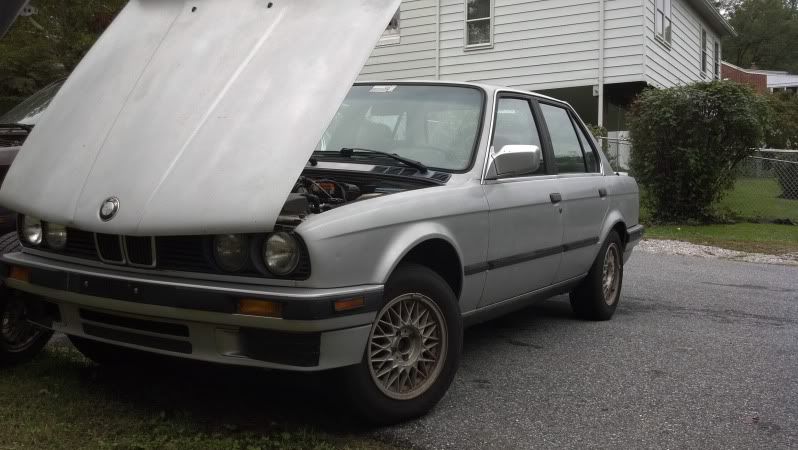

    I bought this car last Wednesday. It was owned by a spec e30 guy who already has a race car. He started building this for spec e30 but when the rules did not allow the m42's or eta engines anymore he stopped progress and started to daily it for a while.
    The good:
    Florida Car
    Rust free except for one corner of lower valance
    m42
    light
    4dr
    poly bushings already installed
    has the tightest shifter I have ever driven... must be all new bushings feels good though
    The bad:

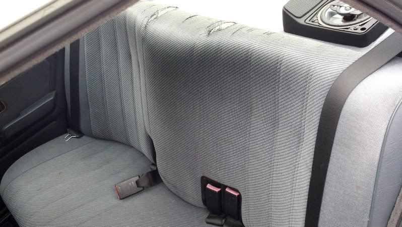

    Cracked paint on the hood roof and the trunk lid
    Dents and dings

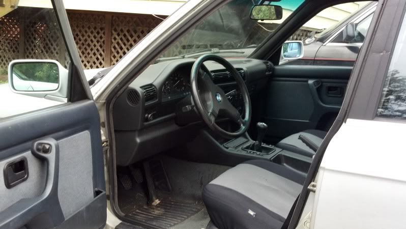

    Interior sucks
    Lower rear valance rust

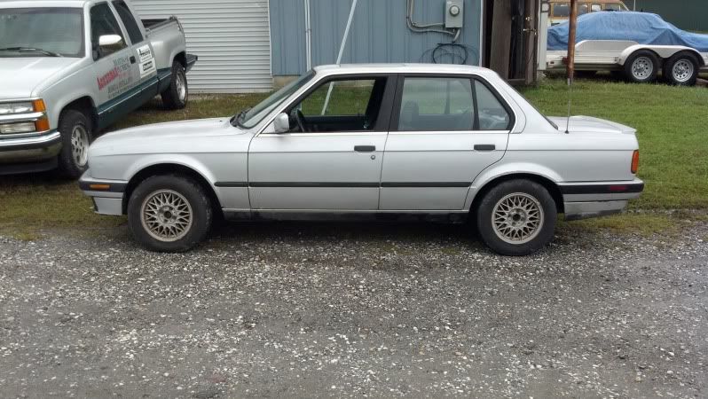

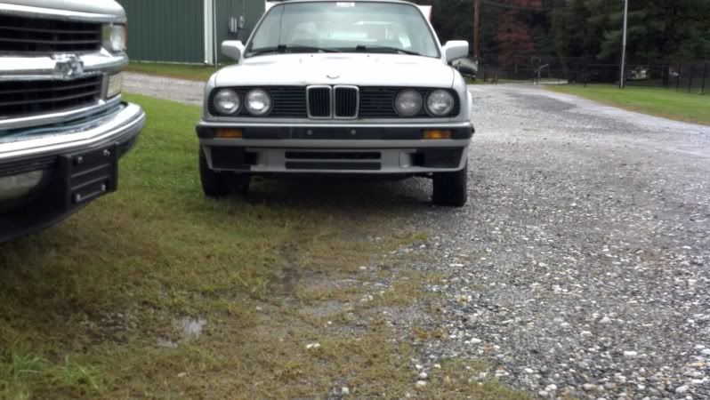

    Day I bought it:
    No rust

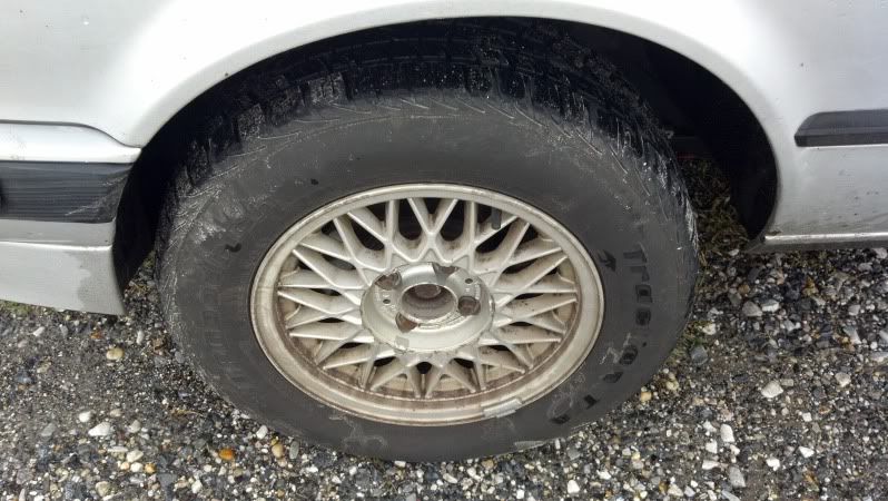

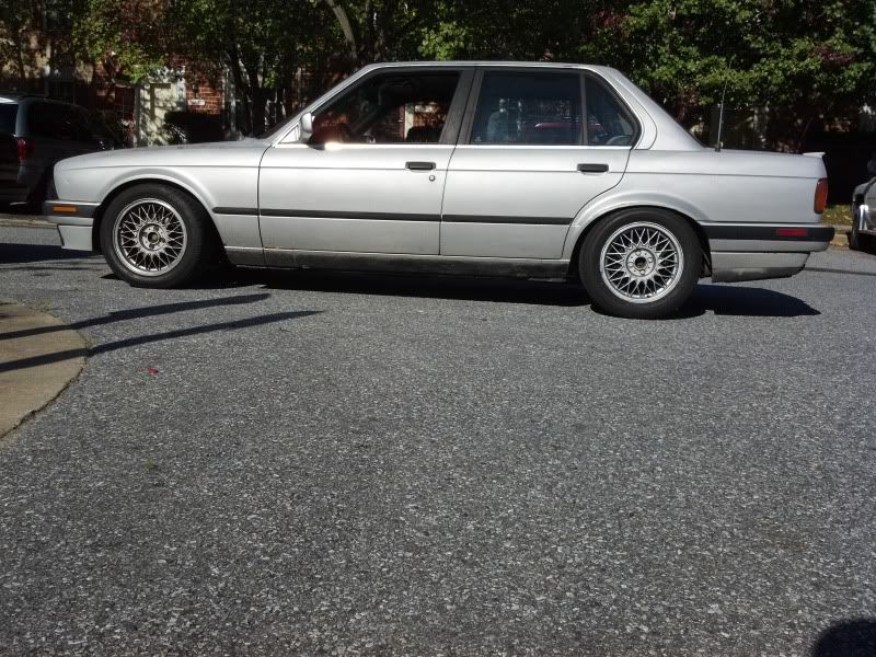

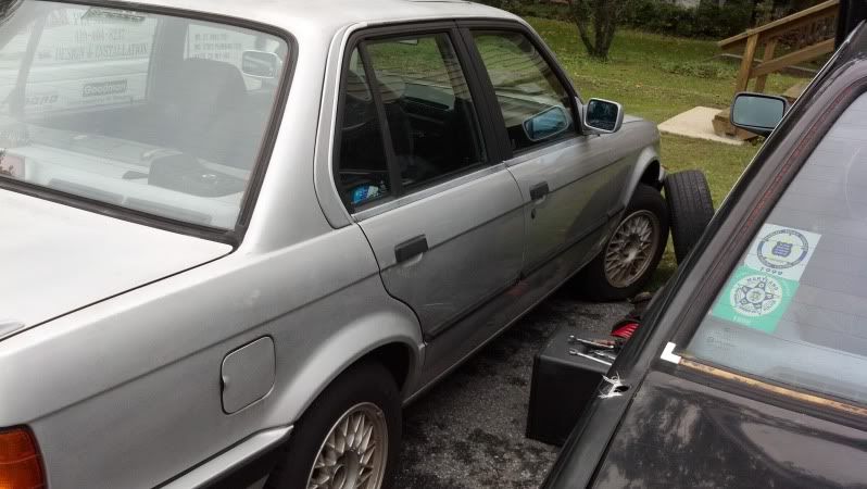

    As much fun as it was driving over speed bumps at 40mph the 4wd stance had to go.

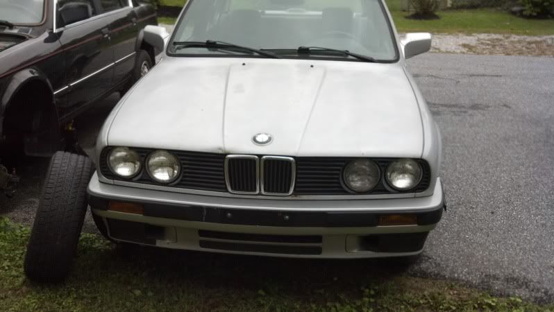

    Day 2 realized I felt very weird driving stock e30...

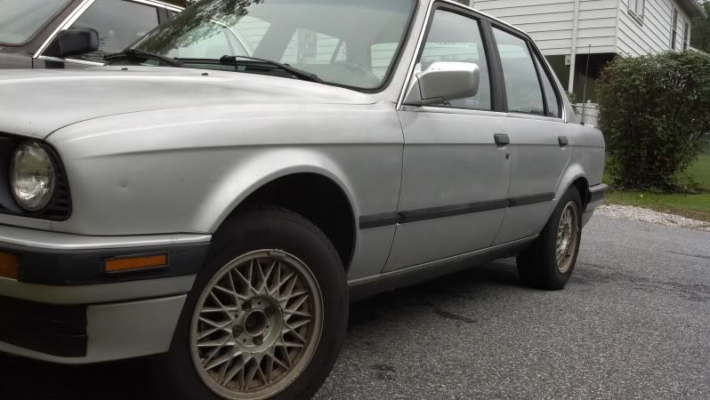

    So decided to lower dis bitch and threw the euroweaves on:

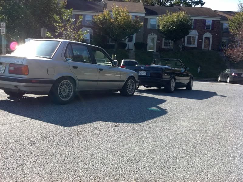

    On the way to capitol raceway with knucklehead Devon...

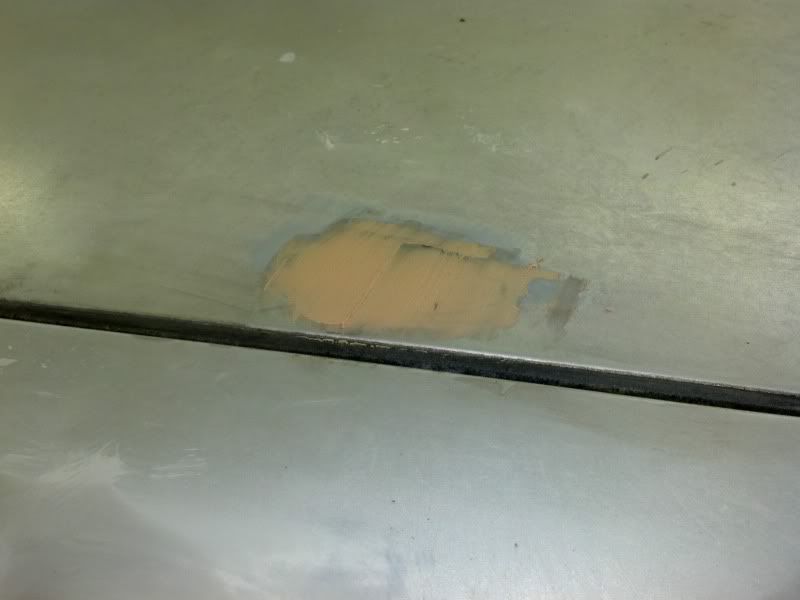

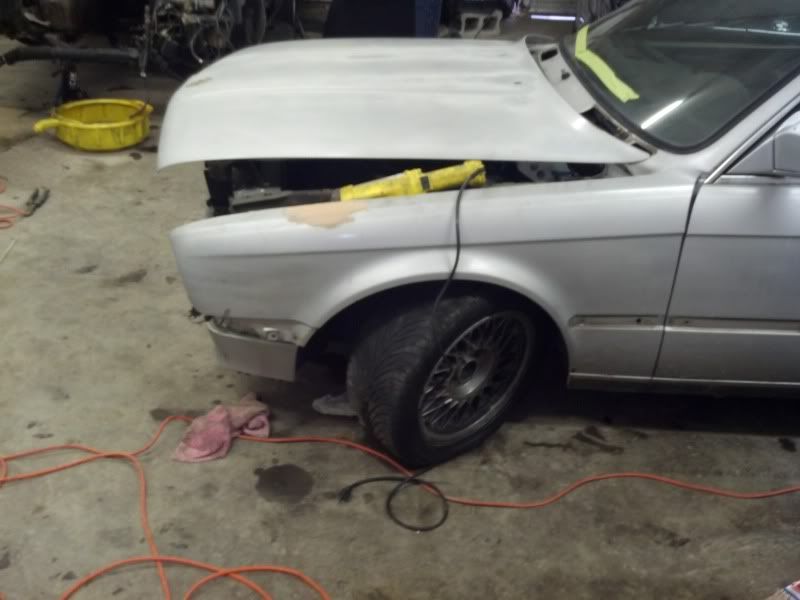

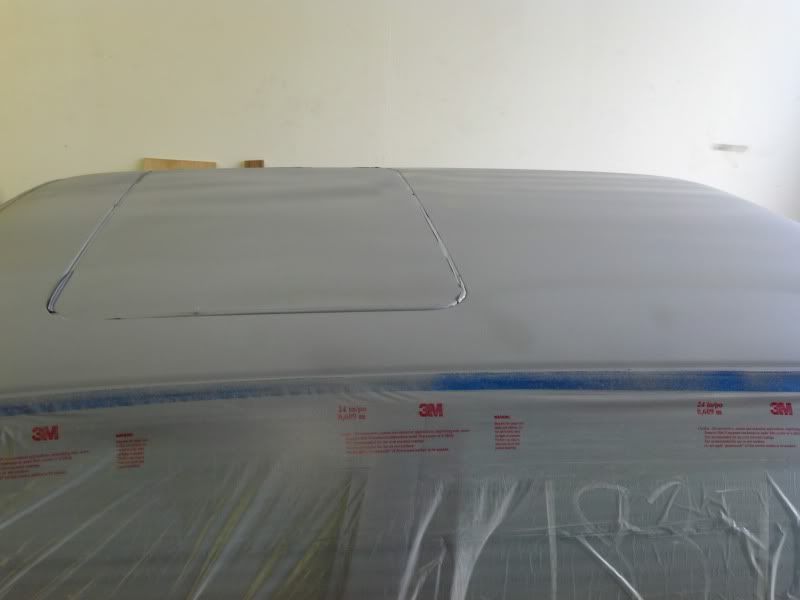

    I've never painted a car or done any major prep work so I decided this would be the perfect car to learn on. Plans are to keep it factory color
    Sterlingsilber Metallic. Only spraying exterior. So far have hit all the major dents, Used wax and grease remover to get paint ready for sanding, pulled all trim and lights and bumpers had to pull the drivers fender to fix the one dent properly. Started with 220, then I'll work my way up to 320 then 400. I was gonna use a 2 part self etching primer but now I think an epoxy primer will be better and make a more uniform coating. Either way I'm having fun learning...
    pics after 3 hours of stripping the car down and major dent dent repair...
    Wish me luck I hope the paint comes out good...

    That sander is not what you want to be using..lol
    Looking forward to some updates. Painted by Sunday?
      nice project, what are you dropped on
        Only used that sander for a few spot of wet sanding. may not be 100% right but it does a good job and keeps dust down. Mostly everything is being done by hand and the grinder getting dings down to bare metal to apply filler so it will stick. It should be all prepped by this weekend. Hopefully I'll have it painted by the end of next week. My buddy owns a shop close to me in Essex and is gonna spray it for me. This is my first time prepping a car I am learning every day.
        Dropped on H&R races and e90 drop hats. Bilstiens all around.

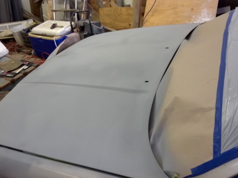

                Prep work continued today. I found out that urethane primer is gonna coat better and mask small imperfections better than the epoxy so I bought a quart of that. Also I found a cheap local painter who is gonna start to spray it next Thursday. He will be using a PPG base coat / and Transtar’s MAX Clearcoat . Car will be at his place for 2-3 days. But he comes highly recommended from professional paint supply place. We are gonna have it primed by tomorrow night. Then take it down to 600... I'm learning and excited to have a clean e30...

                  Started to prime it today...
                  The guy who is supposed to spray it tomorrow is not answering the phone it goes right to voice mail. I may have to find someone else to spray it...
