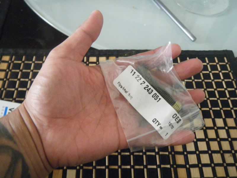

            #50
            All the flywheel bolts were replaced as well. $3.55 each!!
            Changed the driveshaft as well to an e36 m3 and the CSB was changed as well
