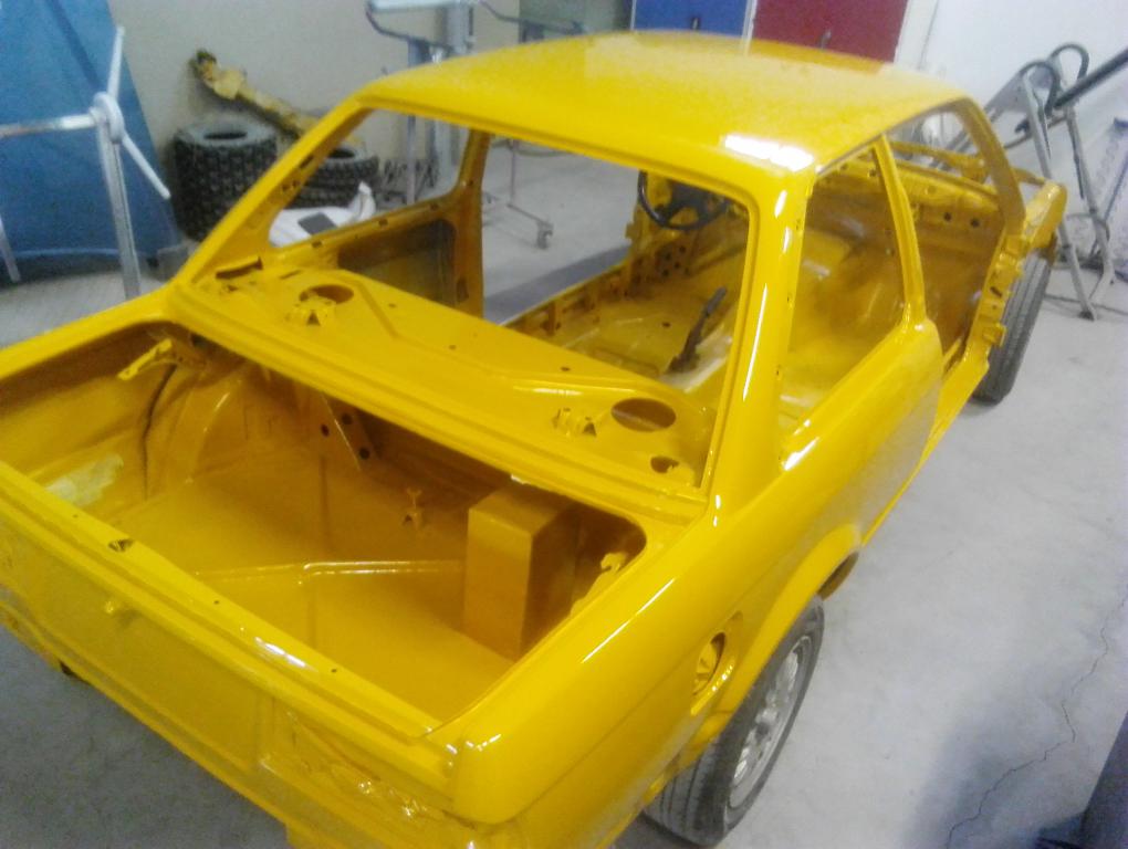

  • petrolhead
    replied
    Better pics later.
    Leave a comment:
  • petrolhead
    replied
    Pic link work OK?
    Leave a comment:
  • Skarpa
    replied
    Looks brilliant!
    Leave a comment:
  • petrolhead
    replied
    Originally posted by Sade
    Wow that color looks epic
    I like it. It's exactly the kind of shade or variation of the color I want. So far only engine bay/interiors were painted, they waited for me to take a look at it and confirm the shade is OK to proceed. While it's not a matte surface, it's only "half shiny" or whatever is the correct term in english. Anyhow, half shiny is just the way I want it.
