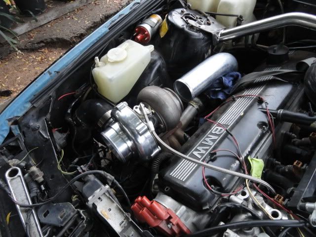

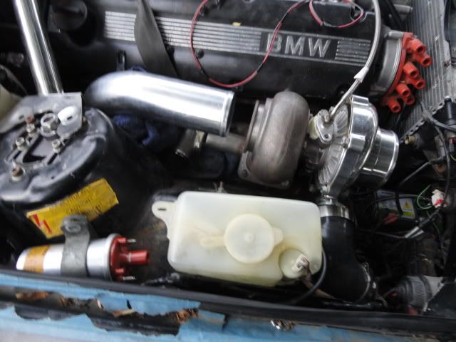

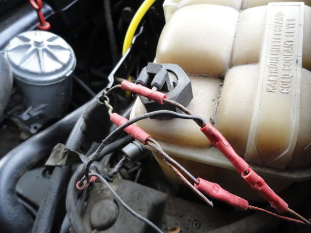

Thanks guys! Installing a e21 wind shield resevoir. I will rap it with some kind of heat shield. So turbo will not melt it. I found some wires I had fix.

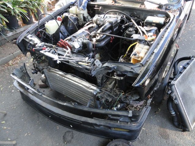

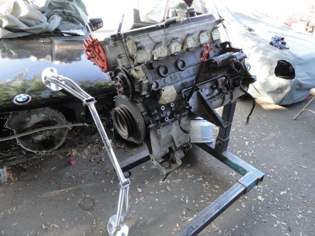

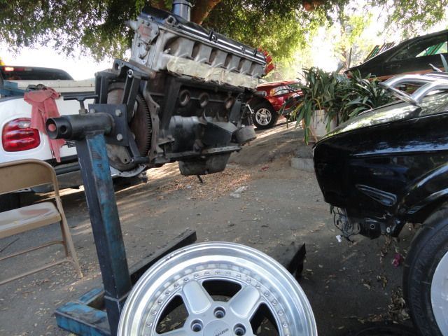

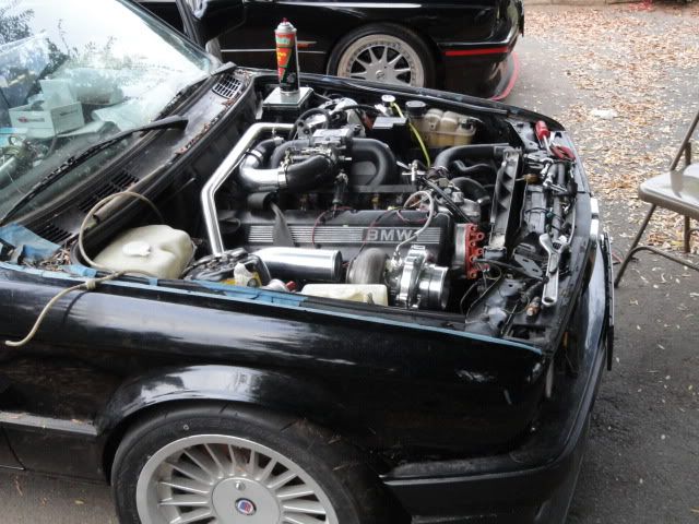

I finally pulled the motor out to rebuild to it. I might have the head ported & polished with 1mm. bigger valves. I want to a 292 cam , custom rods & pistons from Ireland Engineering. I might pull the trigger on this. I have some pics of the engine & bay. I need trim metal in the bay for the turbo manifold.

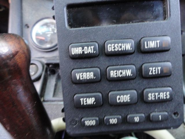

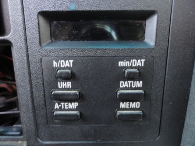

I bought two German obc for my car. I was going use the 13 button obc. Know I can't use it any more because I'm going run mega squirt. I bought a German 6 button.

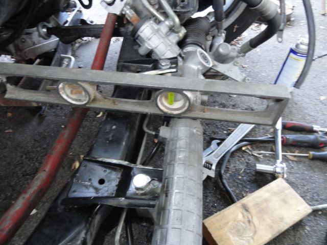

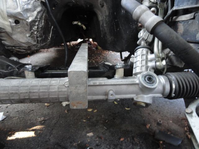

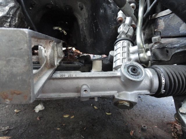

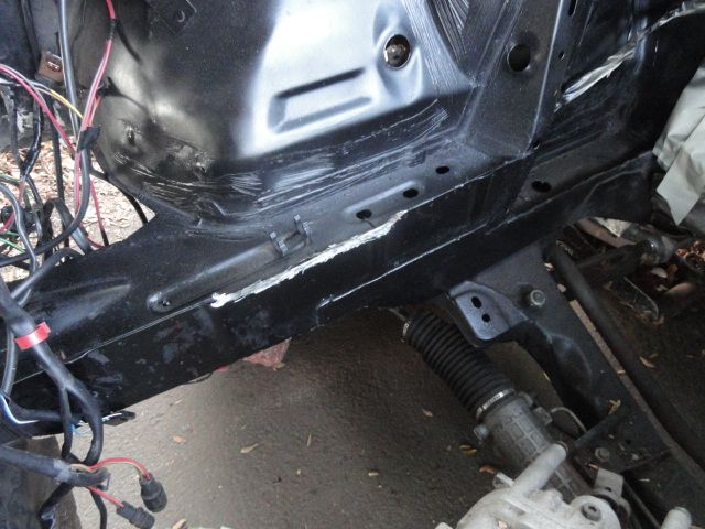

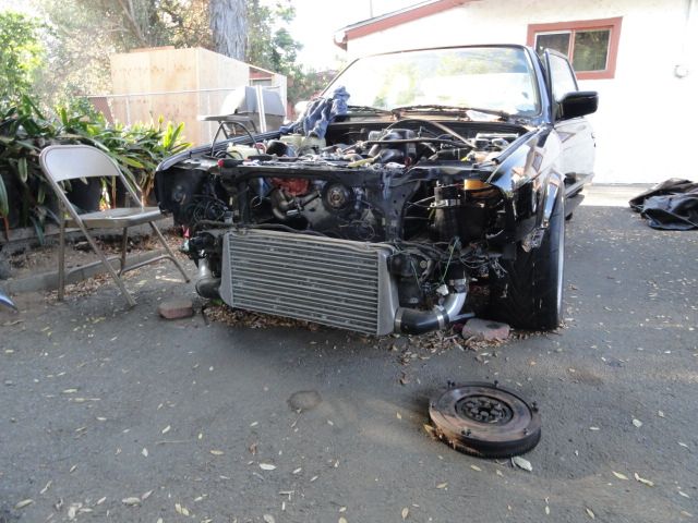

I bought longer bolts for the e36 m3 rack. I want the rack to be level with the sub frame. When I had motor in the car the oil pan was touching the rack. I was using 325 e30 rubber mounts Alpina B6 3.5s metal motor mounts.
Keep bottom end stock, get a nice HG and some head studs and crank the boost. I run the IE 284 cam in my N/A M30 and it brings the powerband up top nicely
I am thinking of keeping the bottom stock. I do want to do head work on it an send it to Ireland Engineering.

Well did get the rack almost level with sub frame. Know I need to extend the steering knuckle.
