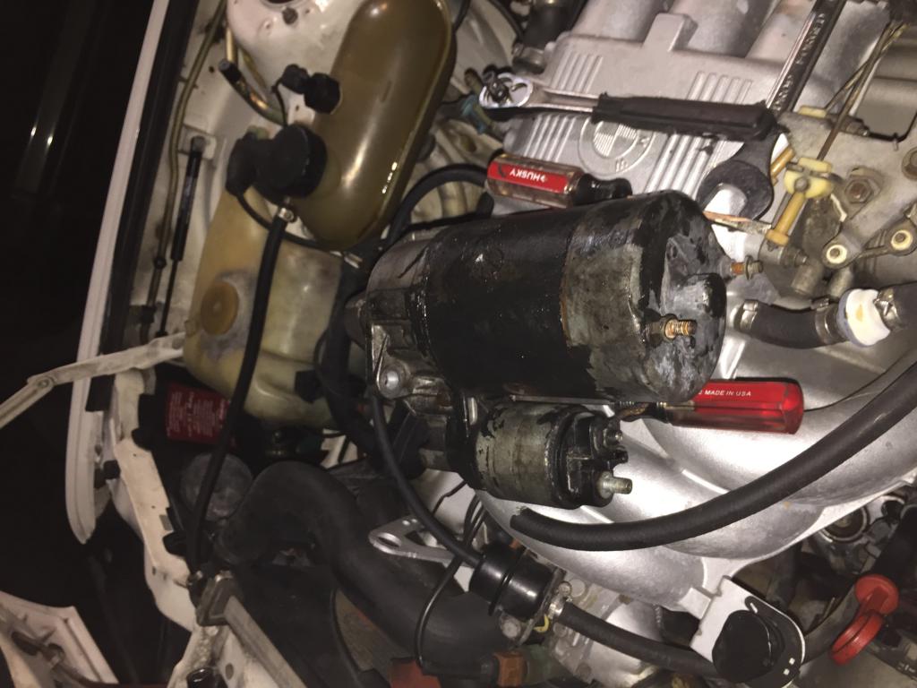

            Starter Failed just a few days ago on the ETA but I was able to get her started by hitting it with a steel pipe I use as a breaker bar. Now I got it all taken apart with the new starter in the garage but I just cant seem to get this dreaded TOP BOLT OFF!!!! Anyone got some ideas or tricks?

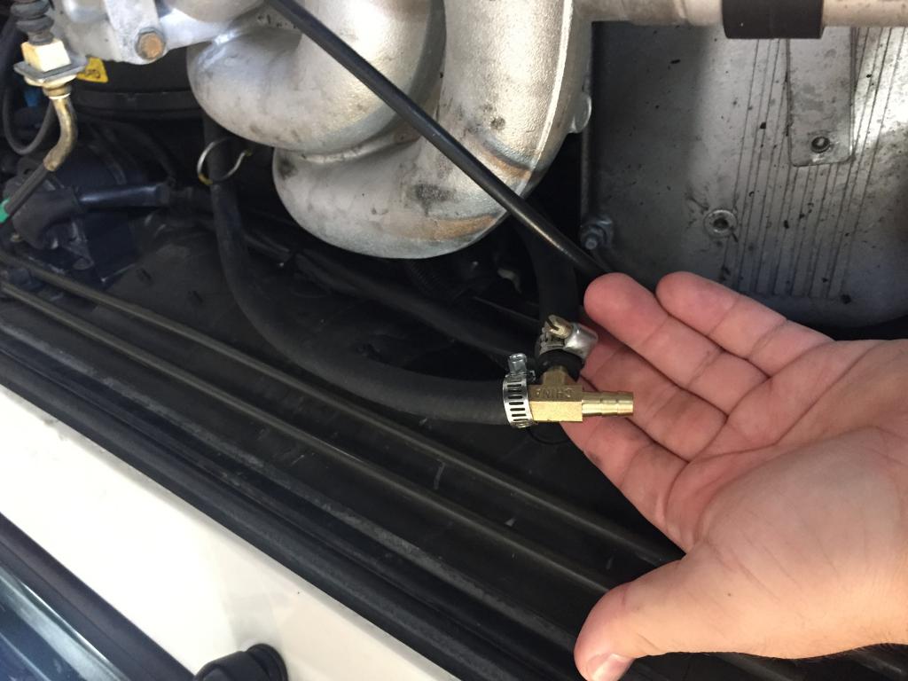

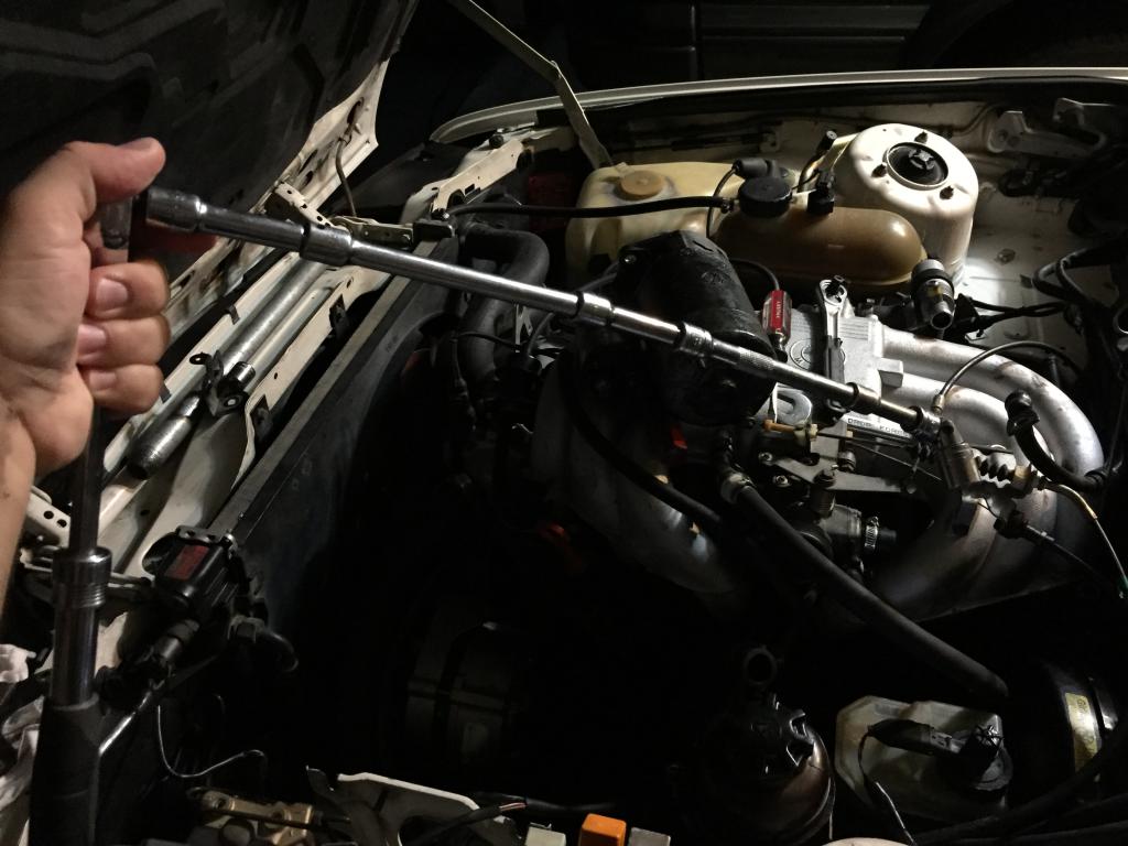

              1/1/2017- Replaced Starter but dang this was tough due to the top bolt. Also flushed the coolant since I lost a good amount out of the heater core line that I had to remove and fold down out of the way.
              New Brass T was added and all top end fuel lines replaced. The old plastic one snapped quick.
              I will also upload a pic of the set up I used to get that bolt off. Hope it helps someone else know what will be needed if you go in from the top without removing the manifold.

                Wow you weren't kidding about that too bolt. Good job man
