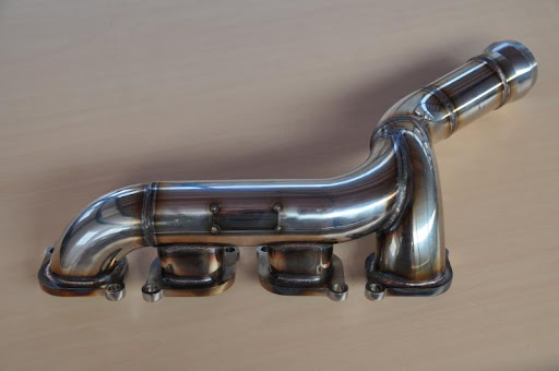

      Consider log-style headers --check out a search on them for some good pics -- piece of cake to clear steering box and linkage.
      We may make some for our next swap. Ignore the flamers who think long-tube headers are the only way to go; you have limited options to run the exhaust and redoing the steering is hard & risky. Good luck get some pics posted

        Yes a log style header will be what I will have to run. A set from an 05 LS2 might fit....I need to do some measuring.
        There is NO way a header will fit. The engine actually is sitting in the car now. I want not able to leave the booster. I had a remote booster from a 540 sitting around so that is in and working out. The shifter comes right up through the console and everything else is clearing, steering, sway bar, etc etc.

          Yes, here's a nice looking log:

            yeah that sure is....that would actually probably fit nicely. Does someone sell that? Is that ls1? seems like getting to the plugs would be tricky....just longer wires and loop around?
