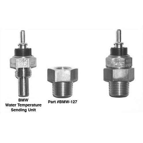

                  • garretvs
                    • 464
                    #84
                    Just for those who are needing to put the GM sensor into the RH cylinder head, and don't have access to a lathe. It is no biggie to re-tap the M12 to M14 ~~ drill out the M12 with a 12.5mm tap drill & re-tap M14x1.5 (you need an M14 tap for the tie rod ends, anyway). Just have a helper hold a vacuum by the tap drill & tap to suck the chips out. Note that you are only drilling the M12 threads and .5mm "new" material. Piece of cake.
                    E30-LS1 aka. 357is
                    email us to pick up our LS1 swap guide
                    E30-LS1 KITS now available!!
                    E30LS1@gmail.com
                    e30ls1.com
                    • Teaguer
                      • Sep 2004
                      • 6167
                      #85
                      There's also this piece available that JTR offers:
                      Using the BMW water temperature sending unit in the Chevrolet engine will make the BMW water temperature gauge read accurately. The BMW water temperature sending unit has a 14mm x 1.5 thread. Stealth Conversions has a brass adapter (shown above) that accepts the BMW water temperature sending unit, and has a 3/8 pipe th
                      $22 shipped. No drilling, no tapping and no lathe. :D
                      • jakeb
                        • 1909
                        #86
                        I wish that adapter from JTR would just work...but that is for the old style GM engines. It goes from m14 to 1/2 NPT I believe.

                        • garretvs
                          • 464
                          #87
                          You're doing good work on your swap -- just go for the drill & tap routine. We did ours in a couple minutes with a hand drill. We had to buy a 12.5mm drill and M14x1.5 tap; cost us about $25.
                          E30-LS1 aka. 357is
                          E30LS1@gmail.com
                          e30ls1.com
                          • jakeb
                            • 1909
                            #88
                            I already retreaded the sensor so I am good to go.
