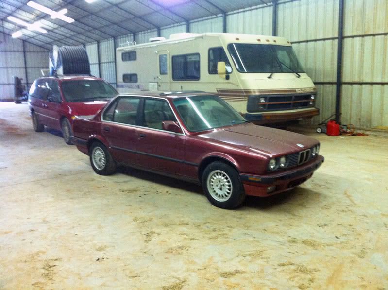

    I present my 1990 bmw 325i that I found listed on craigslist for $600. I hesitated and watched the listing for a couple of days. It dropped to $400 and that was just too cheap to pass up.
    Overall, the car is fairly sound. Strong motor and transmission, the body panels are all straight except the drivers door and part of the fender. Unfortunately the paint on the car was completely shot. Definitely needed a repaint
    When I bought it, the owner told me that the master cylinder was bad and there wasn't one in the car. He showed me 3 used (presumably broken) master cylinders in the trunk and there was a new one in a box. Since we thought it had no master cylinder (wouldn't go into gear), we towed the car home. Yes I could have driven it with no clutch but there were no brakes (no brake fluid). But to our surprise, there was already a good master cylinder in place and the car was just low on brake fluid. Topped it off and the car and the clutch feel great. Owner fail
    The front shocks need to be replaced, some shift linkage parts, a new tire among other small items. The car sat outside for nearly a year (with gas in the tank) so we are worried that the gas tank might have rust in it. (it actually does have rust in it, fack)

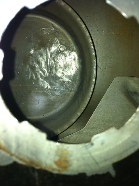

              We tore into the motor. Replaced the timing belt (which we discovered was alright), waterpump, valve cover gasket and other little pieces. Still need to tear into the fuel tank.

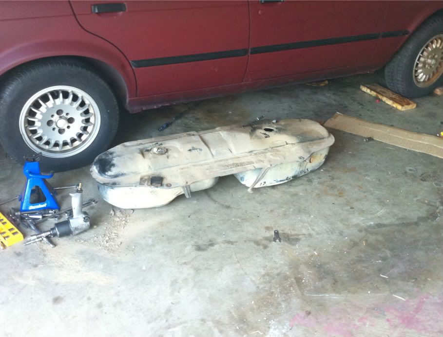

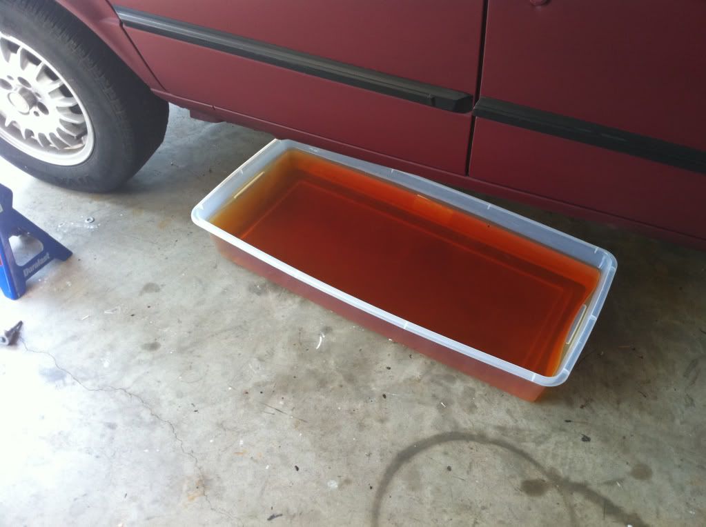

                      Drained the fuel tank... wow. The tank was toast so it had to come out.
                      had to remove the heat shields, driveshaft and stupid fuel lines that pour fuel everywhere. Finally got it out though!
                      new fuel tank. $75 and rust free!

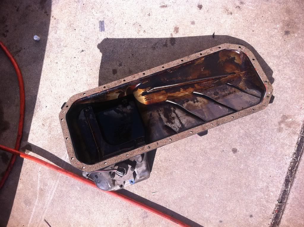

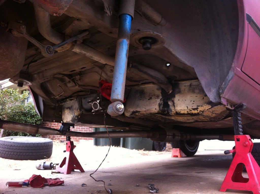

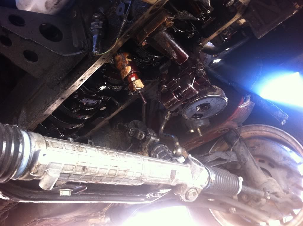

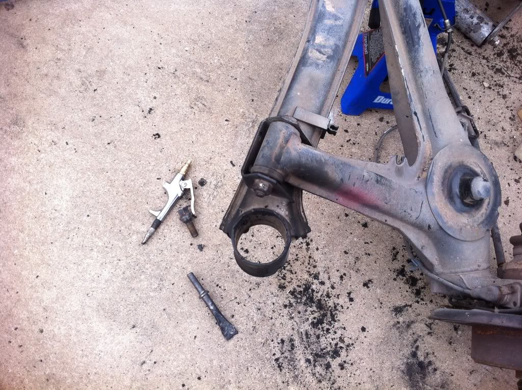

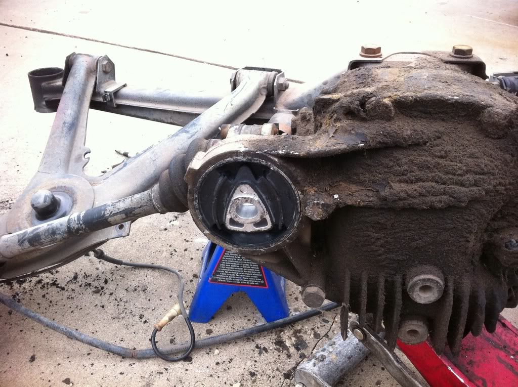

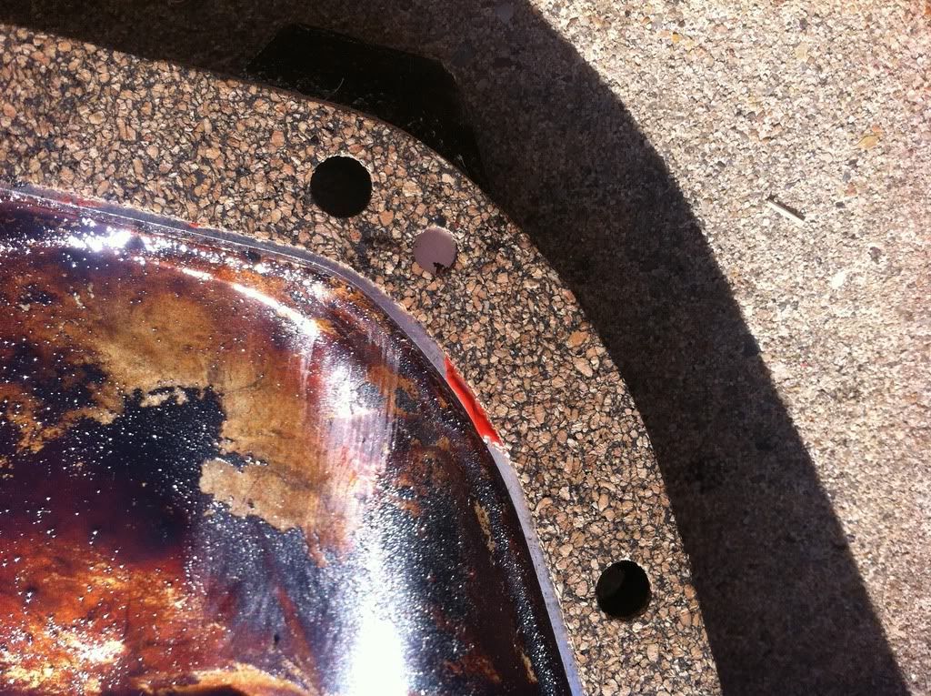

                          Diff bushings, subframe bushings, oil housing gasket and oil pan gasket. What a pain.
                          Pulled the entire rear subframe out.
                          Torches to burn the bushings out and wood clamps to put them back in
                          The underside of this car is absolutely filthy.
                          Cork gasket, new to me.

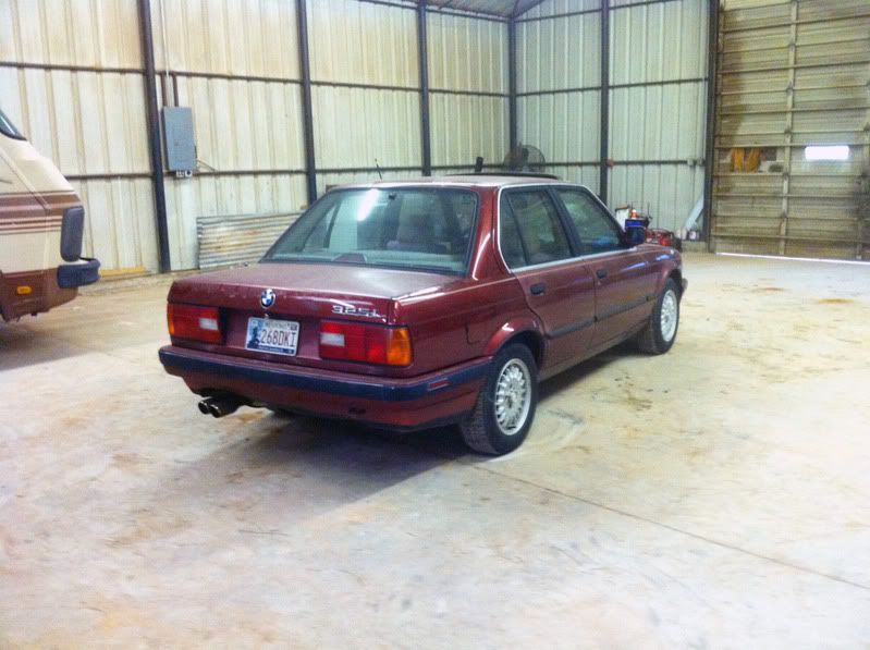

                          Replaced the front bumper and repainted it. I've replaced the front valence which was bent and put the stock lip on it.
                          This is how she currently sits:
