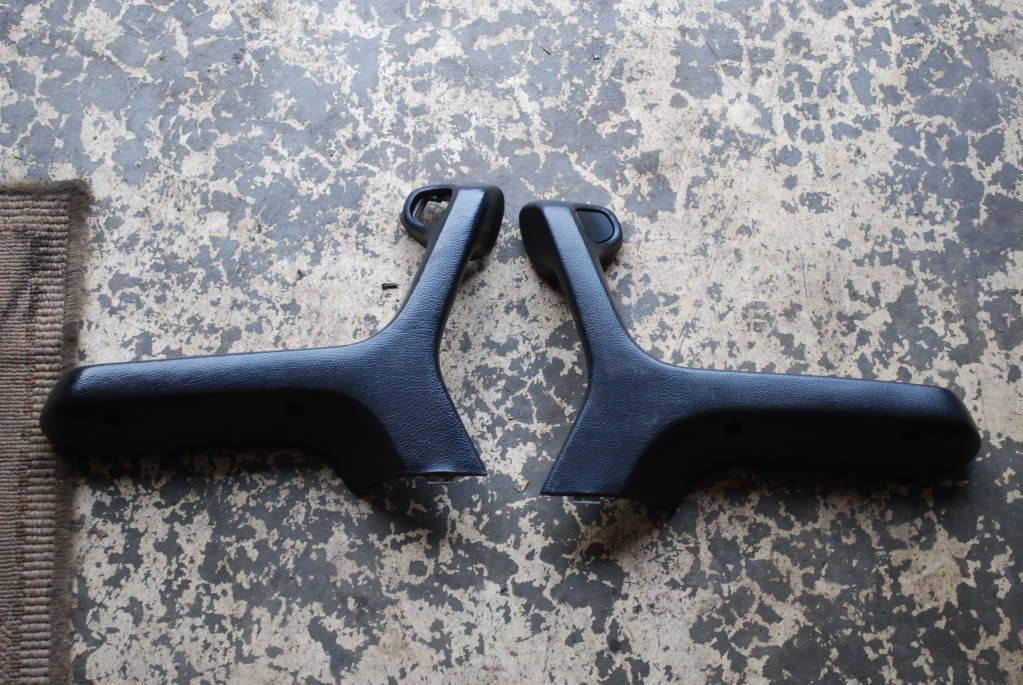

      First off, before and after pics of the arm rests that got modified. I'll probably end up cutting more, depending on how the cage is done.
      Before:
      After:

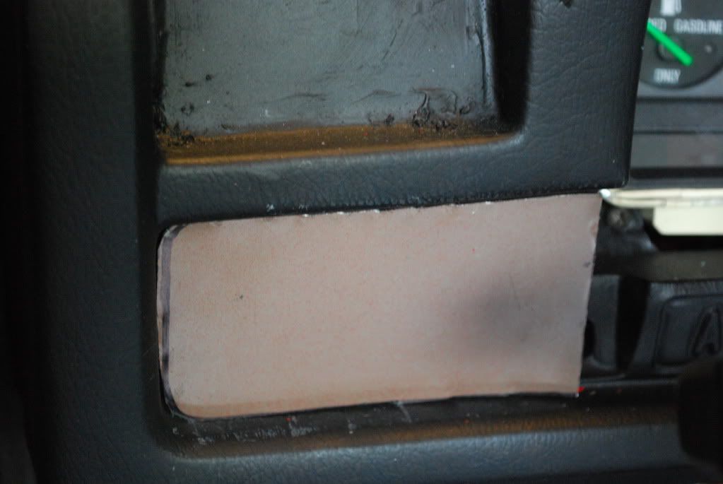

      Than cut out the light switch blank, as I'll be running a simplified controller.

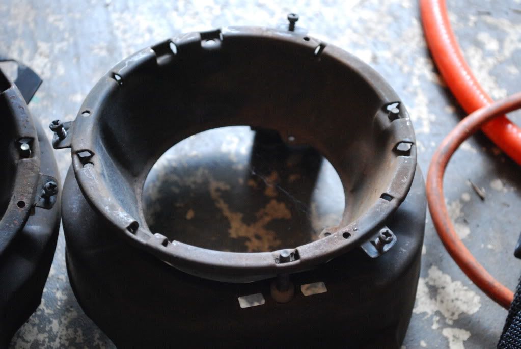

      Then decided to freshen up the light brackets, since they were worn and rusty.
      Before:
      After:

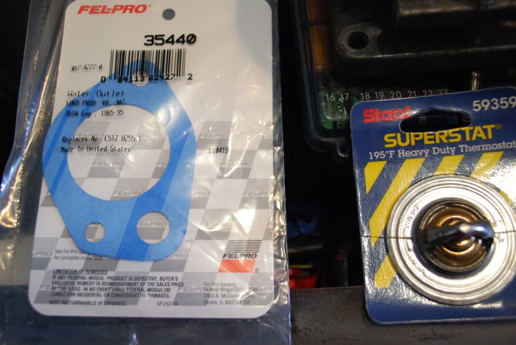

      Thermostat time. The new thermostat and gasket(Interesting, huh? :rofl )

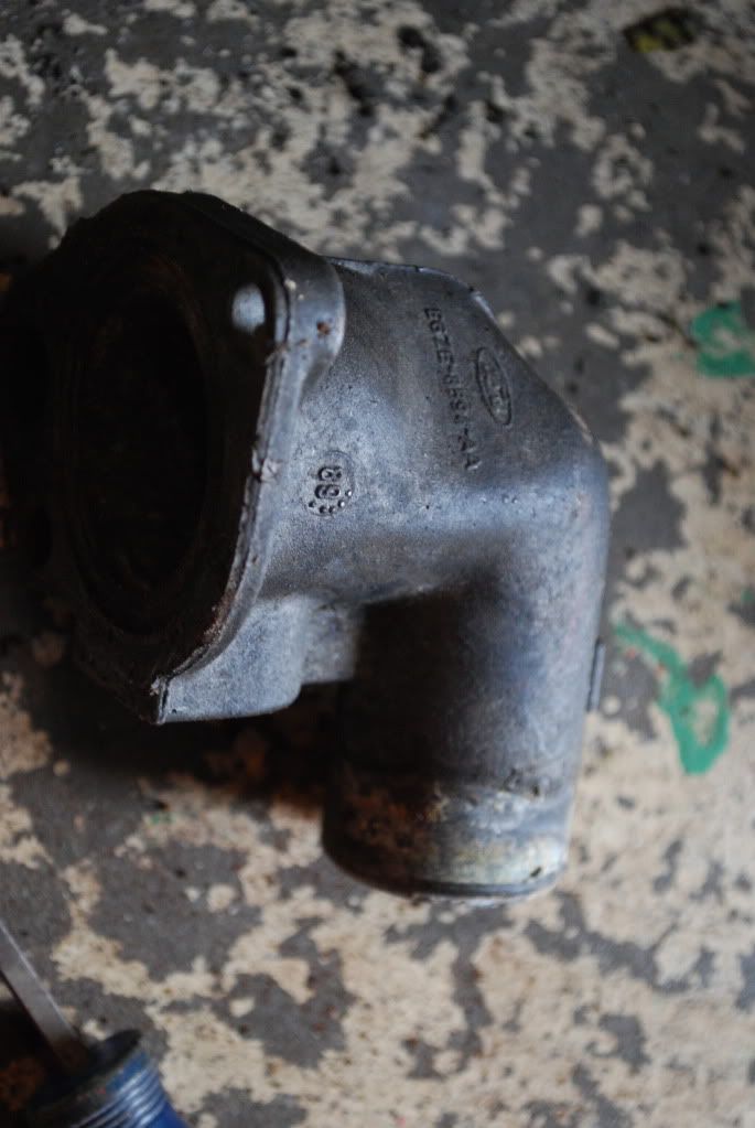

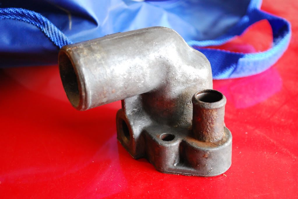

      But before that, I needed to get the deposits out of the water neck, and decided to clean it up and paint it with some high heat satin black spray paint I had lying around.
      Before:
      After cleaning, then painting.

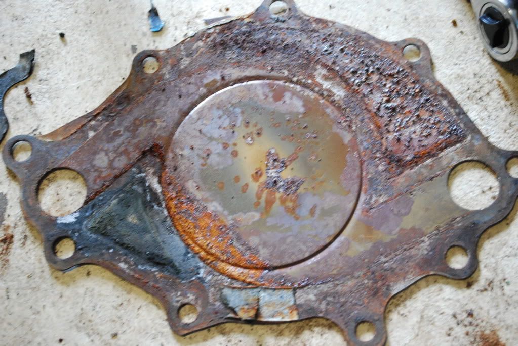

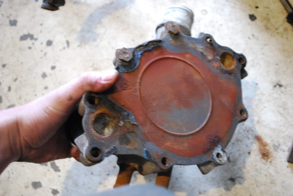

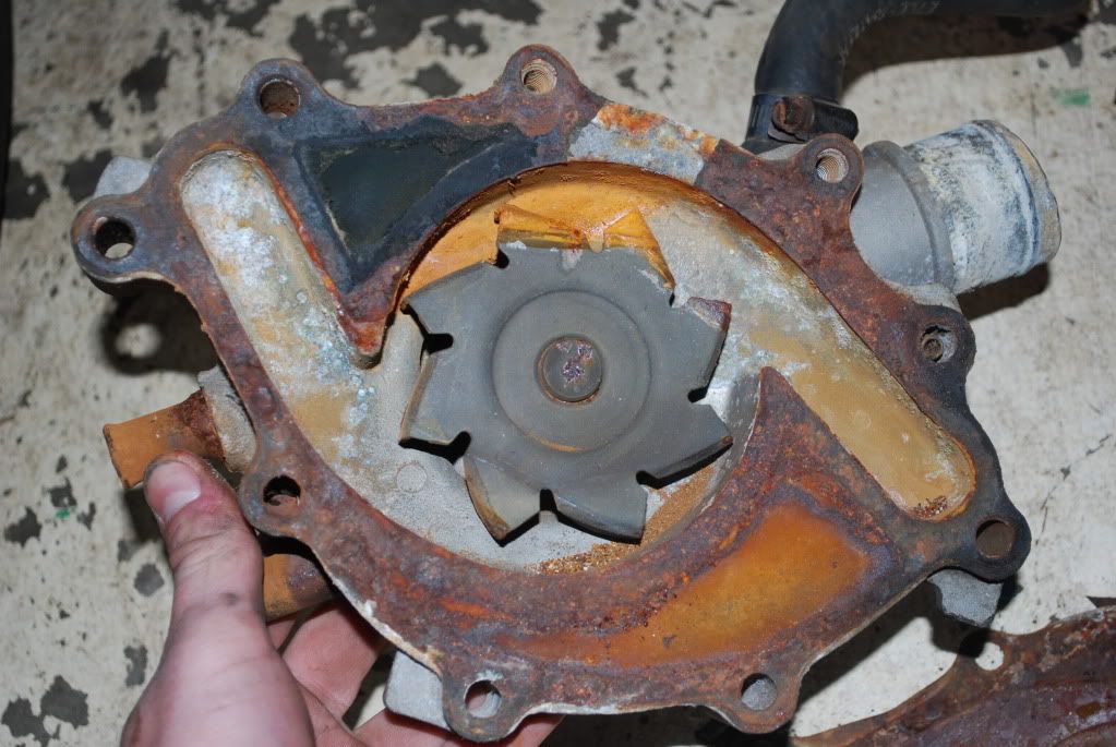

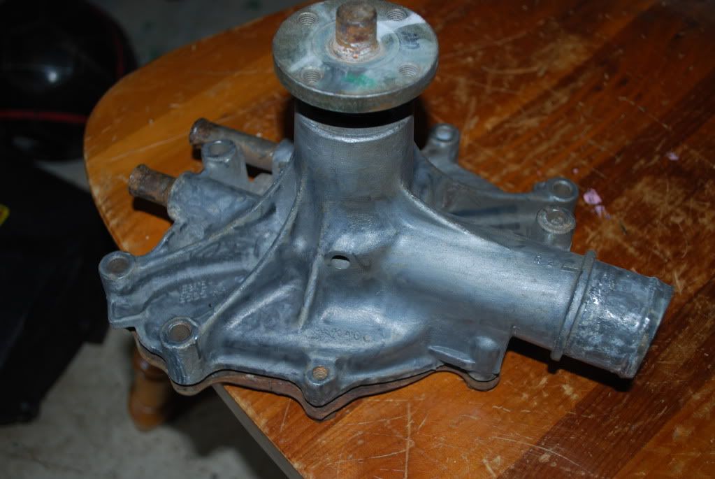

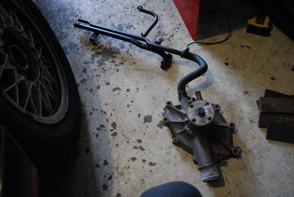

      Now time to check out the water pump, to see if I needed a new one, or just new gaskets.
      Off the car...
      Apart from the misc tubes,
      Rust -_- Not a good sign, but lets open up the guys of it.
      Opened...
      After some wire wheel and Dremel action,

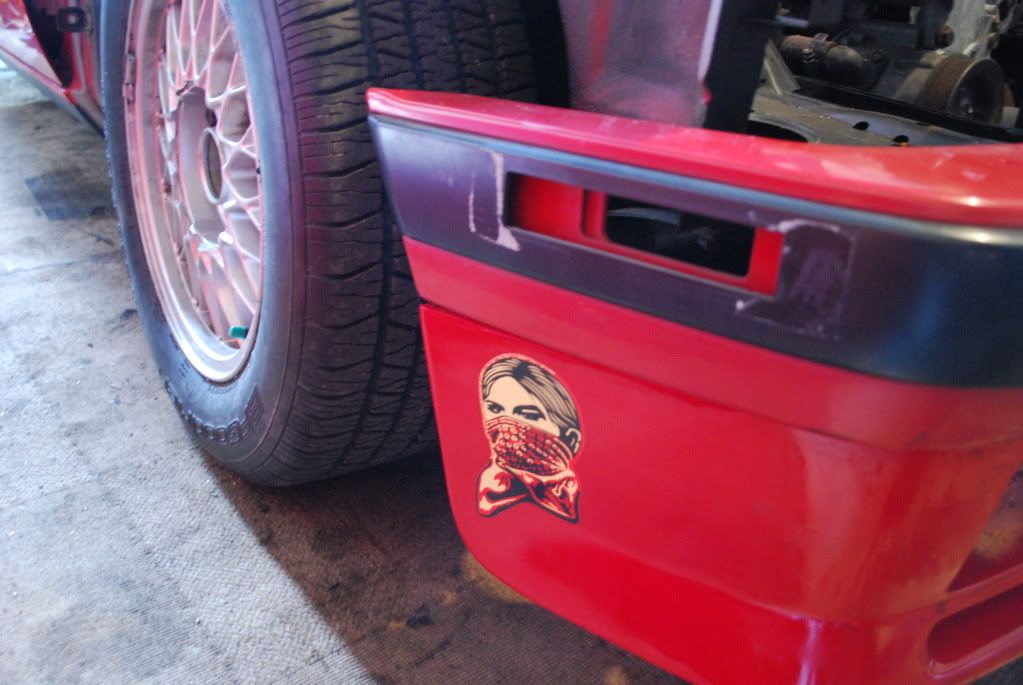

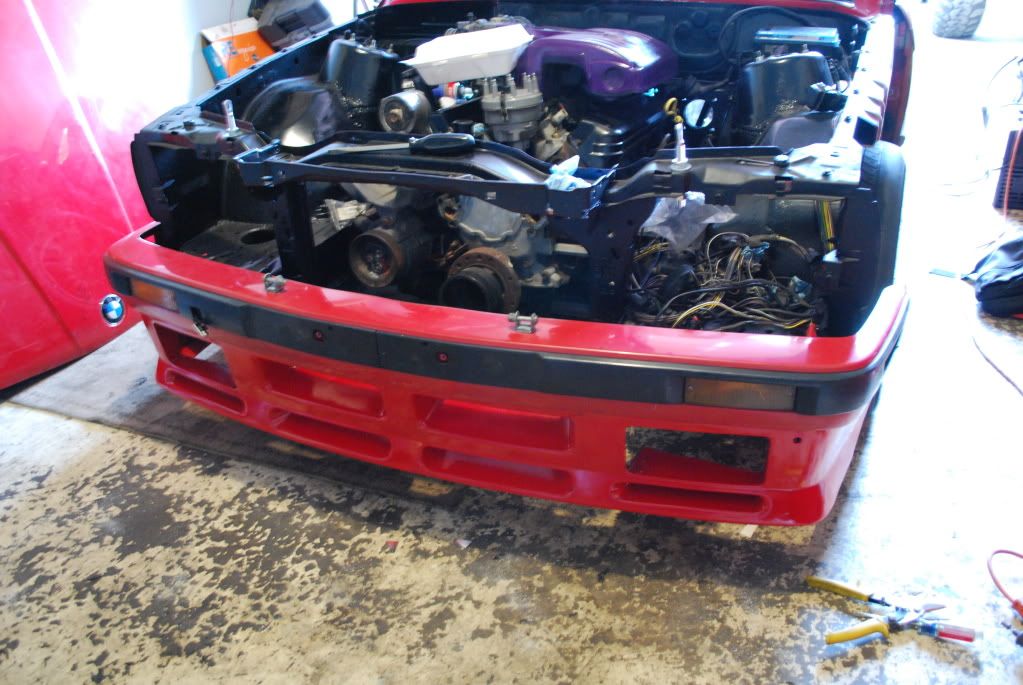

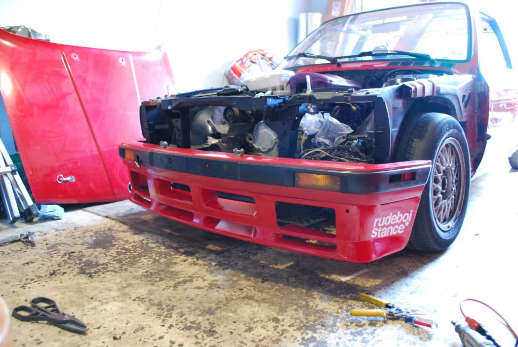

        Next up was mounting the es lip/ valance to the late model front bumper.
        Simply held it in position with locking pliers, then drilled through and use lots of tough zip ties.

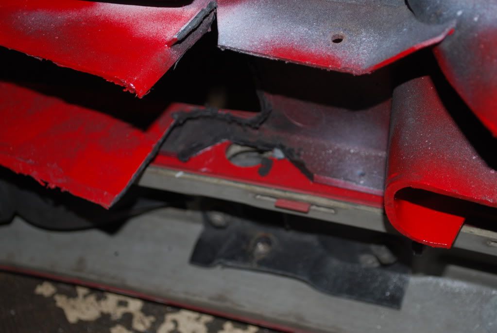

        Then to fix the problem I realized yesterday that I would have, not being about to get the bumper bolts in. simply buster out the shears and Dremel then went to town.
        Pretty please with how well lined up on the sides I got it.
        And test fit(ignore the weird and ugly angle the whole bumper is at, the side adjusters aren't on, obviously.

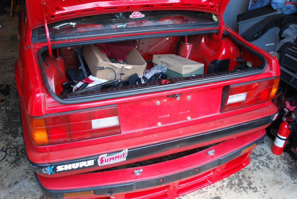

        Got the lights and trunk back on,

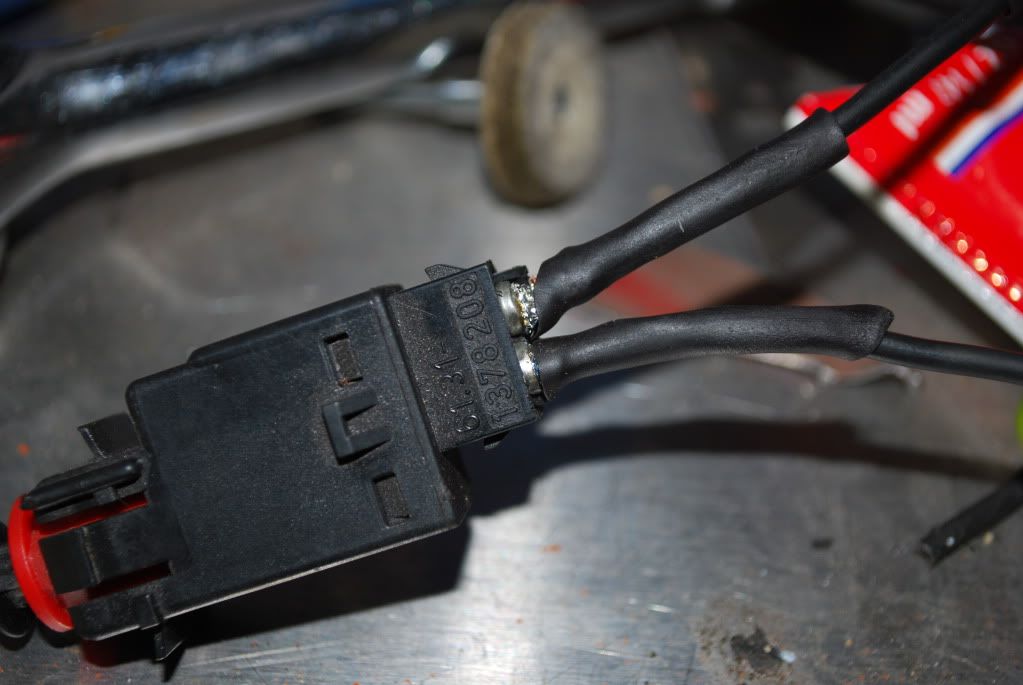

        Last little project of the day, my allergies were absolutely killing me at this point. At some point during taking the dash/ pedals out, I broke the pins on the brake switch(that triggers the brake lights). So I soldered them up, shrink wrapped over and put some pinch adapters on the end,

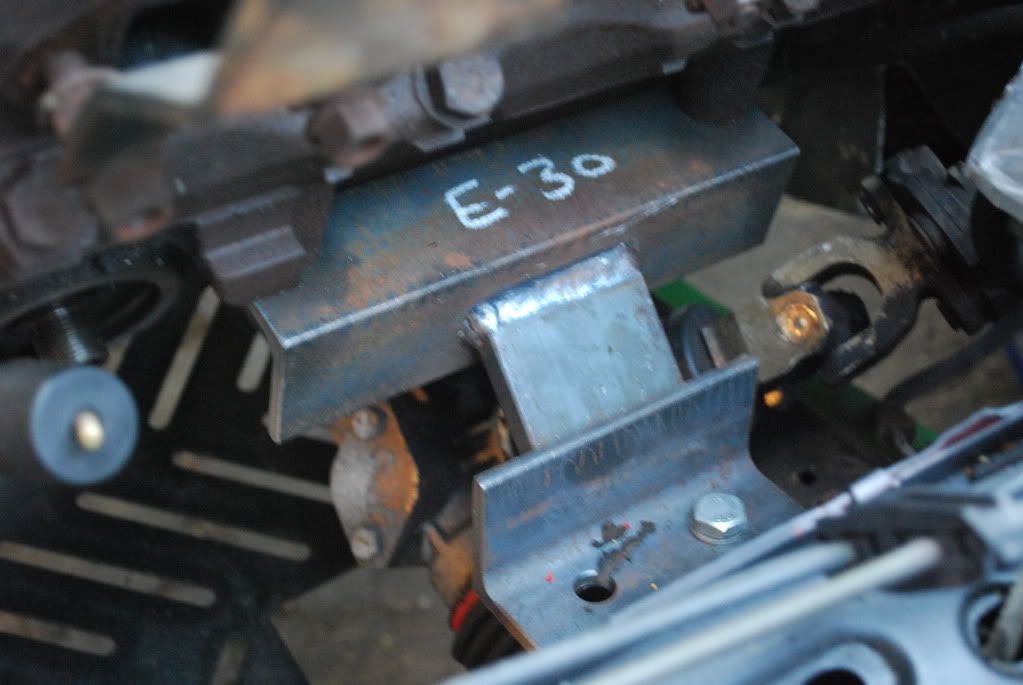

          Time to tackle the throttle pedal, because of where I needed to mount it, I had to extend the length of the pedal to match the brake and clutch pedals. I also wanted a better pedal that the 1/2" wide mustang one, so out came the grinder!
          And after welding and paint:

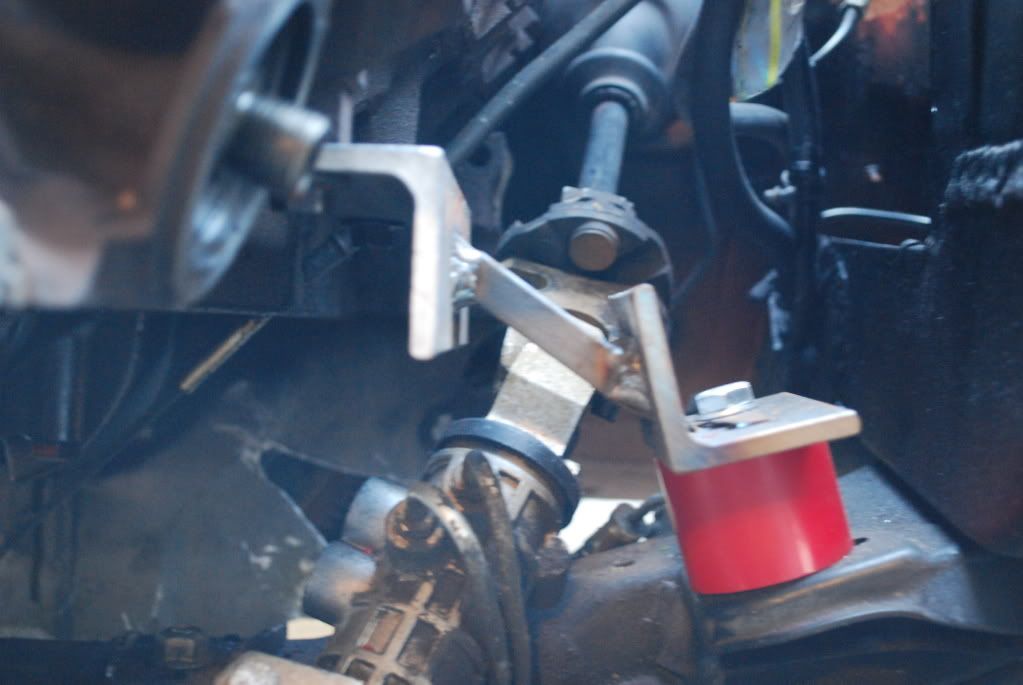

          Another random issue I needed to tackle was the fact that my sway bar linkage was binding from being so low. So to solve this, I simply shortened the links. No pics from after welding, but heres a comparison on the 2 lengths.

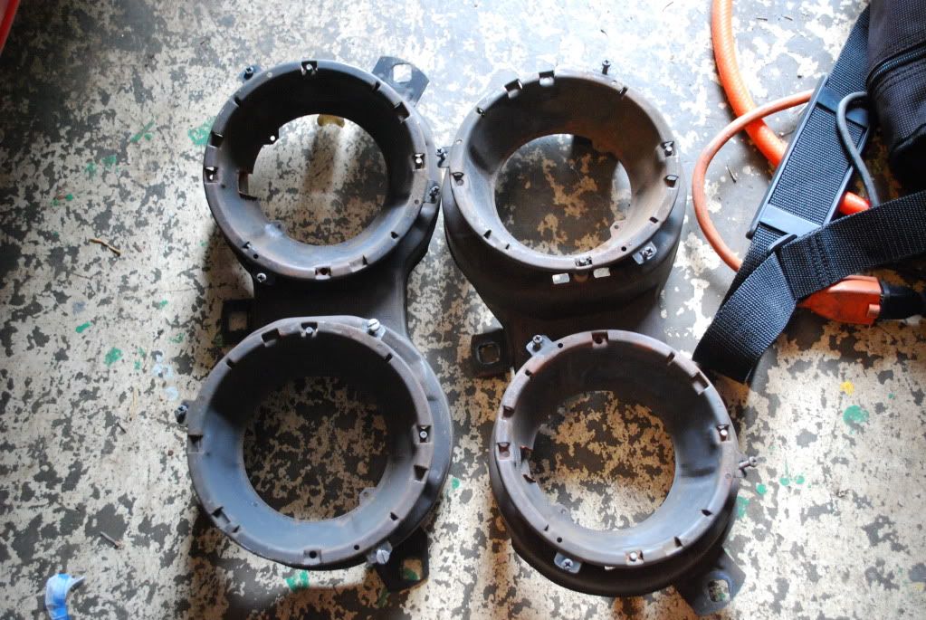

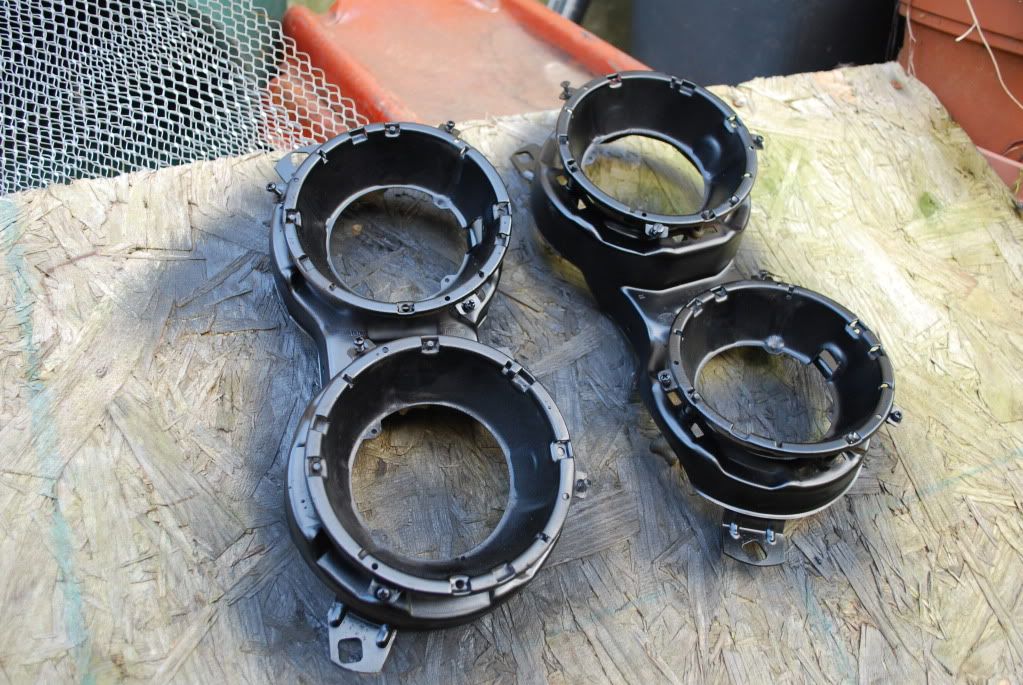

          Next, decided to put the headlights back together.
          Laid out.
          And assembled.

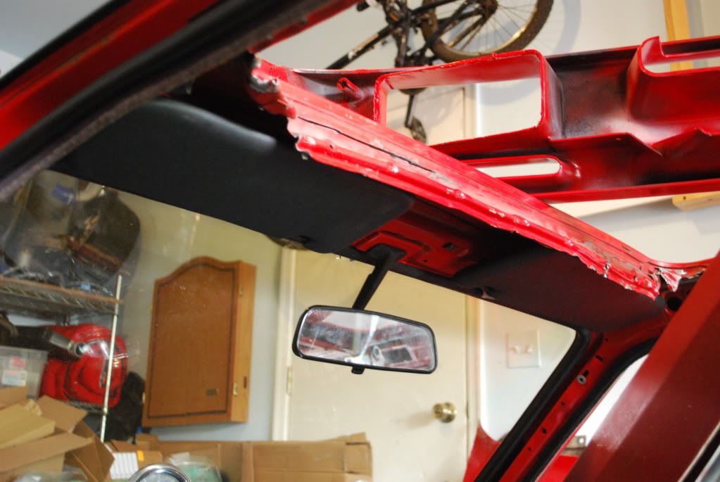

          Now since I was chopping out the sliders/ brackets for the sunroof that run along the whole of the roof, I needed something to cover it with. So I decided to guy the sunroof, which turned out to be the source of some of the ONLY rust on the car. And here was a lot.
          I cleaned it up with a grinder some, but thats all the pics for now.
