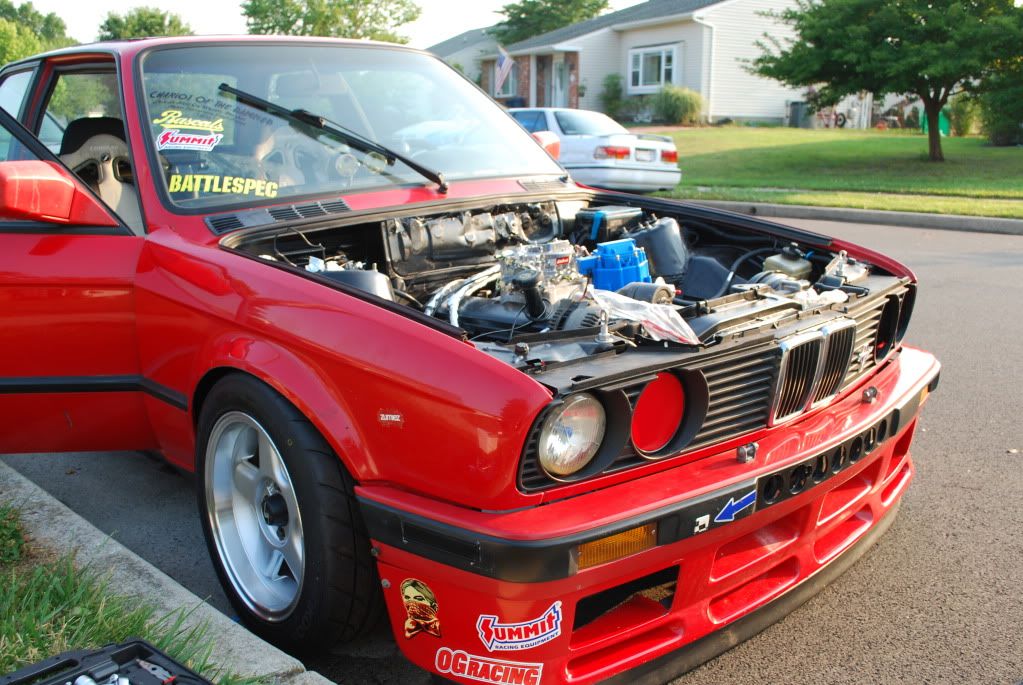

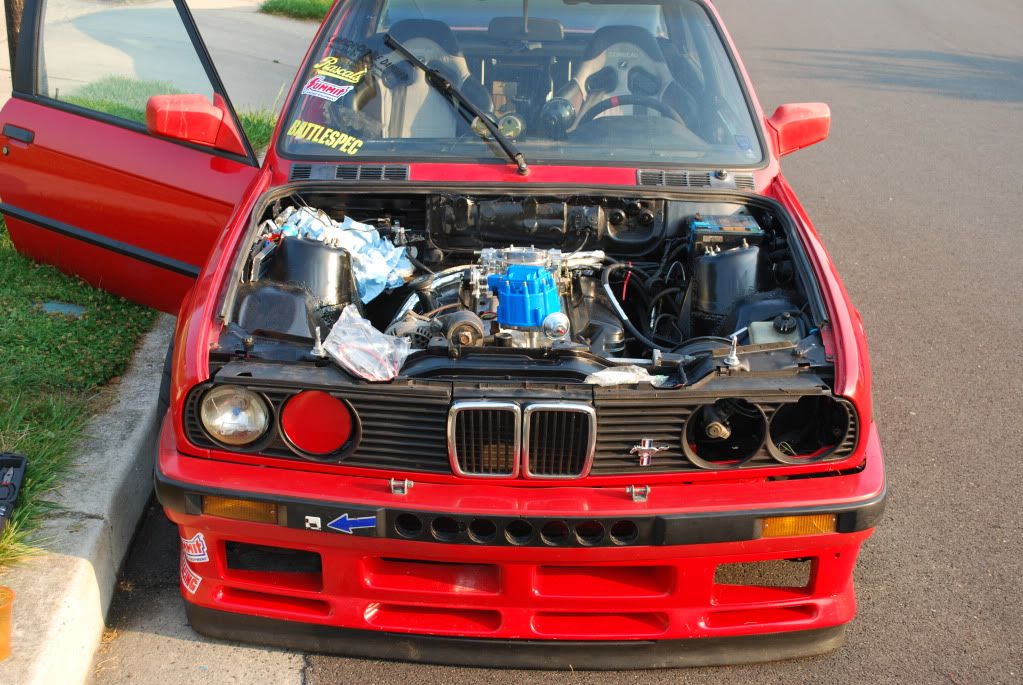

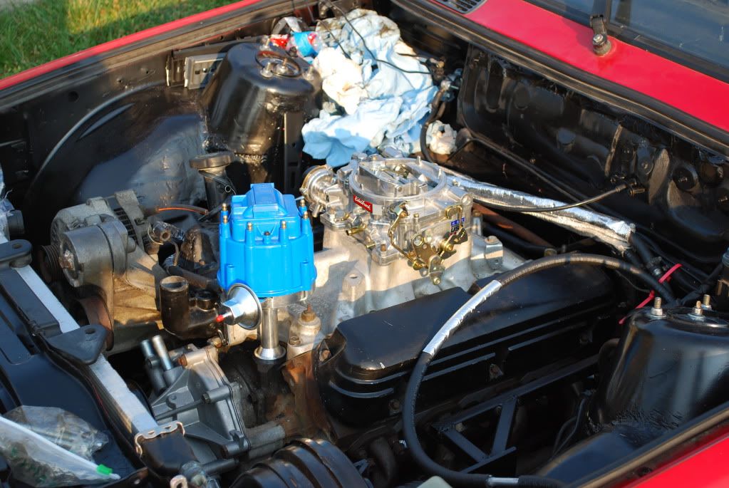

        So a few little updates.
        Firstly a better pic of my ghetto kick panel(works wonderfully by the way!
        Oh, a big box!
        My millionth sheet of Summit stickers...

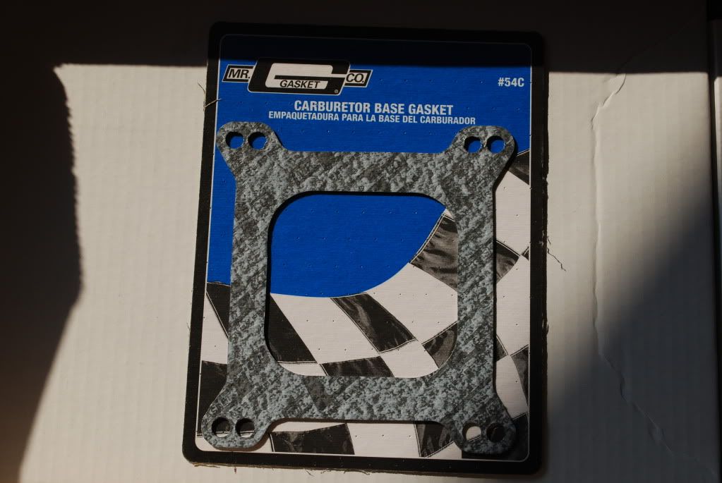

        Gasket for the carb.

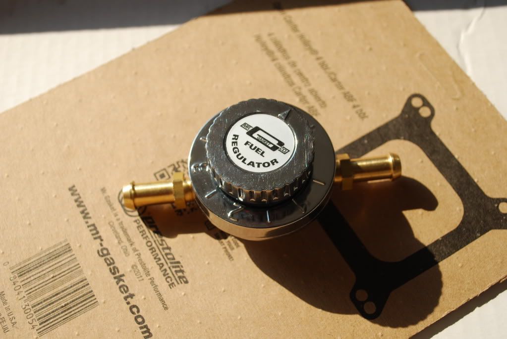

        Fuel pressure regulator.
        Inline filler line.
        Another big box?

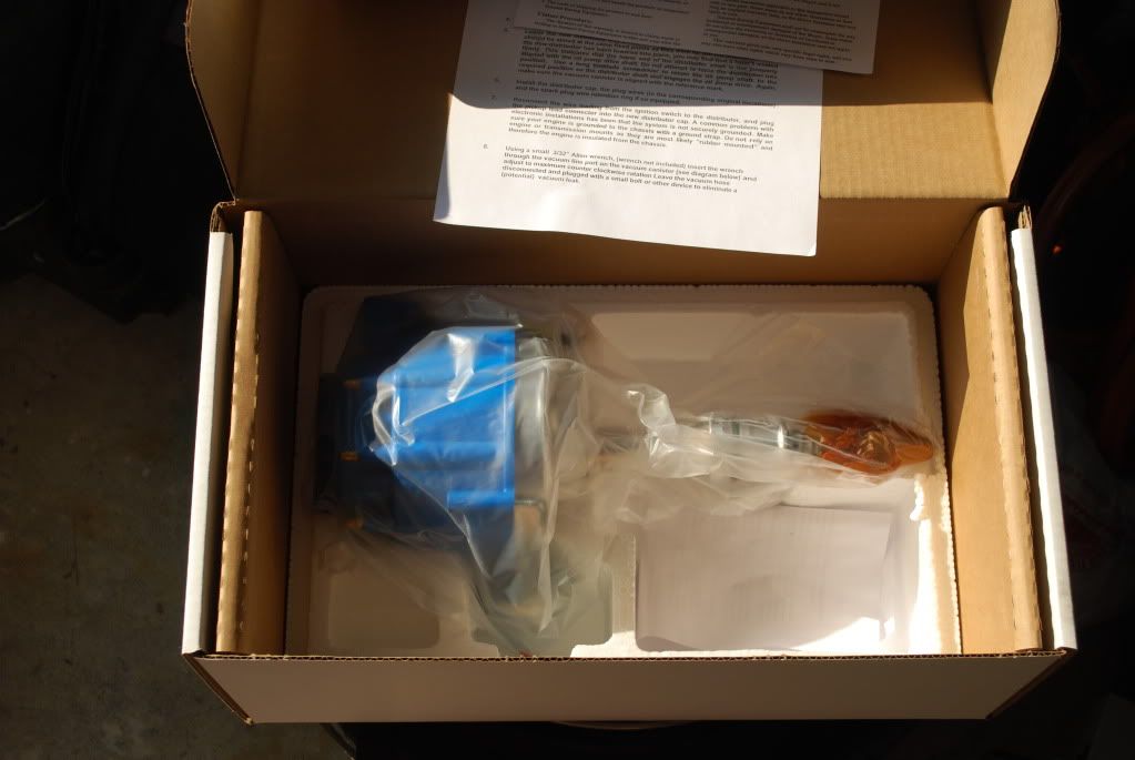

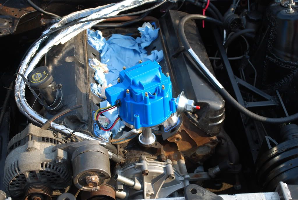

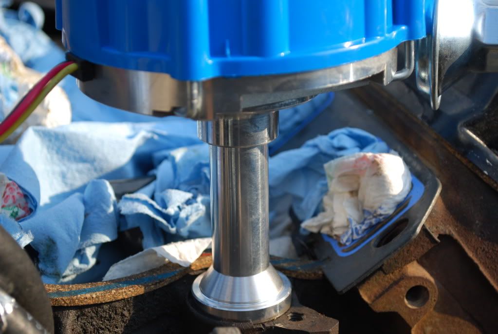

        New, blueprinted HEI dizzy. Could have sworn I ordered red...

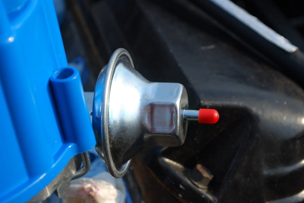

        Vacuum line advance bit.
        Thats all for now!
        (peak dat camber.

                  • 7919
                  #428
                  Nice work. Throw that regulator in the trash right now and save yourself a world of pain... Holley makes a decent carb (low pressure) reg for not much $$.
                    Really? I heard it was decent. I just don't have the money for a better one, and those were all $150+
                      All the round chrome ones are shit, i have personally thrown 3 in the dumpster.
                      Here is the holley one, cheap and good.
                        http://www.holley.com/12-804.asp
                        Damn, I'll look into that and see if they have one with high enough psi. Thanks!

                          #432
                          They have similar regs for many psi. Your chrome one only goes to 7 or 9 so i figured you were carbed.
                            Yes sir, thanks again. Couldn't find any cheap ones.

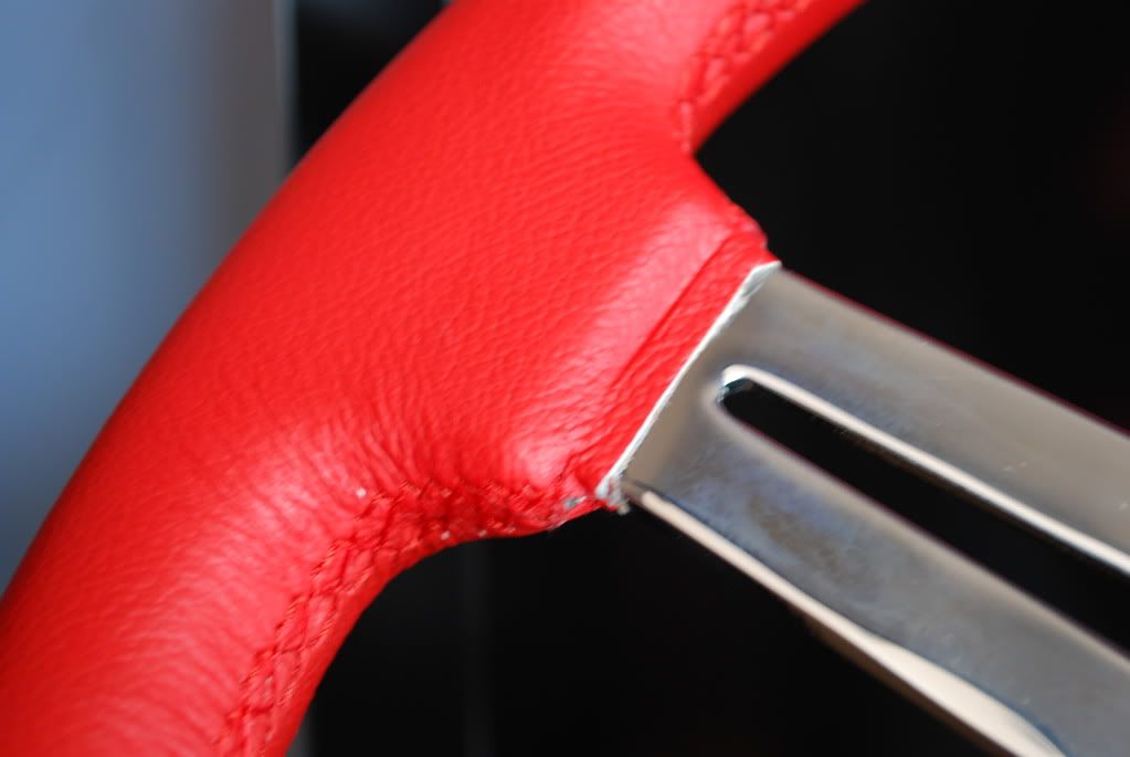

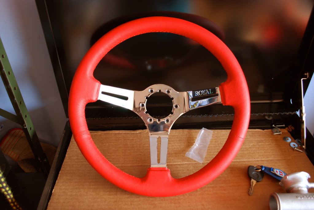

                              Well, finally got my Grip Royal steering wheel, NRG adapter and 2.5 quick release(no pics of the quick release or adapter, I'll grab some tomorrow).
                              Found a cap that fit my inline filler.

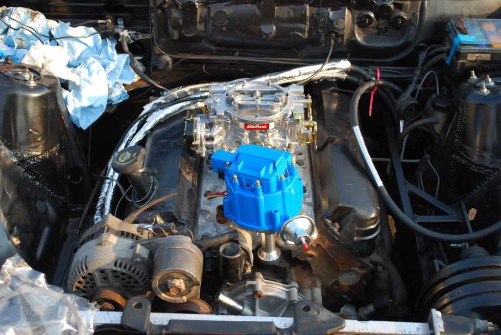

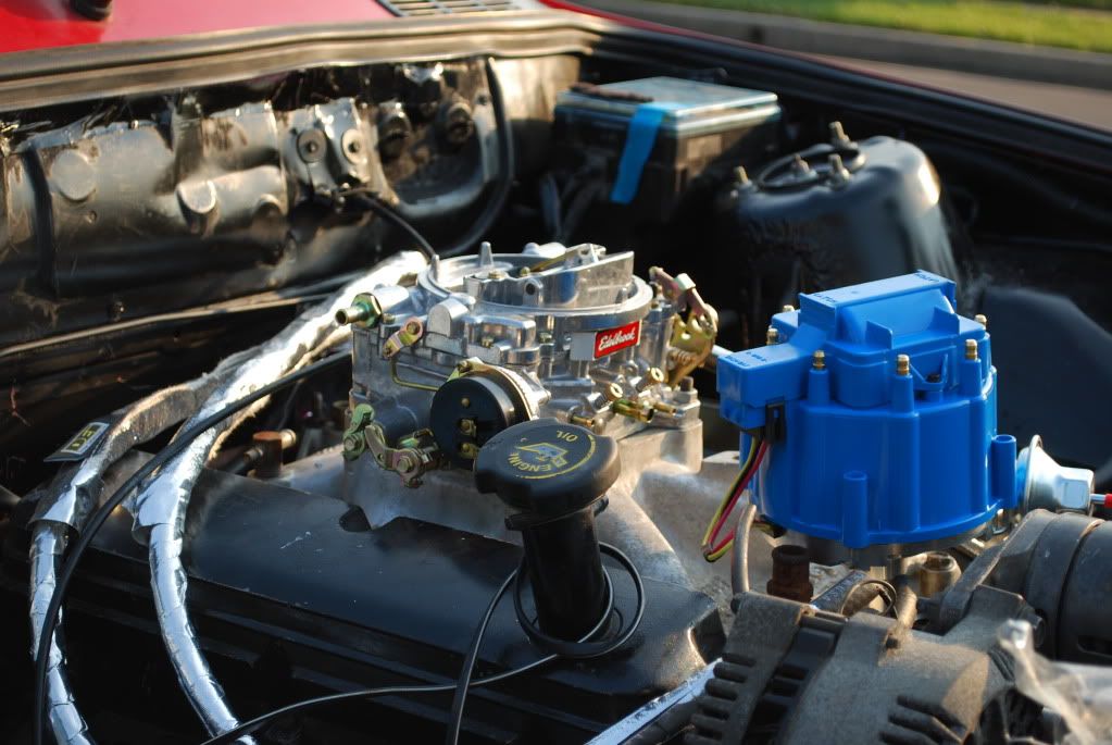

                              And most importantly, picked up my brand new carb and used intake mani. Just looks so right, but so wrong at the same time :)

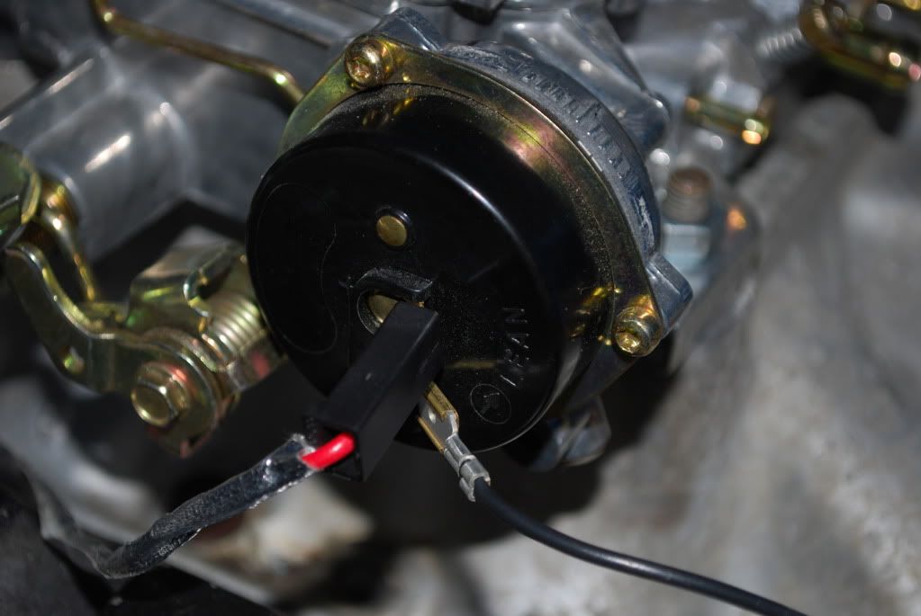

                              Wiring for the electric choke.
                              Changed my stickers up.
                              Thats it for today, but big updates this weekend.

                                Whats your opinion on the Grip Royal wheel? Thinking about picking one up..
