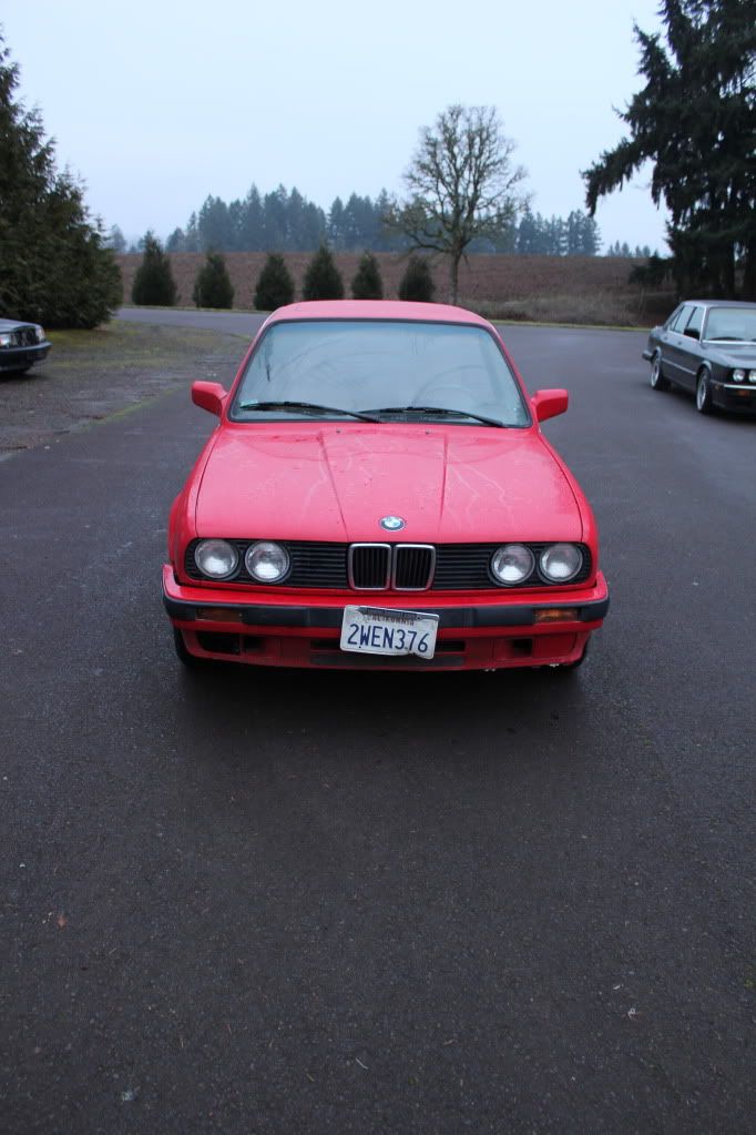

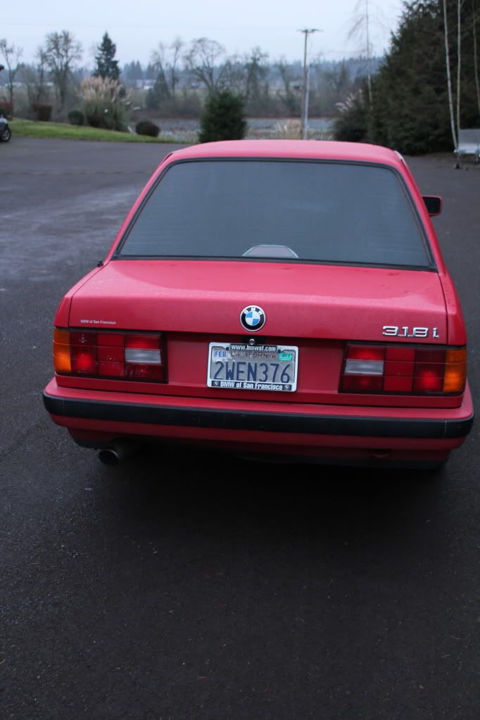

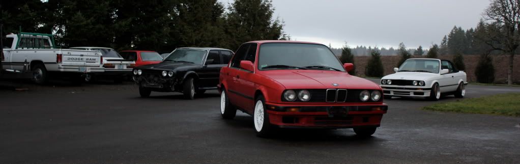

    Now, the new car. Another '91 318i with 150k and a blown head gasket. While this one still needs some work in the looks department, it has a clean vinyl interior, a lot less miles, and a stack of maintenance records. Also been a Cali car it's whole life until the current owner moved up here.

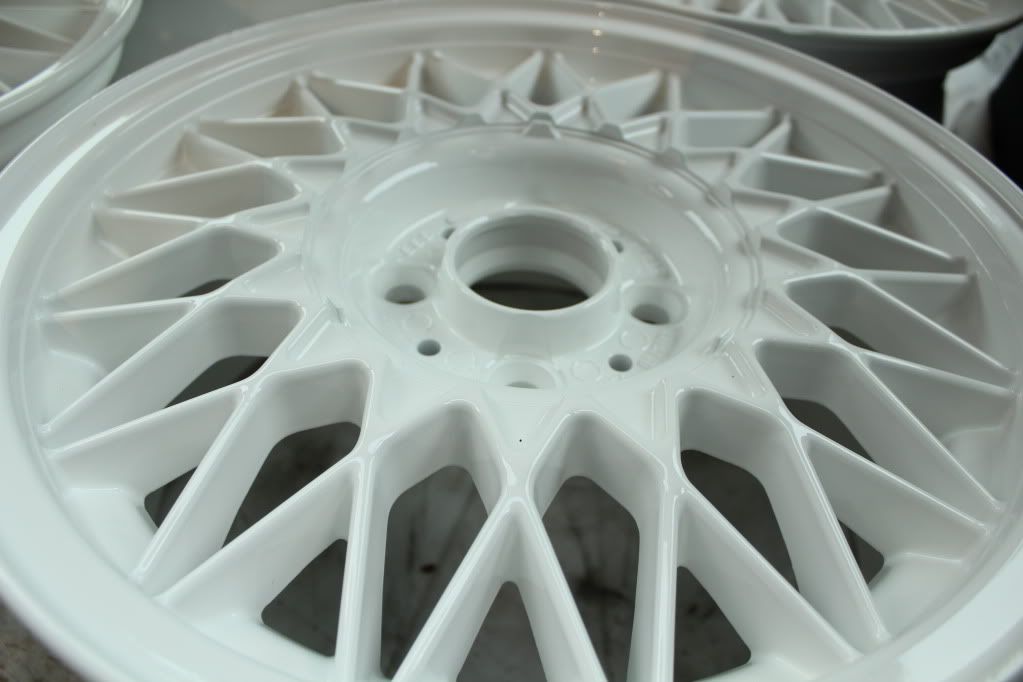

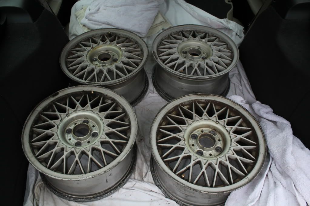

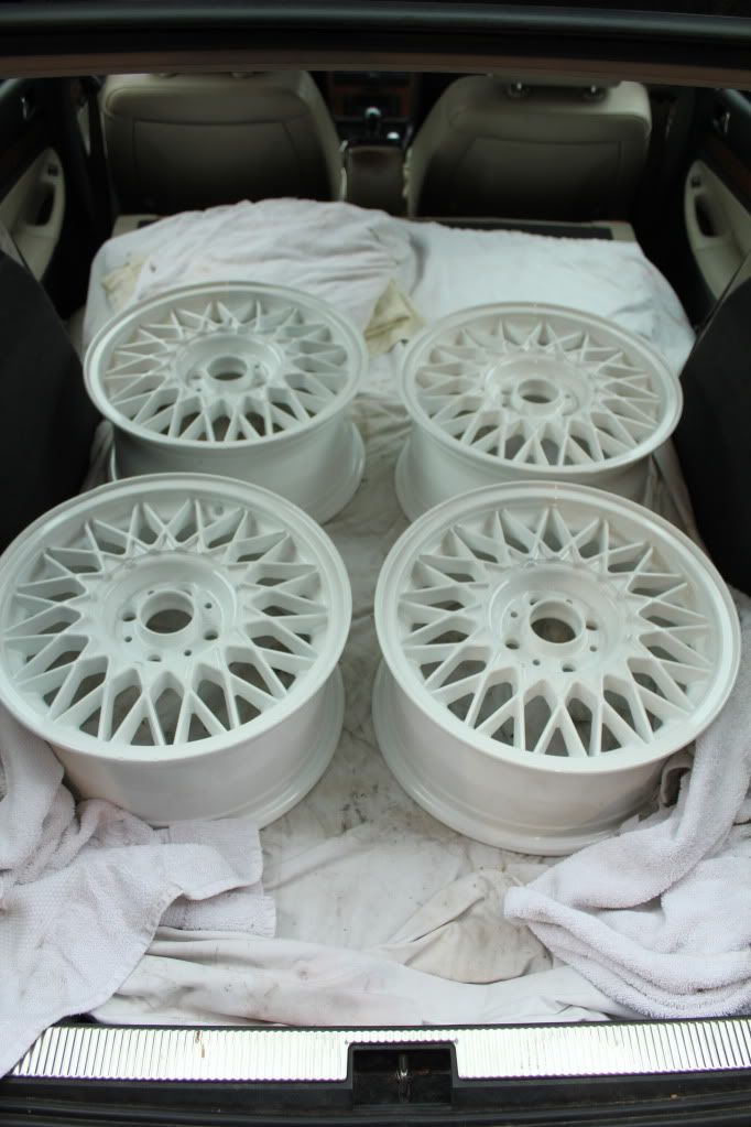

    First I dropped a set of wheels of at the powder coater. These were some iX weaves that came off one of my parts cars that definitely needed a new lease on life.
    They came back looking amazing. I am so stoked to have a red car on white wheels, one of my favorite color combos

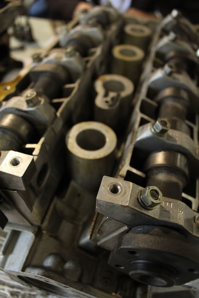

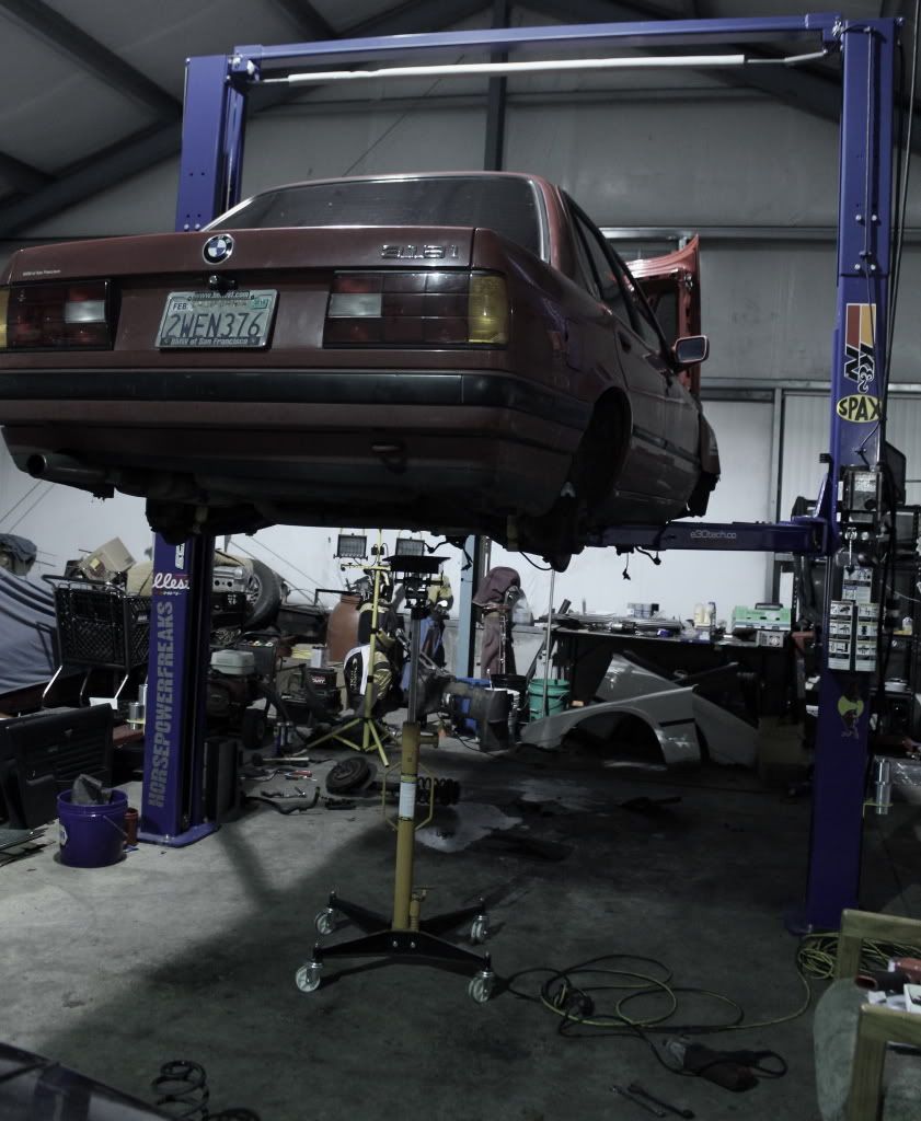

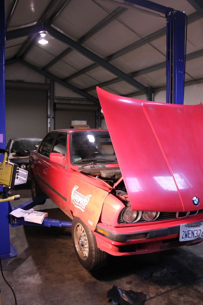

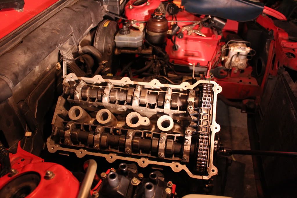

    Got the car in the shop and onto the lift. Began disassembling the engine
    I haven't removed the cylinder head yet, as I am waiting on the cam lock tool to arrive.

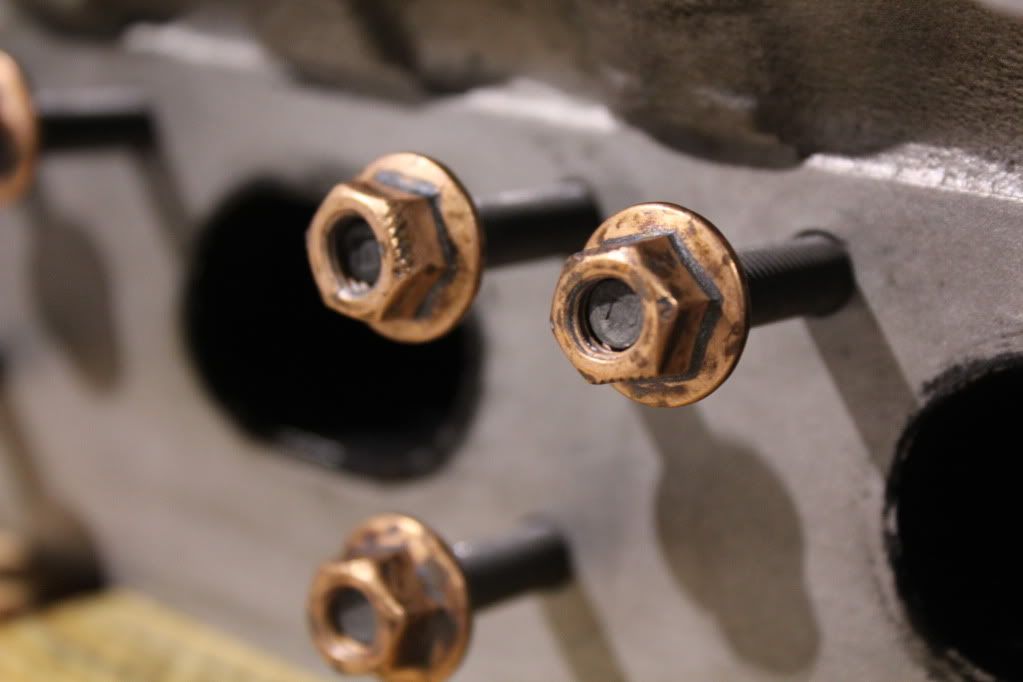

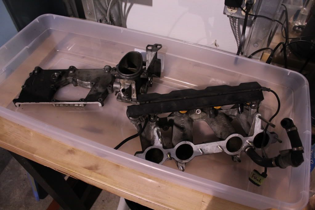

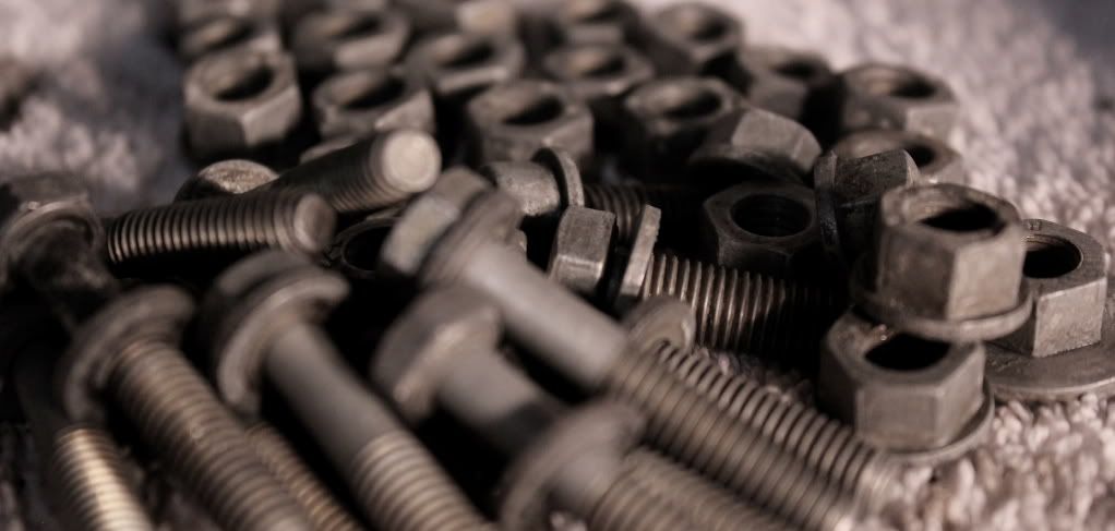

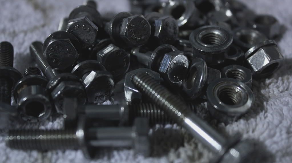

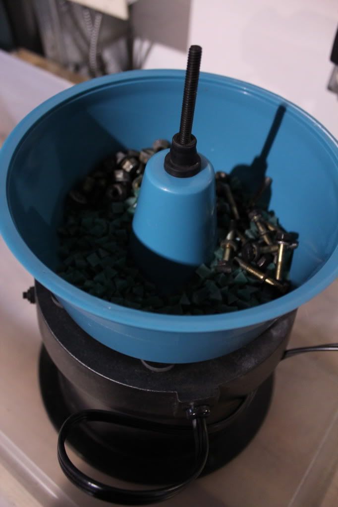

    Got busy cleaning up the parts I had removed. Tossed all the hardware into the vibratory tumbler.

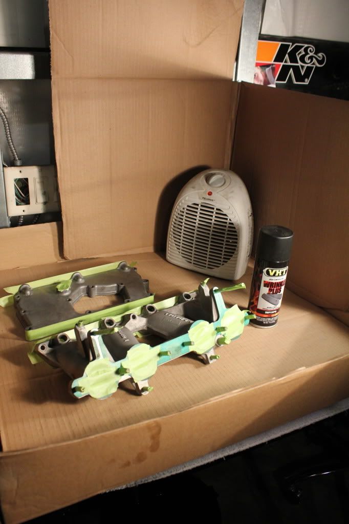

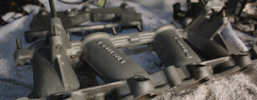

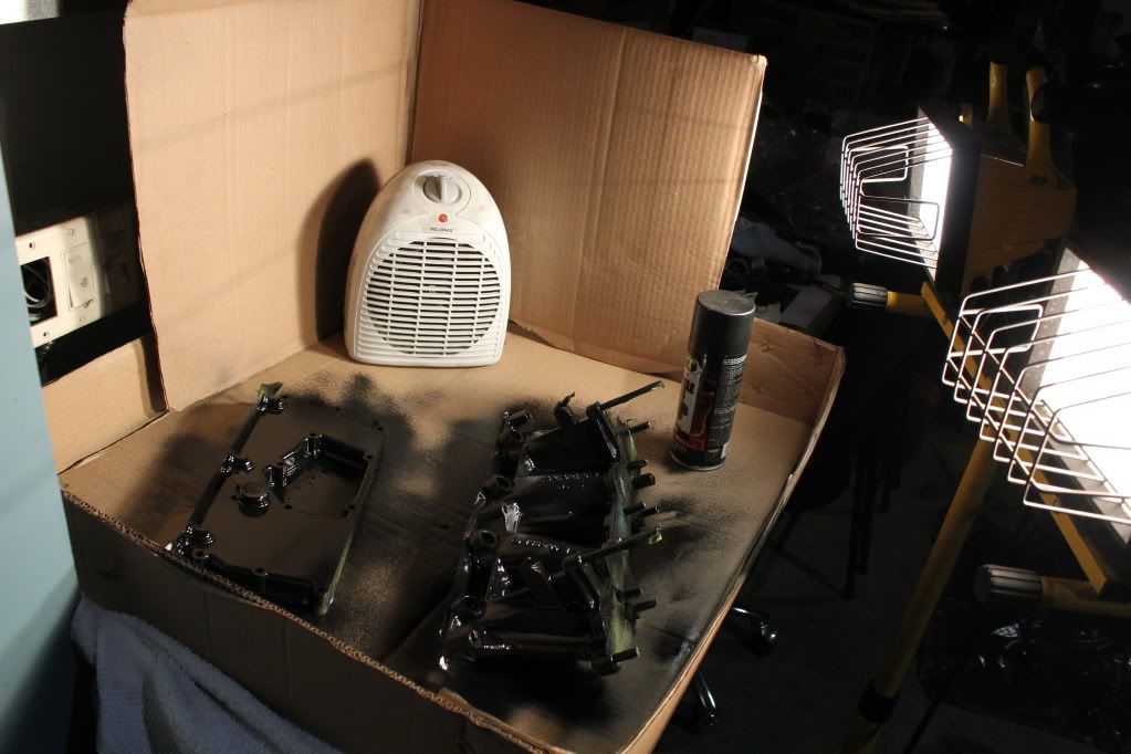

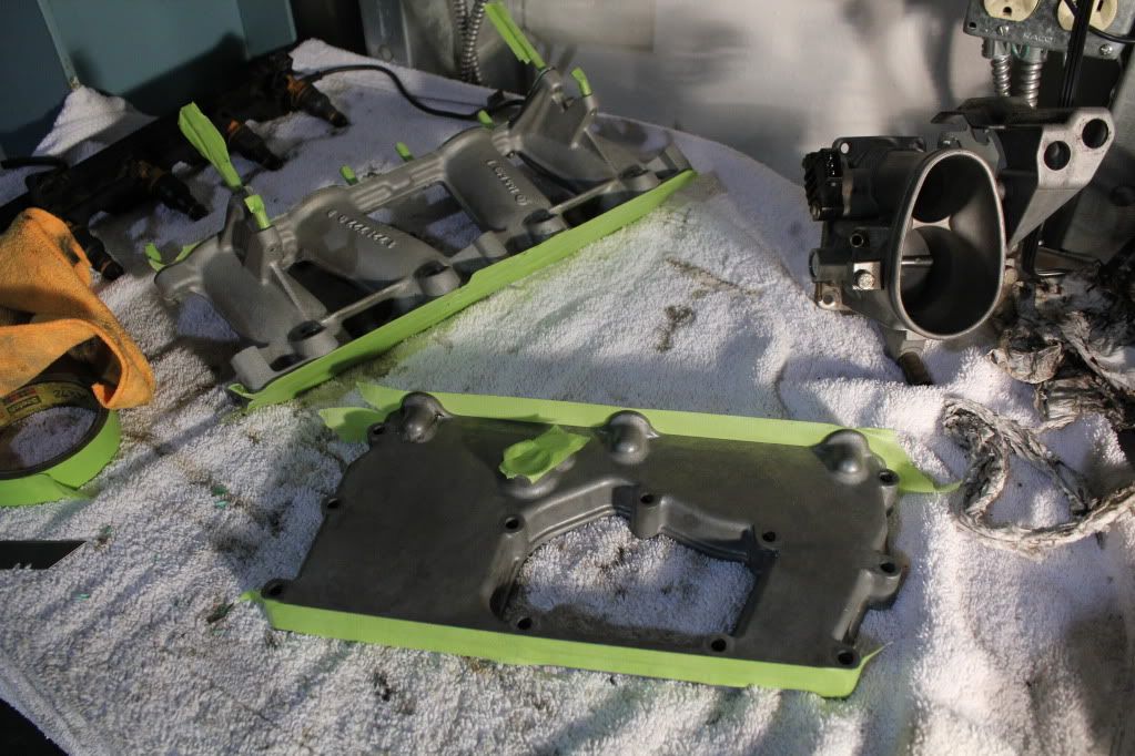

    Then set about cleaning the lower intake section and timing cover
    Then prepped for paint
    Good old wrinkle black
    A couple hours later I checked the hardware in the tumbler and found this
    Nice and clean. Switched to the polishing media and tossed them back in.

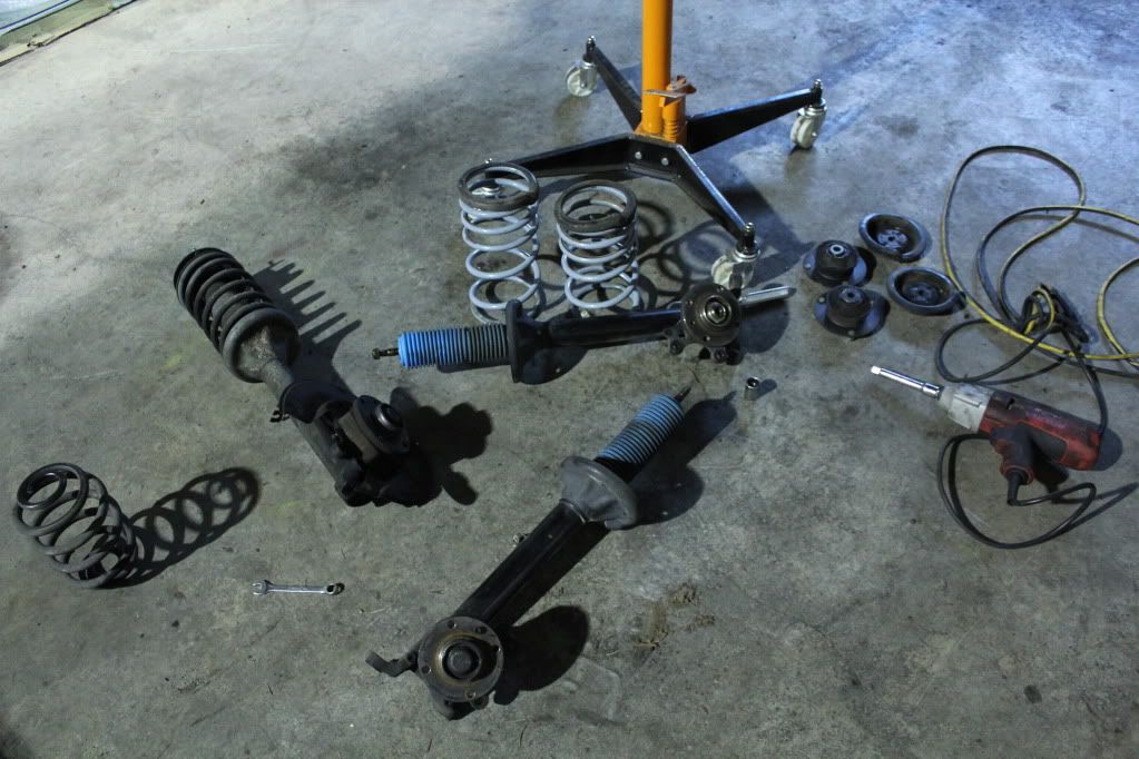

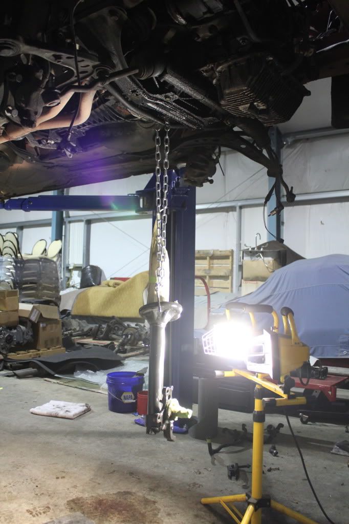

    Next I removed the suspension components that will be replaced.
    And set to work swapping springs around. The rear is finished, but I am waiting on new parts to reassemble the front.

              This is what I want to do for my GF but same situation she drives it everyday, it is also a E36 318i.
              Anyways well done, also you don't need the cam locking tool, I just removed the cams when I did mine, another not if you are going to have it for a while replace the gasket between the timing case and block mine was leaking, and if it gives up then you have to remove the head and timing componets to get to it. You can see it in my thread in my sig.
              • LuckyHenriksen
                • Jun 2010
                • 4244
                Thanks, that is a great idea! I just decided to buy the tool, I would like to have it in the box for future projects.
                  Fair enough, it dose make the job easier. looking forward to the finish product, and good to see you are keeping the M42.

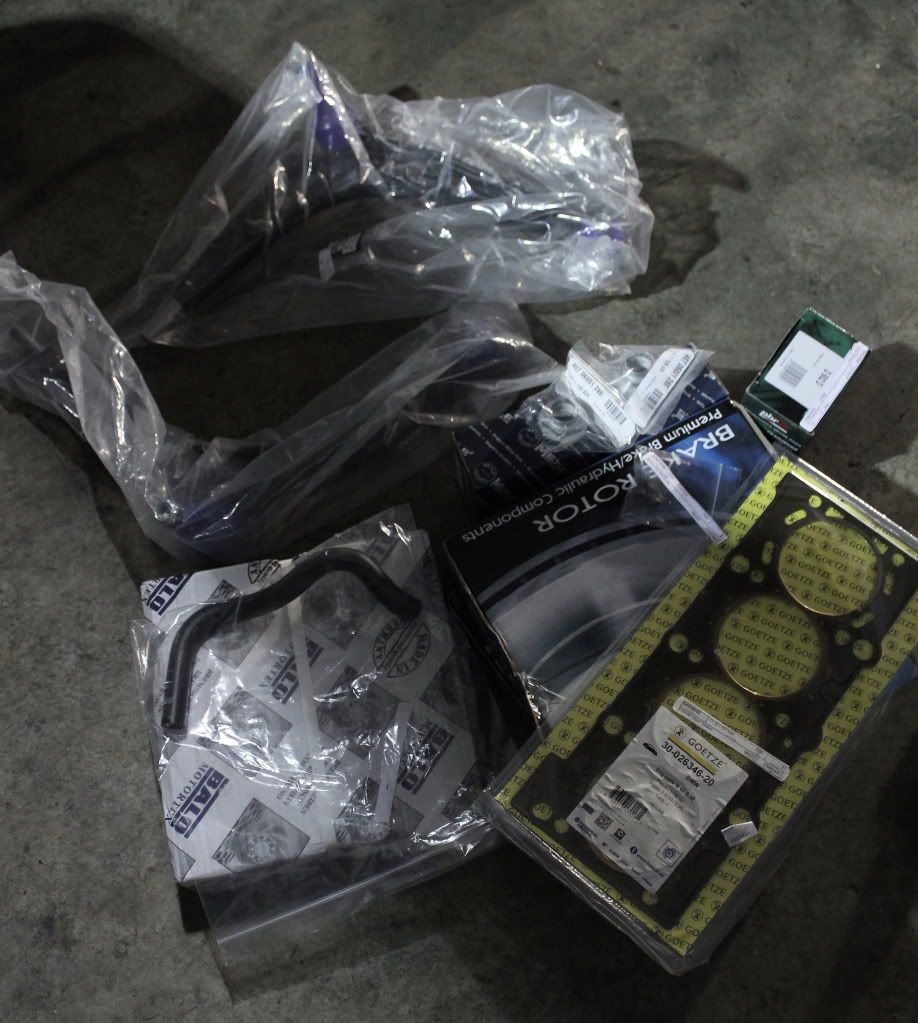

                    After 2 days in the tumbler the bolts/nuts have a decent shine to them
                    And the first large parts order arrived! More expected over the next couple days

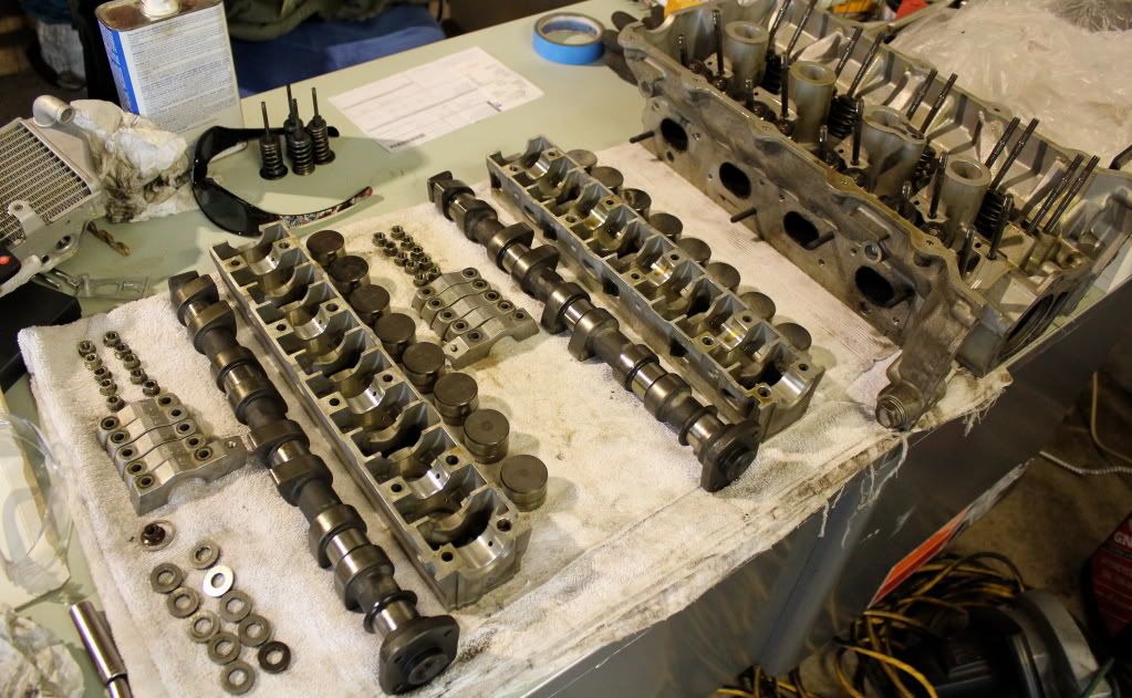

                      Well I need to update this thread, kind of left it hanging. The car went back together *almost* all the way, then other projects and various traveling got in the way and the job was sidelined. Finally decided to get it all finished up. The car is all together now, aligned, and running well. All that is left is a few cosmetic things to take care of. It sure is fun to drive with the stiff suspension and nice tires. The little M42 can move pretty well.
                      Photos to get caught up:

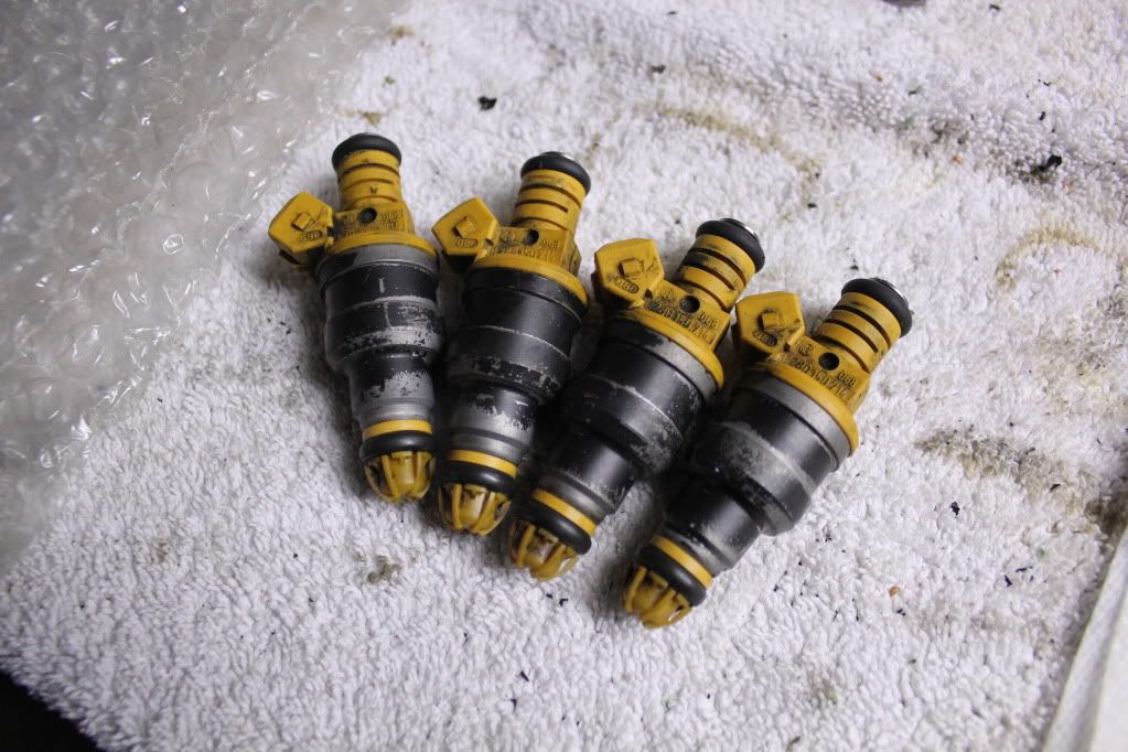

                      Had the injectors cleaned and tested at a local shop
                      After discovering there was a nice crack in the original head, I sourced this solid one from a local guy. Had it pressure tested/tanked/surfaced. Had to reassemble it on the desk

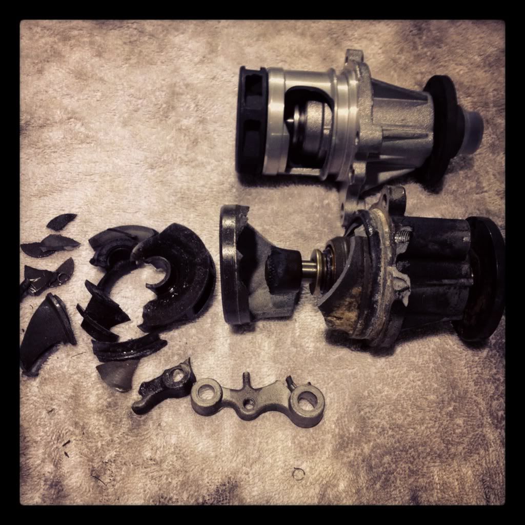

                      Replaced the water pump. Ended up being a much bigger job than expected.

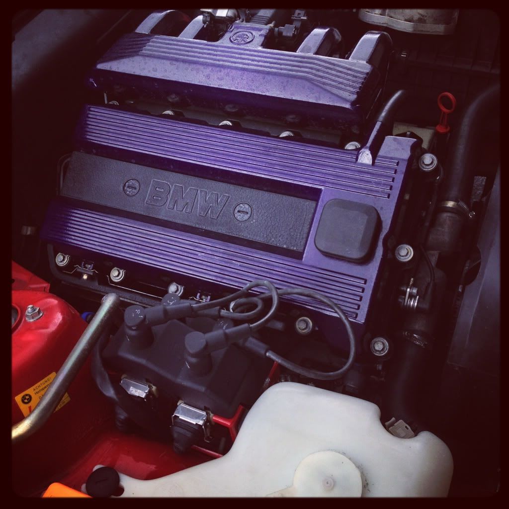

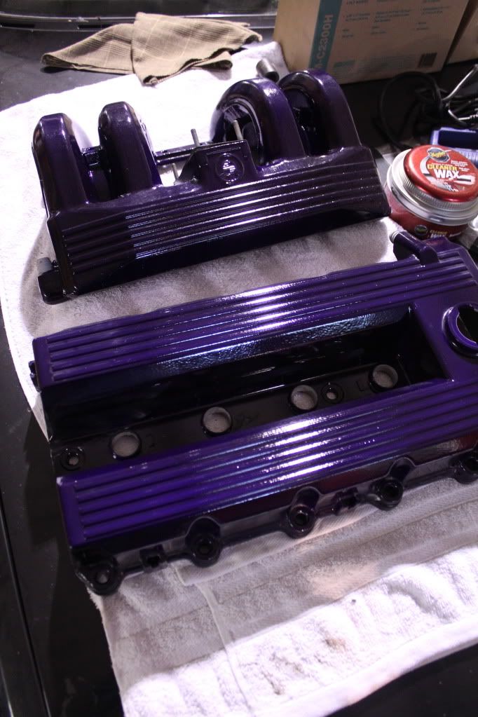

                      Added a dash of color

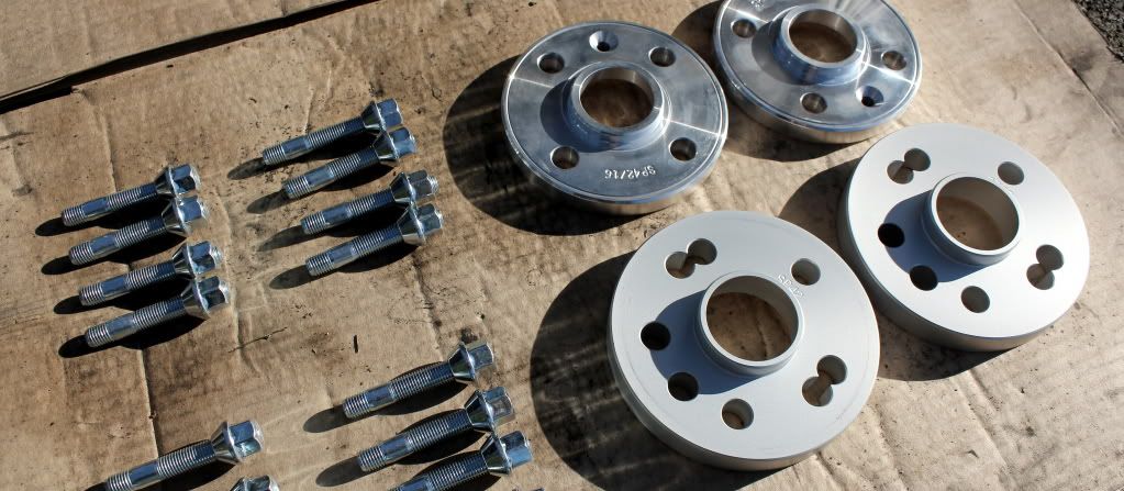

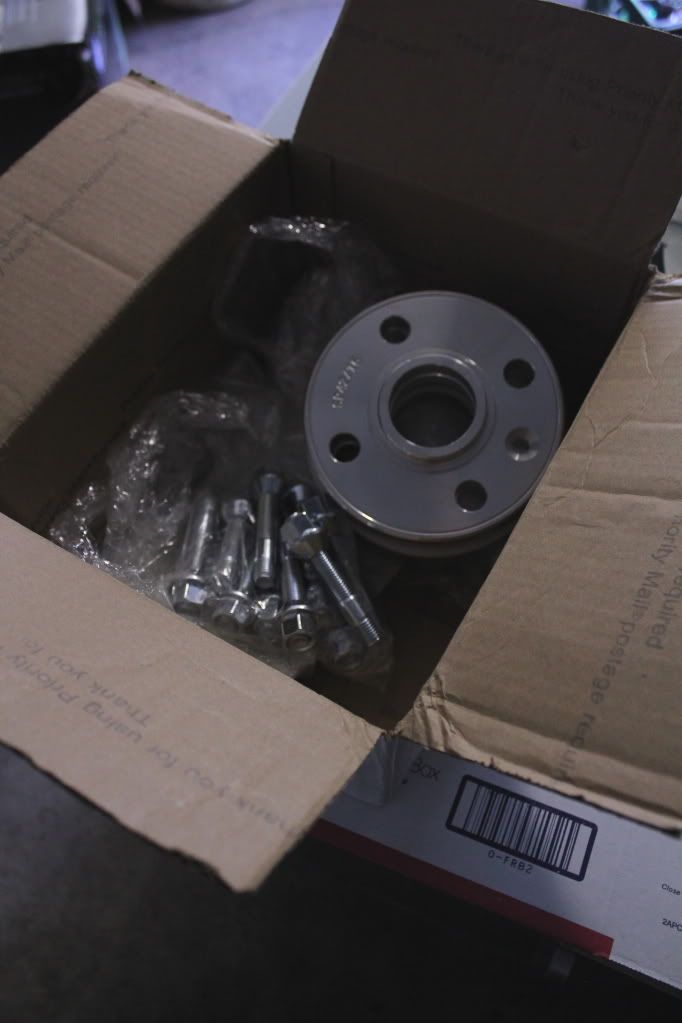

                      And a sexy spacer/stud kit from Motorsport Hardware. Great products
                      And finally, a finished product.
