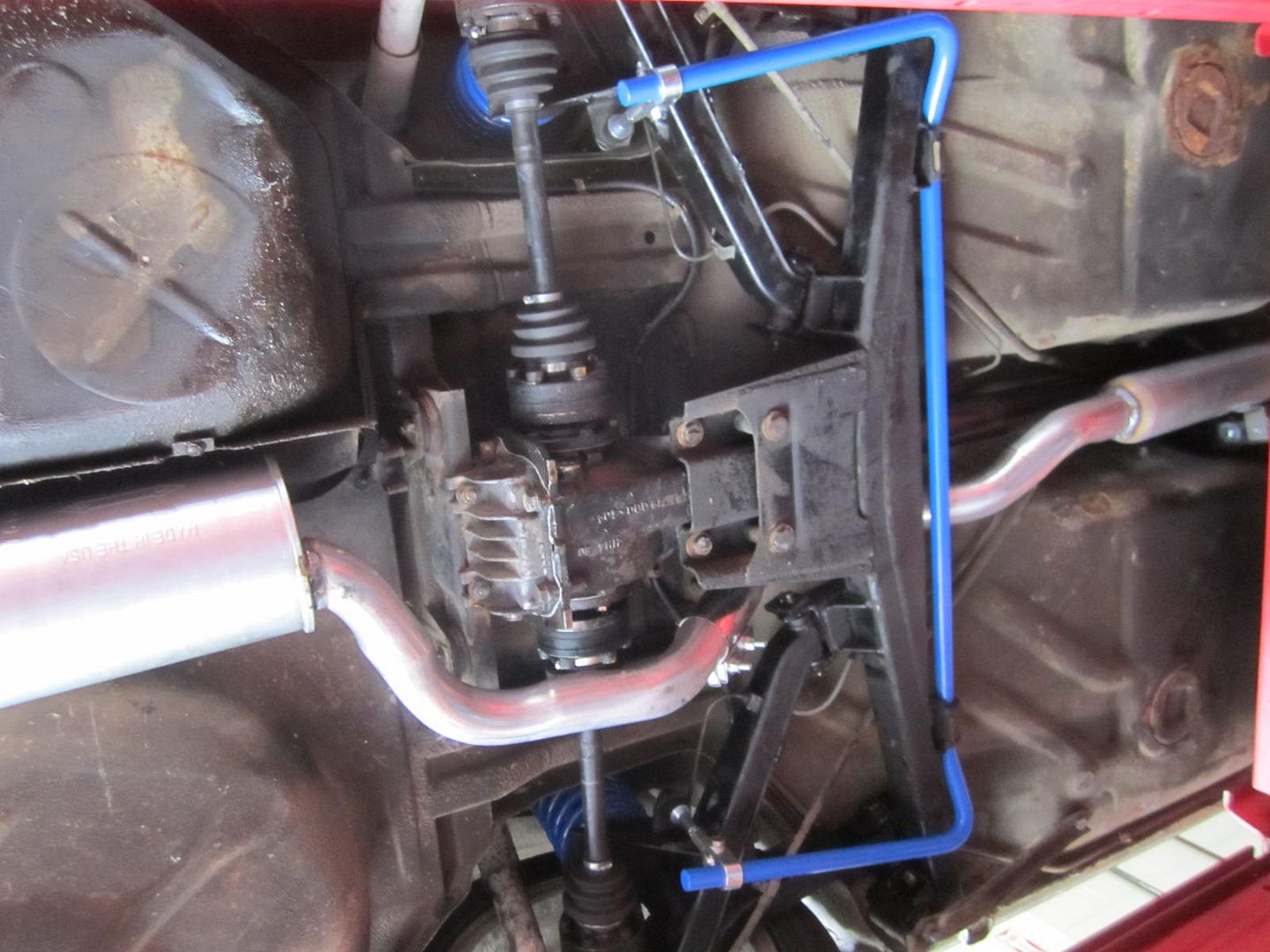

    Still on the 2002 diff/halfshafts/stub axles?
    No. Never was

      Originally posted by catuned
      No. Never was
      This sure looks like 2002 parts, Did i miss the part where the 2002 rear end was replaced ? And by what?
      Lorin

          #349
          It's a e21 rear end sir

            #350
            Same difference, will be interesting to see how it lasts @ 400 wheel. The wheel bearings and stub axles are tiny. At least the torque is low (ish) !

                  #353
                  It matters more where the peak torque is in the rev range than the number itself. This torque curve will be loading the CVs and diff slowly so parts have a better chance of survival.
