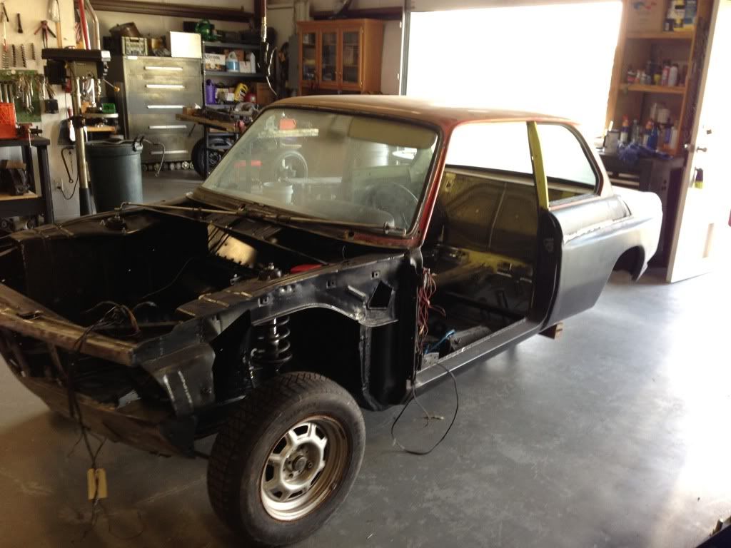

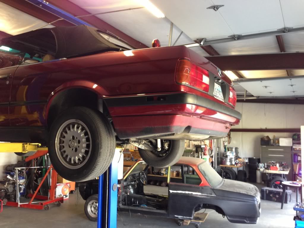

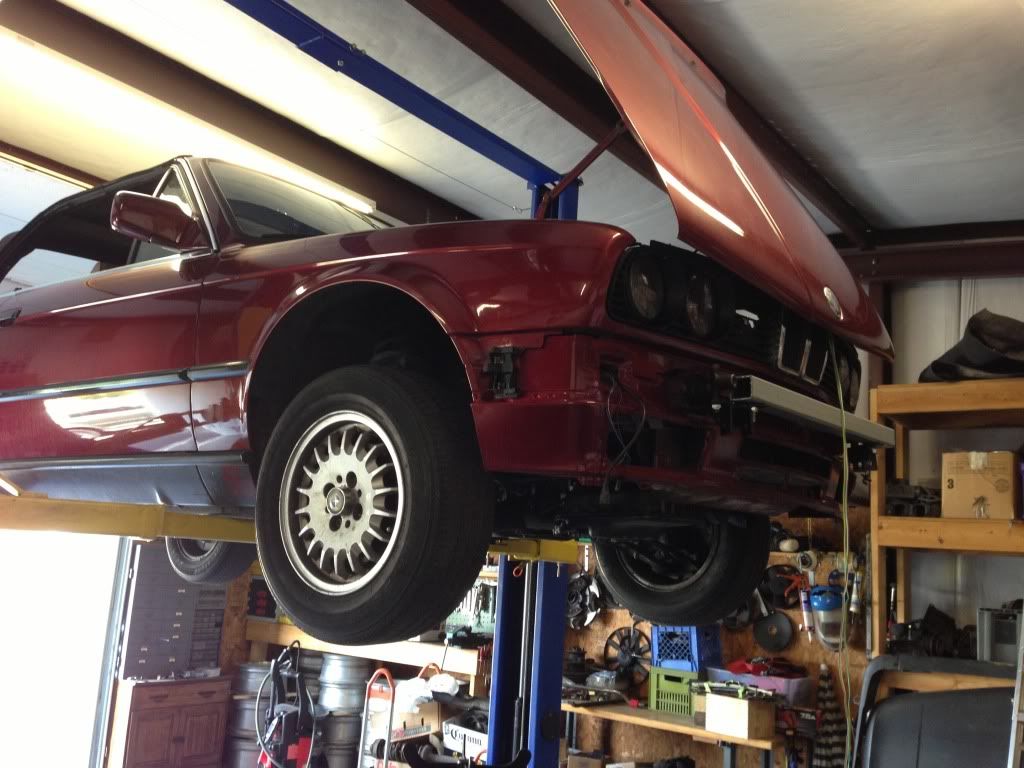

        So I took my car over to my friends garage behind his house. Awesome guy with awesome tools!!!!

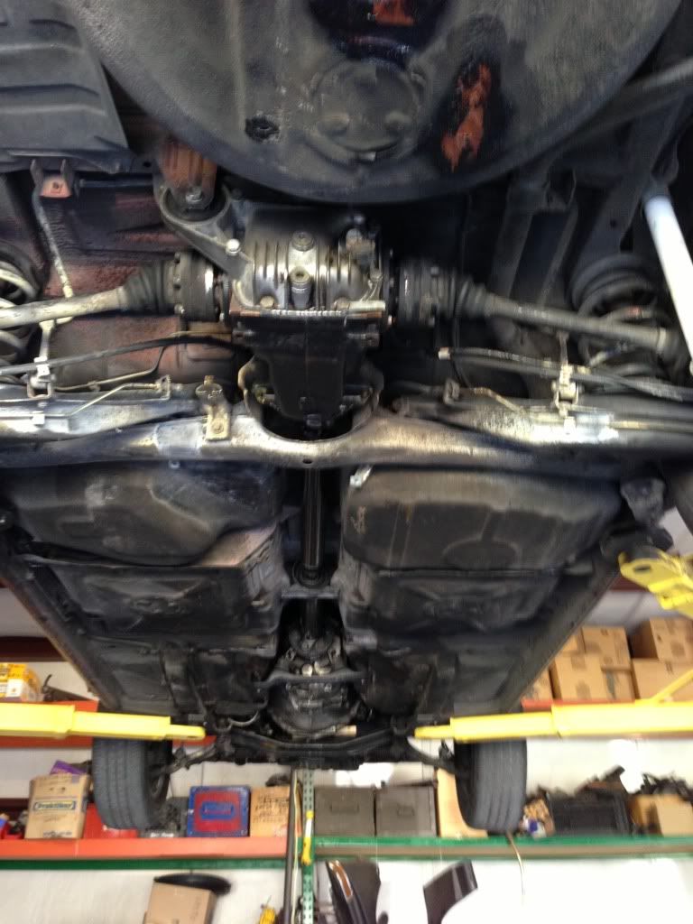

        Anyway. Put it on the lift to try and get an idea of what I want to do with the exhaust. It's more complicated than id thought. Oh well. Worked on it all day and now my shoulders and back hurt. I'll just let the photos show how much work I didn't do.
        Home made tow bar ftw!!!
        Another shot of the 2002.
        And all I managed to get done

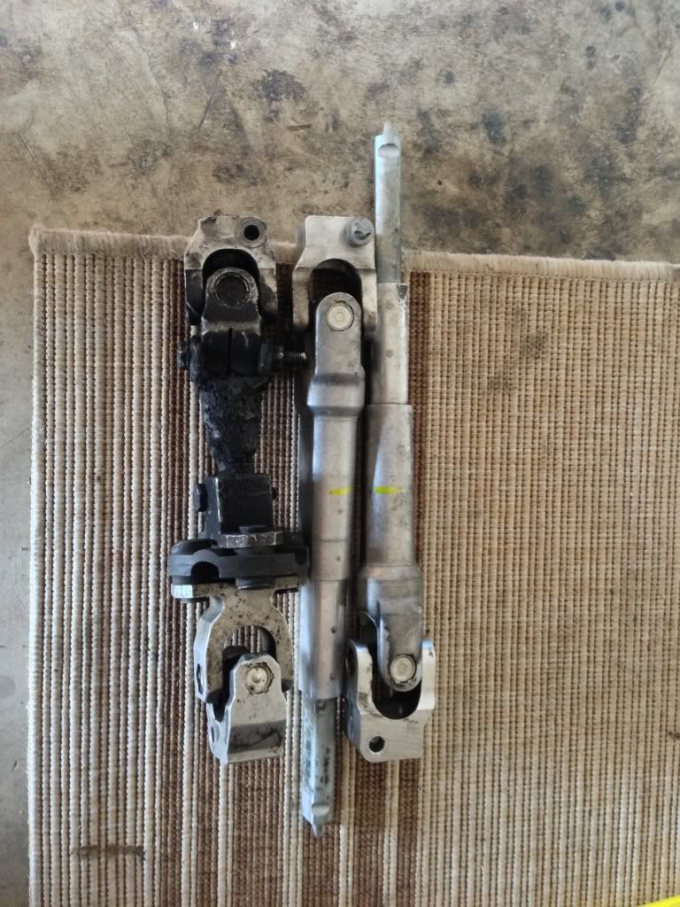

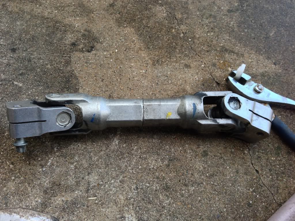

        Oh you see that make shift steering shaft????
        Yeah let's fix that.

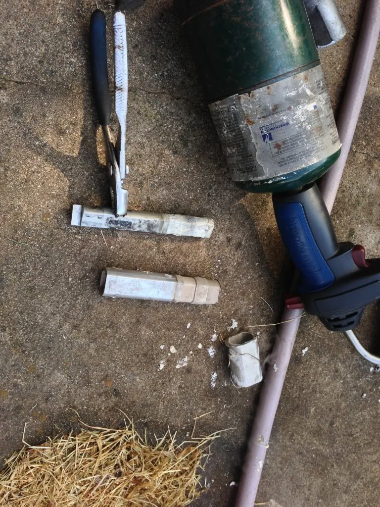

        Went ahead and grabbed two e46 columns and put em together. Easiest shit ever.

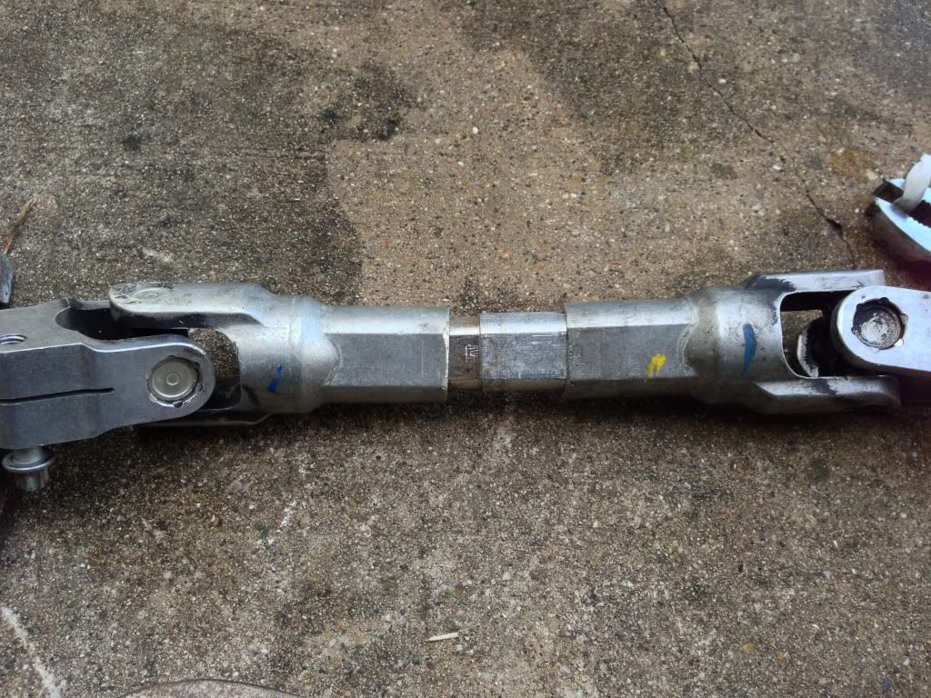

        Measured the columns
        Torched the hell out of them to melt the plastic that's injected to hold them together.
        Then slide it all together
        Viola!!!! Magic!
        And that's all you need to do to make a on price shaft. Yay!

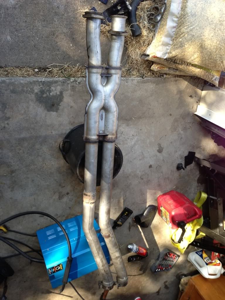

              Here is how I routed mine, dual 2.25 to an X-pipe, Jones 2.25 glasspack's and finishes through a Magnaflow dual in/ out muffler. Quiet enough to daily drive but there's no mistaking it for anything but a V8 when you crack into it!
              We notched the trans mount on the drivers side and added a gusset to clear the downpipe, not totally necessary but I wanted as much clearance underneath as possible and the e30 body isn't very accommodating for an exhaust pipe on that side. The exhaust was made so its two removable sections. If you ever have to remove it (I've had to twice) you'll thank yourself for paying the extra $100 in V-bands or $20ish for flanges/ gaskets. The chassis brace in the middle that crosses the tunnel now doubles as an exhaust hanger/ brace. This makes it so you can detach the v-bands and let center section hang then simply unbolt it from the body. No rubber donuts to wrestle with, unfortunately I do not have pictures of that.

                #127
                That looks great Dirty! Thank you. So I'll grab two of those flexipipe things and make use of them. Instead of v-bands I was going to expand one end of pipe to slide over the other where they meet and use a strap-bolt to tighten.

                    #129
                    Good info.

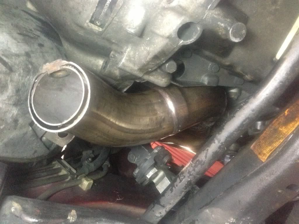

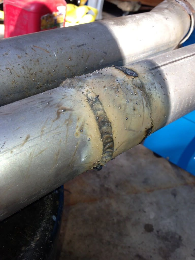

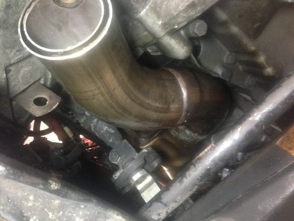

                    As for today, I went ahead and modded my mid-x-pipe like yours
                    Went from
                    To
                    Pretty much the best I could do with a flex cored 110v welder

                      Looks good man! Feel free to come by and put mine together.
                            Man, being a welder I will give you props, that is about as clean as they come for your welder setup, good job.
                              Man, thank you! That means a lot coming from you lol. I'm trying to find an easier clean up method. I'll probably get to using anti-spatter as well.
                              You don't want to see the stainless lol. I kept getting termite mounds/air escapes so I grinded it down and re-welded a few times. Looks terrible but sealed and sound.
