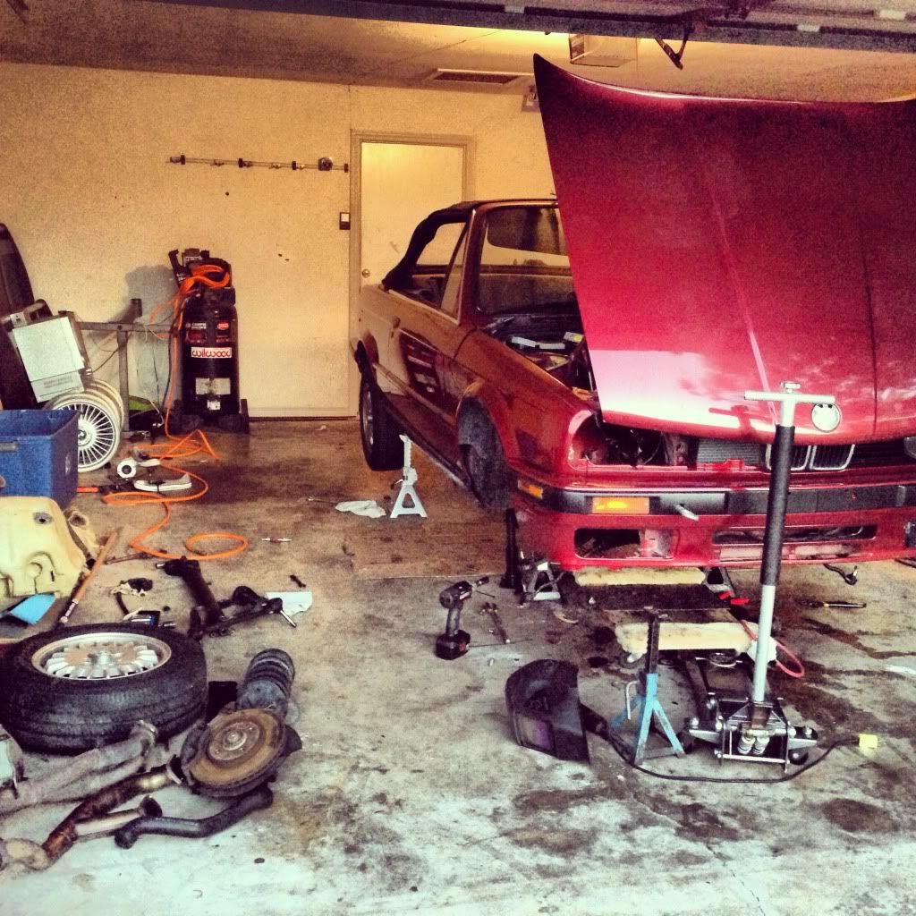

        All I have to do is run my brake lines and I can actually drive it!!!
        I really wanted to drive it anyway just up and down the alley and use the ebrake but there's too much gravel on the pavement so no beuno.

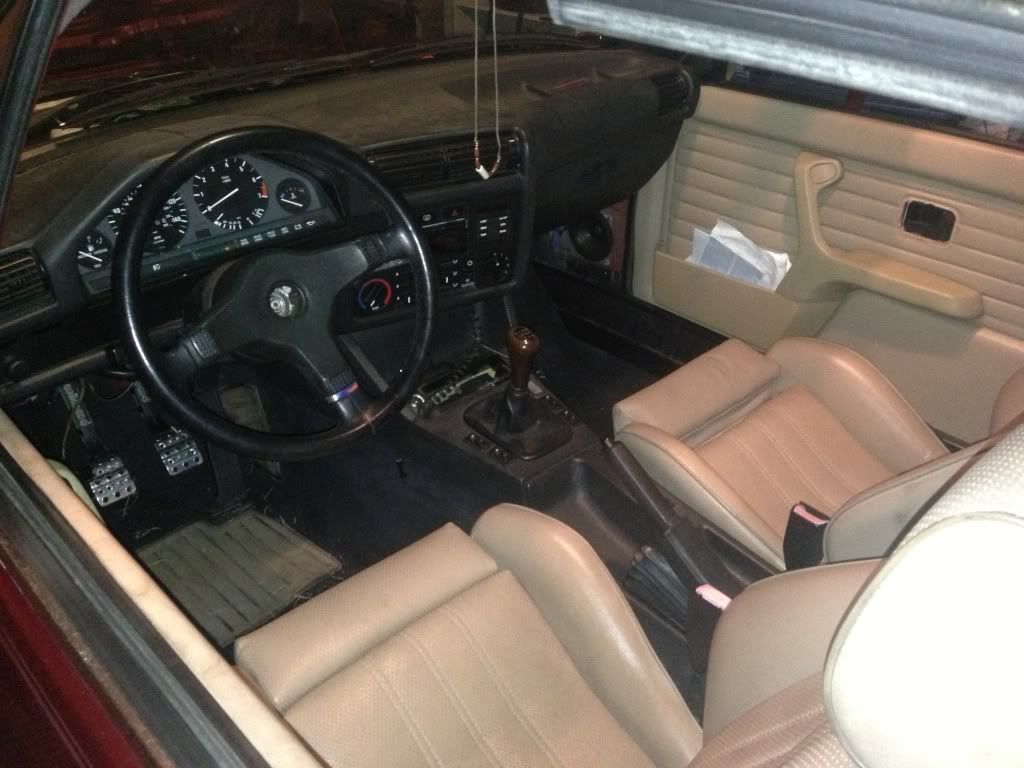

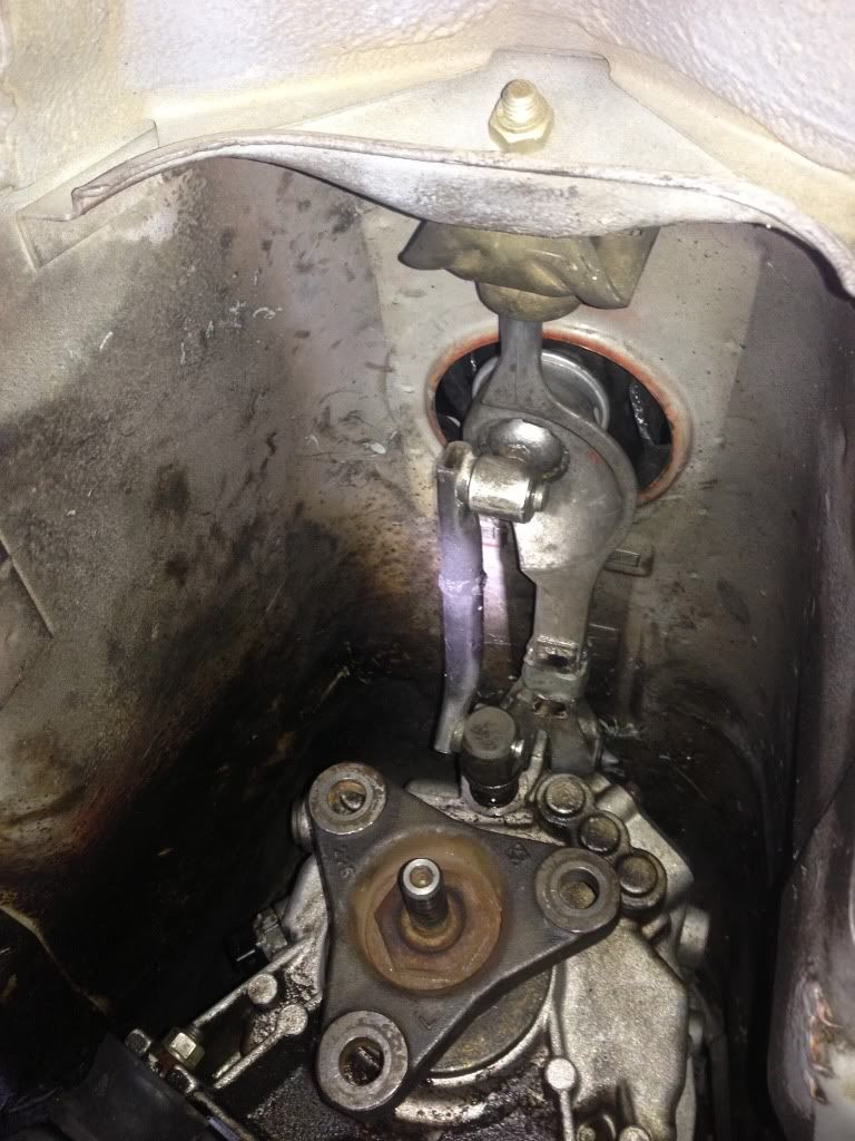

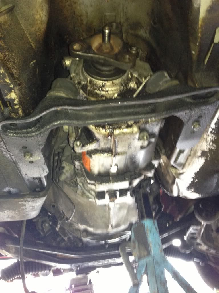

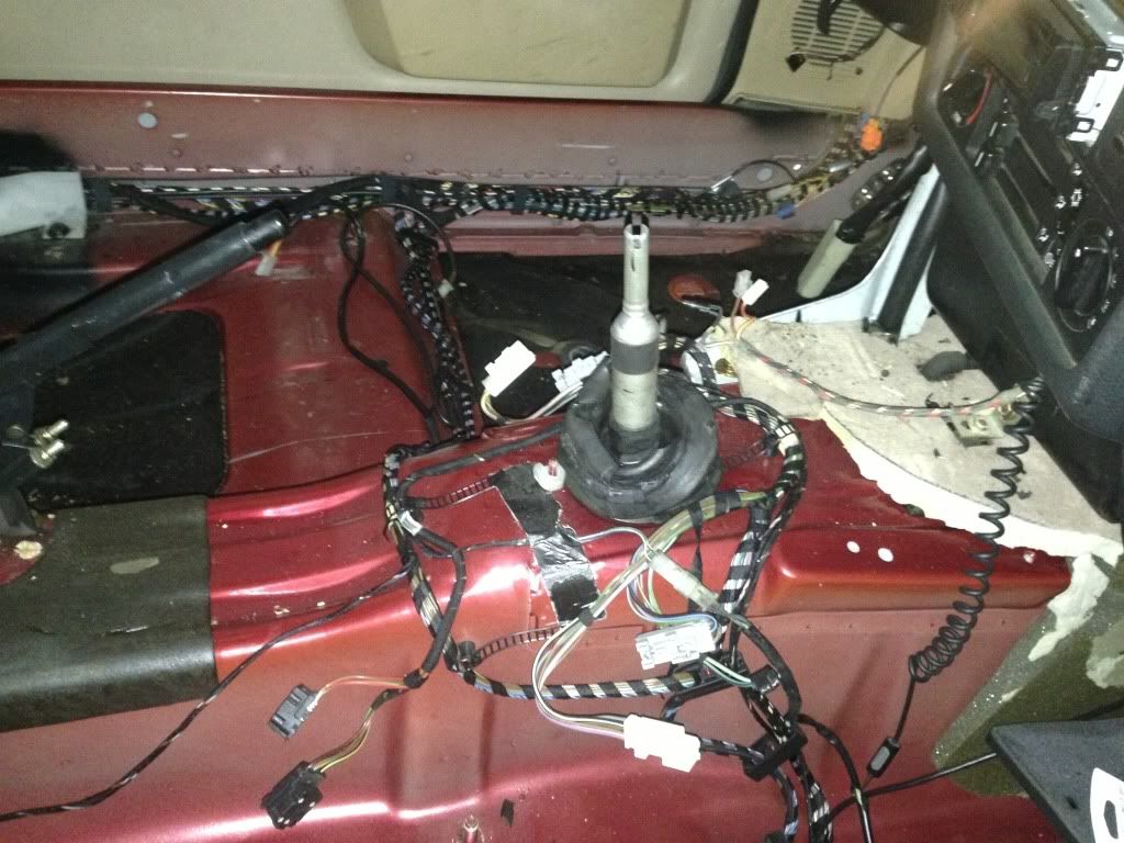

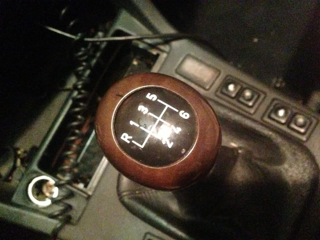

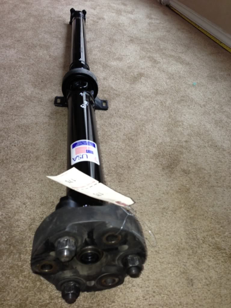

        Driveshaft is in. Built my shifter and its in. Customized my throttle cable. Factory 95 540i coolant lines worked great.
        I can't wait!!!
        Once it's rolling it's off for upholstery.

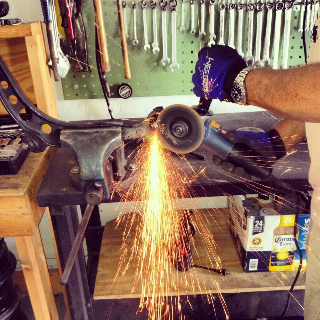

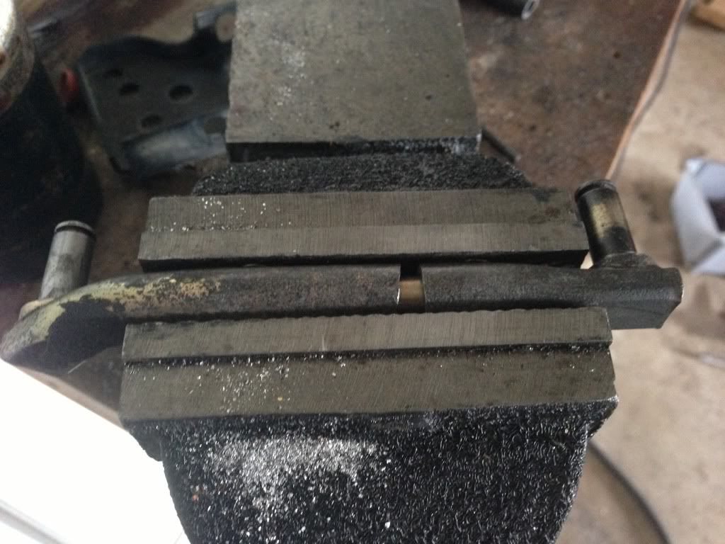

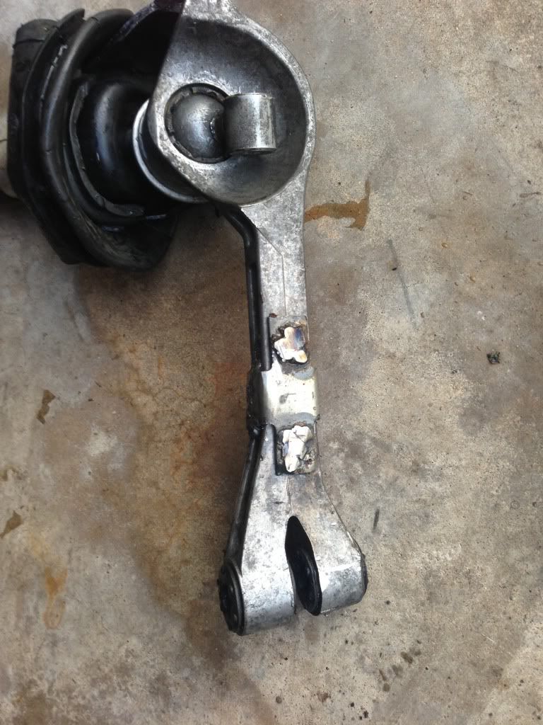

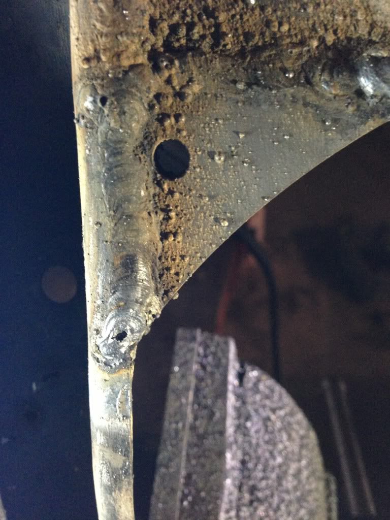

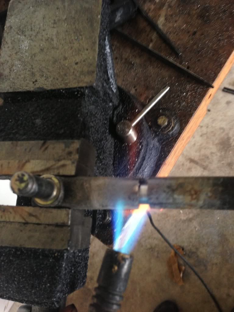

        Ran a bolt I cut in the middle to give me something to weld on
        Since I don't have a tig, I drilled holes and bolted a steel support around the shifter. I then sheared off the bolt heads and welded them up for permanence.
        Hot damn! That shit is centered!
        This made me laugh.

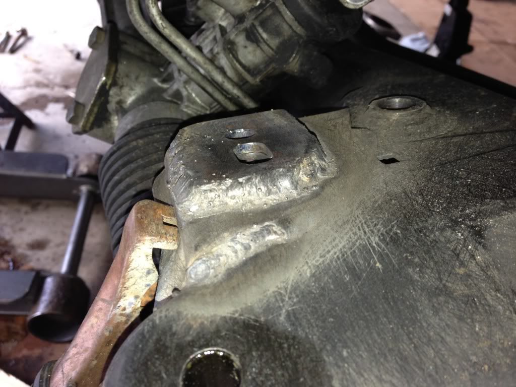

        Then welded up the subframe supports. Put these on top to help the oil pan clear the steering rack.

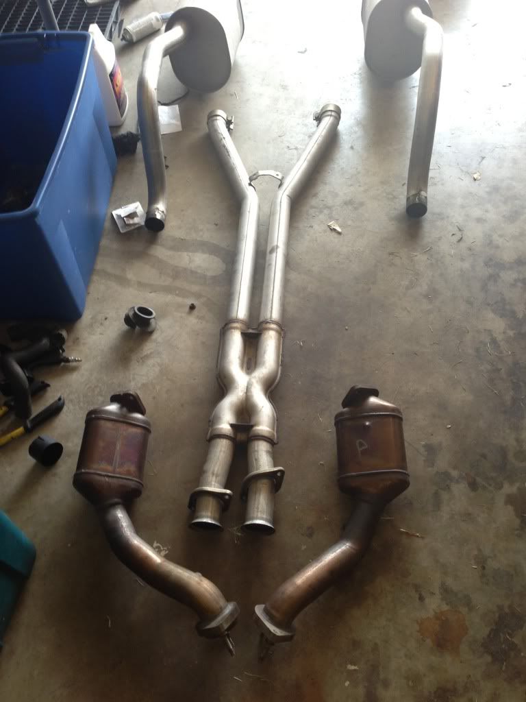

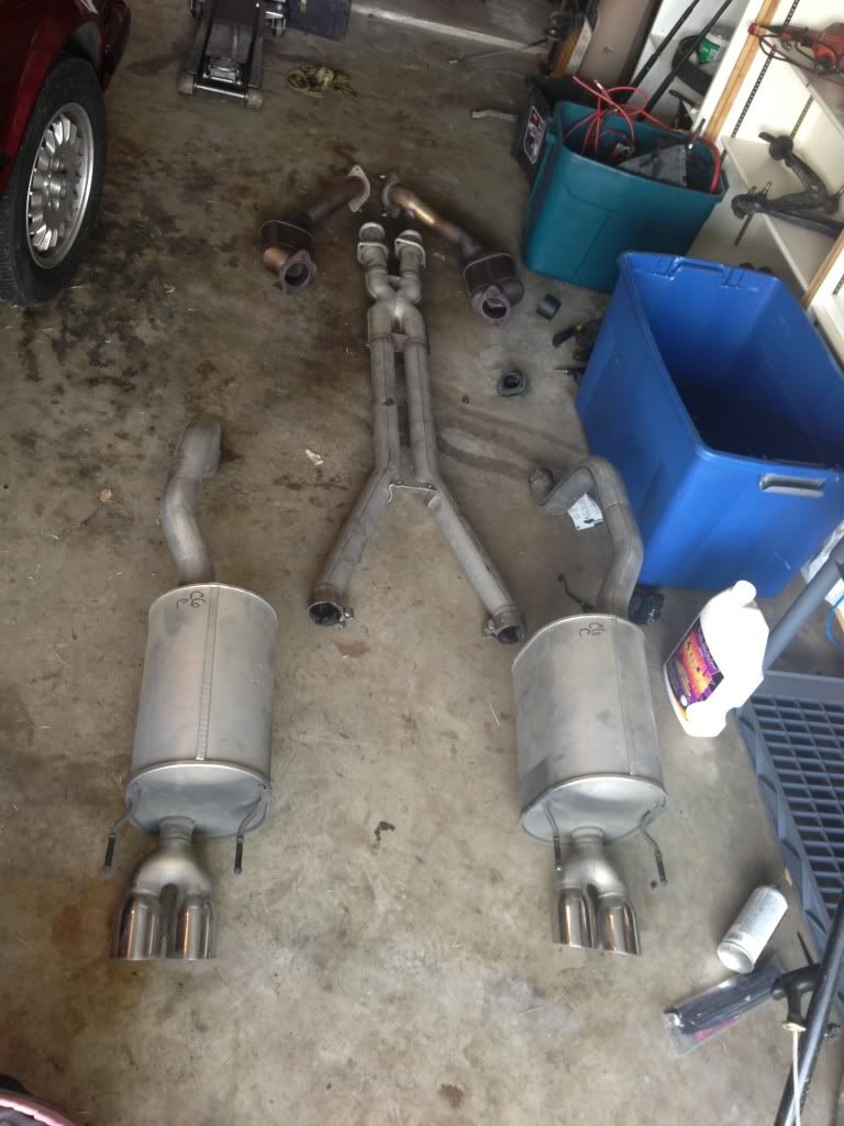

              I've been nicking and knacking all around. Just picked up a new Chevy C6 z06 exhaust from the manifolds to the mufflers. Probably wont use the mufflers since they're huge. 2.5 all the way back. Not bad. I'll get picks later.

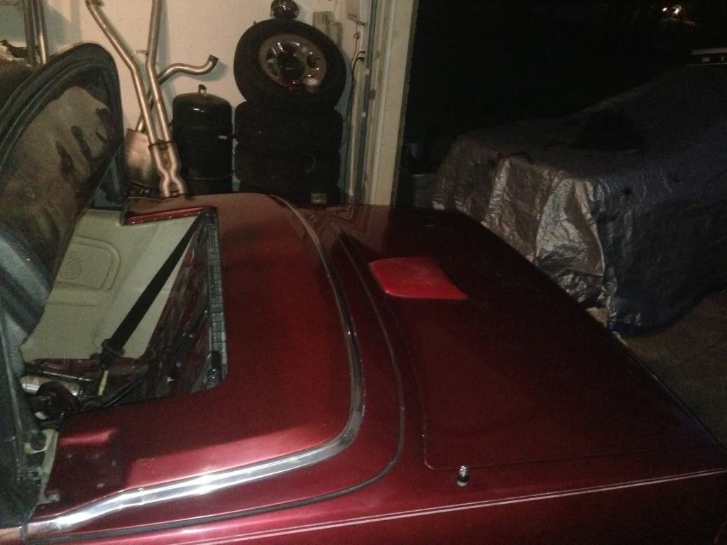

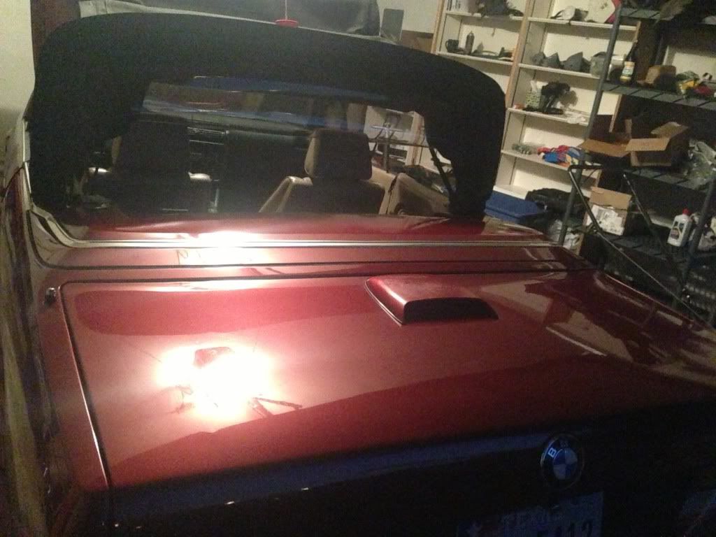

              Also managed to pull up the vinyl of the rear top storage lid. Compound and polished the shit out of it. Looks great!
              I'll let the pics speak

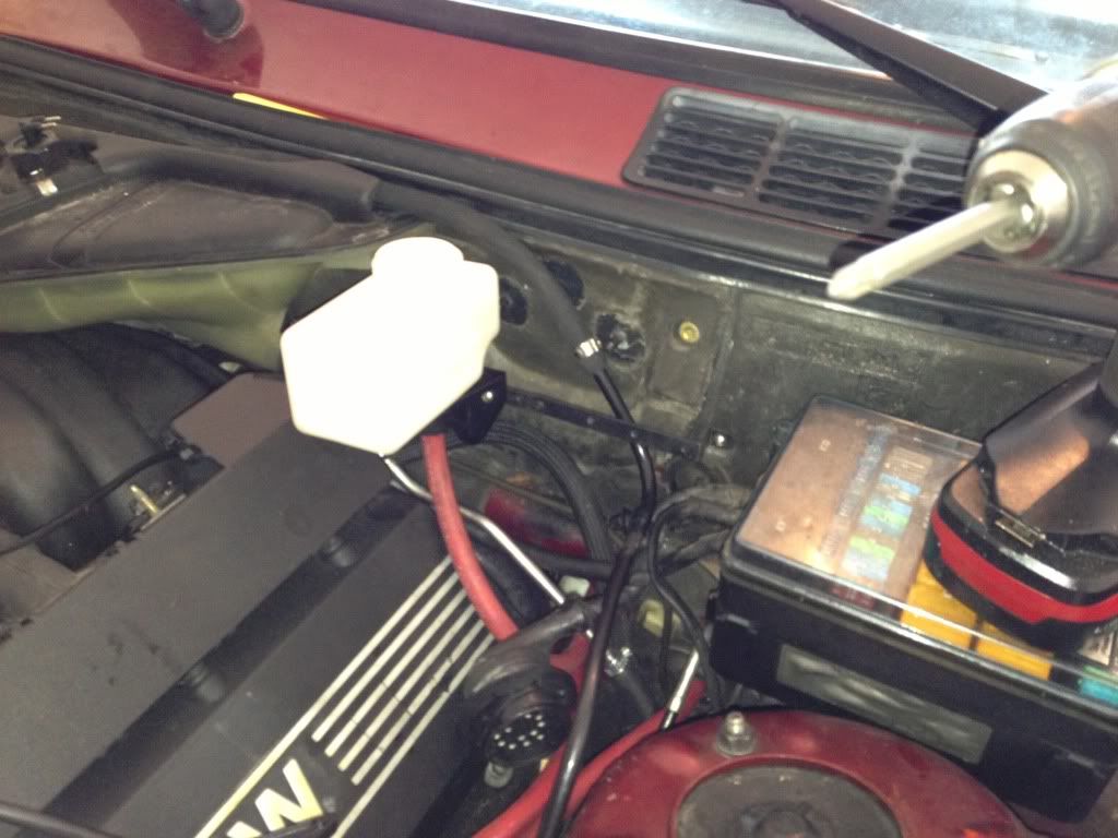

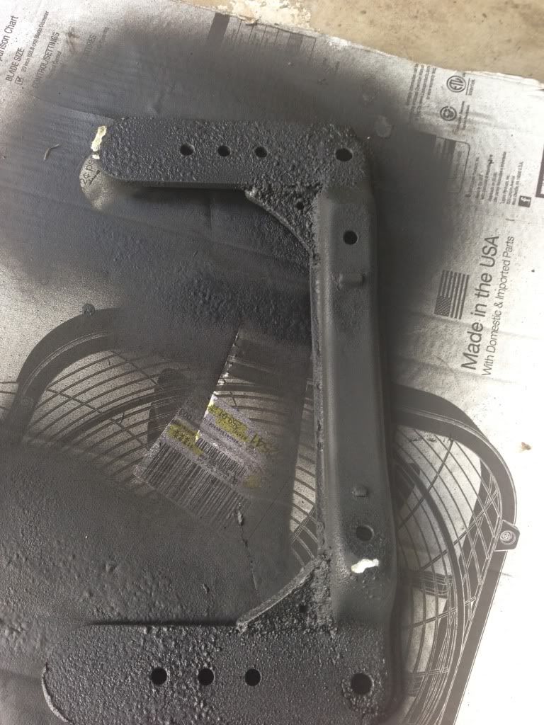

              Started to build a brace for the resivior a.
              End result

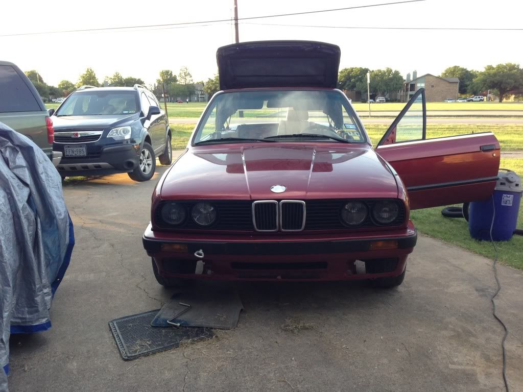

              Euro grills and headlights finished

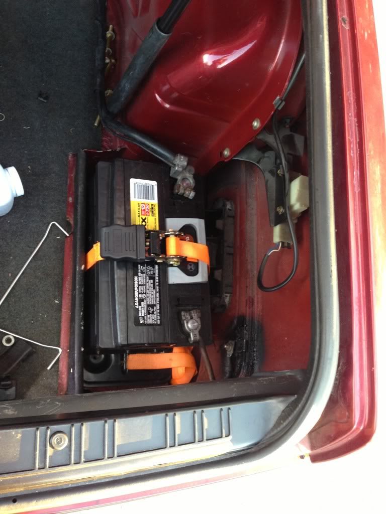

              Also took the battery cable from one of the coupes and remote mounted my battery. The weight that was in the rear was fuggin heavy. I suggest all vert owners remove it!
              Welded the ground

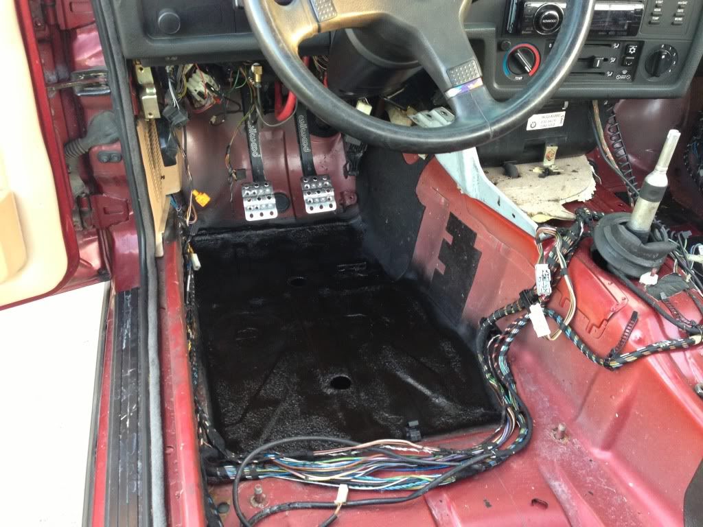

              Removed the water holding sound deadening mats to prevent rust.

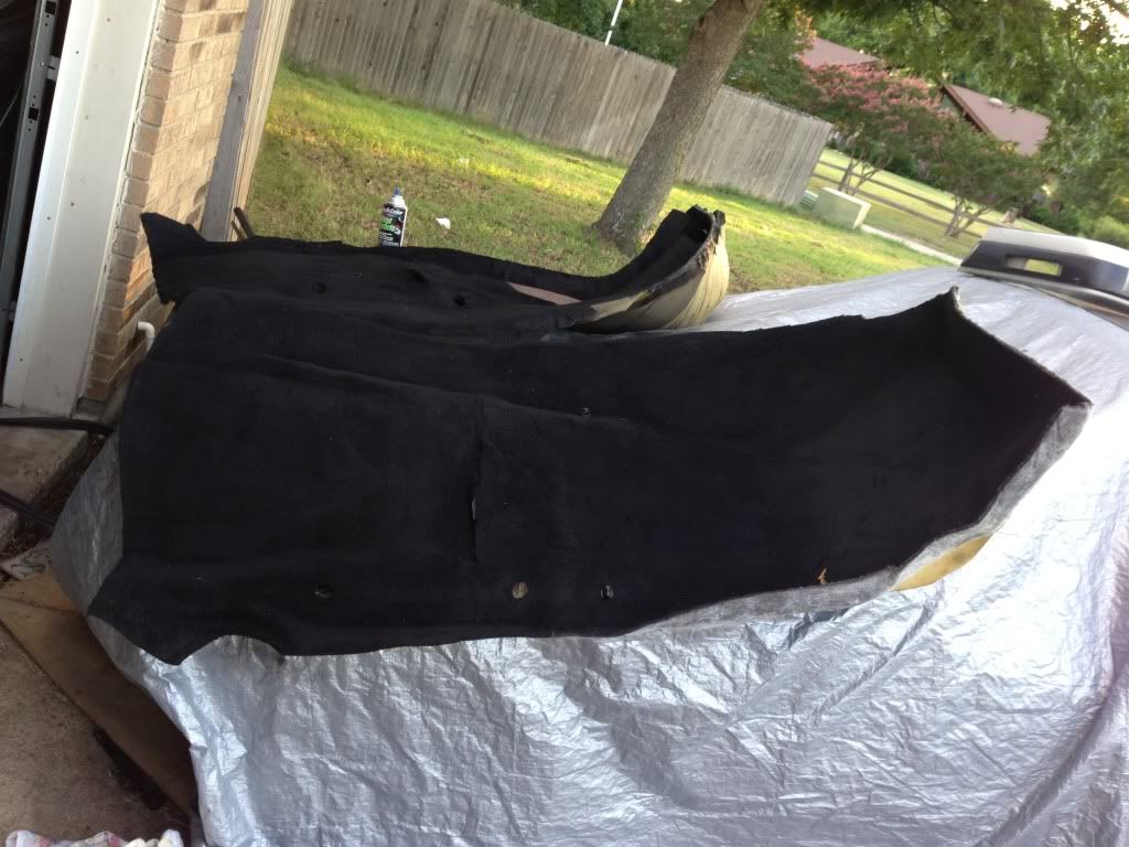

              Went ahead and dyed my carpet. First I sprayed with the spray dye and then I got a bucket of boiling hot black rit dye and dumped it all over so it would soften the aerosol based dye and get the beige that was bleeding through. Looks and feels stellar
              Polished top storage lid
              Carpet in

                Coming from personal experience, grab an E36 sedan battery cable. Seems to work better for verts and it fits the E34 harness perfetly. There's a little bit more rubber insulation where you need it so it won't rub through and result in a fiery death. :)
                How did you route yours?
                Also you may be done with your vert sooner then mine. :(
                  E36 sedan only? I was going to cut some plastic or rubber tubing to go over the holes. Very paranoid about that lol. Those holes are very sharp.
                  I routed mine along the trans tunnel and though the rubber grommet of the e34 harness.
                  I still have a long way to go and it may end up on hold. Interior and then 5lug and this winter I plan on AC
                    Mine's going the way it would in normal e30s for the most part.
                      That's awesome.
                      I had trouble putting the seat in with it on that side so through the tunnel it went.
                      I see it doesn't have a thick ass nub on the end so it looks easier to run along side the rear wheel well. Were you able to get it through there or is it through the razor sharp holes?

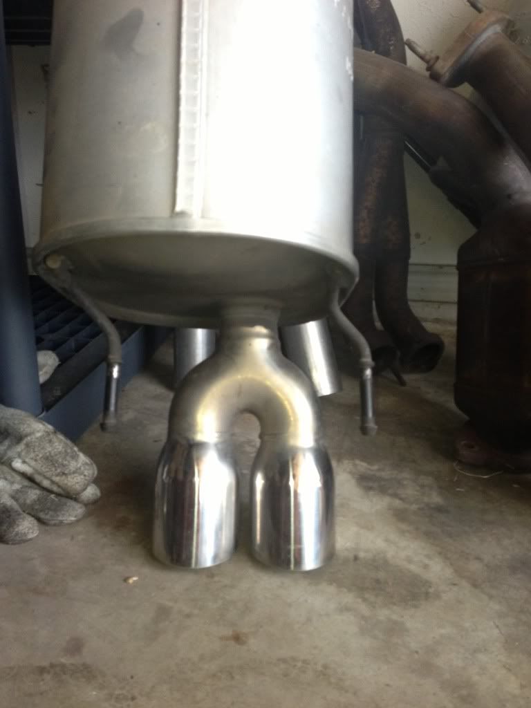

                                And a few pix of the c6 exhaust.
                                Not sure wtf I'm going to do with the big ass mufflers.
