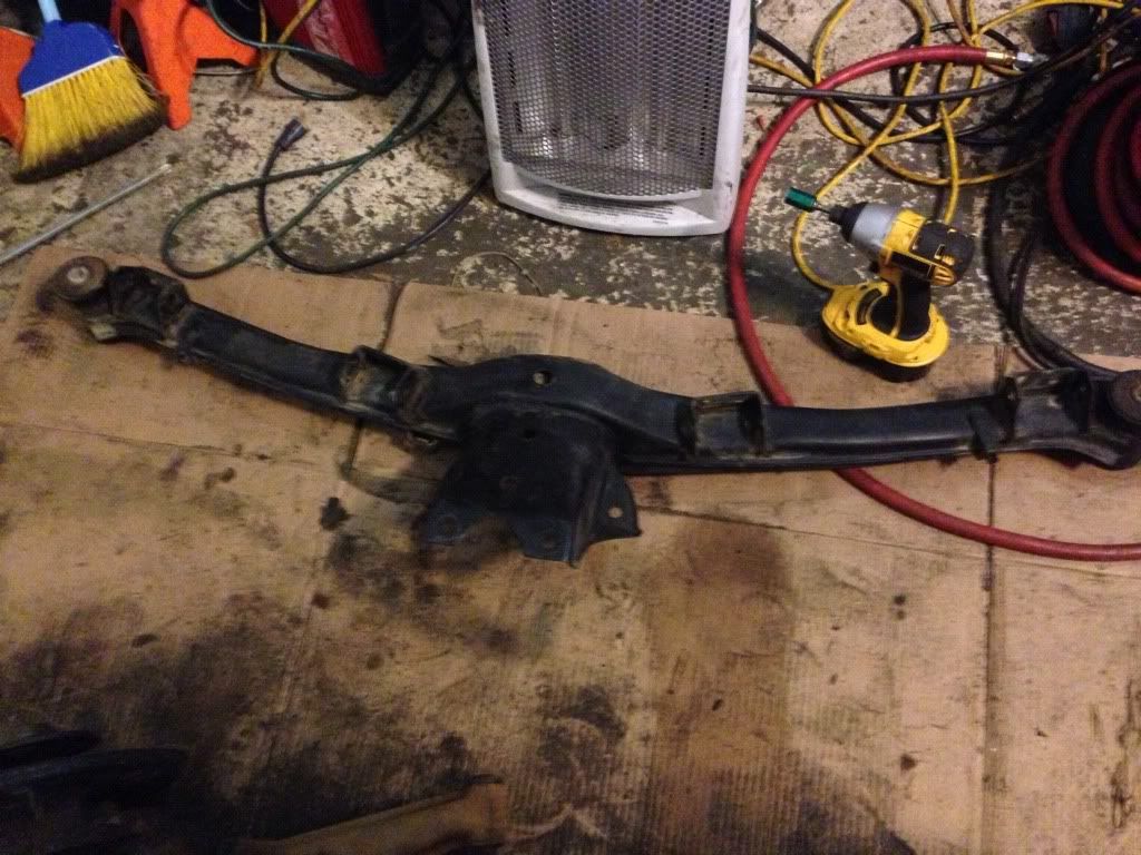

      Got the subframe aparts and started to clean up the diff and subframe today. I have been working for about 1-2 hours a day taking my time on it. Hopefully I can finish it this weekend.
      Dirt off the diff.
      Got the subframe pretty cleaned up and a lot of the dirt off of it.
      Old trailing arms off.
      Going to change the fluid and bushing in the diff. The fluid was extremely dirty and looked relatively low.

                  For updates, I was able to finish the rear suspension and get everything put back together. The only thing I had trouble with was getting the e-brake cables off. I will be putting new cables in later, but it shall do without them for now.
                  Getting the subframe into place.
                  And since I can't really take pictures while I am doing work, here is the subframe up and into it's new home with everything now hooked up and new bilsteins in place.

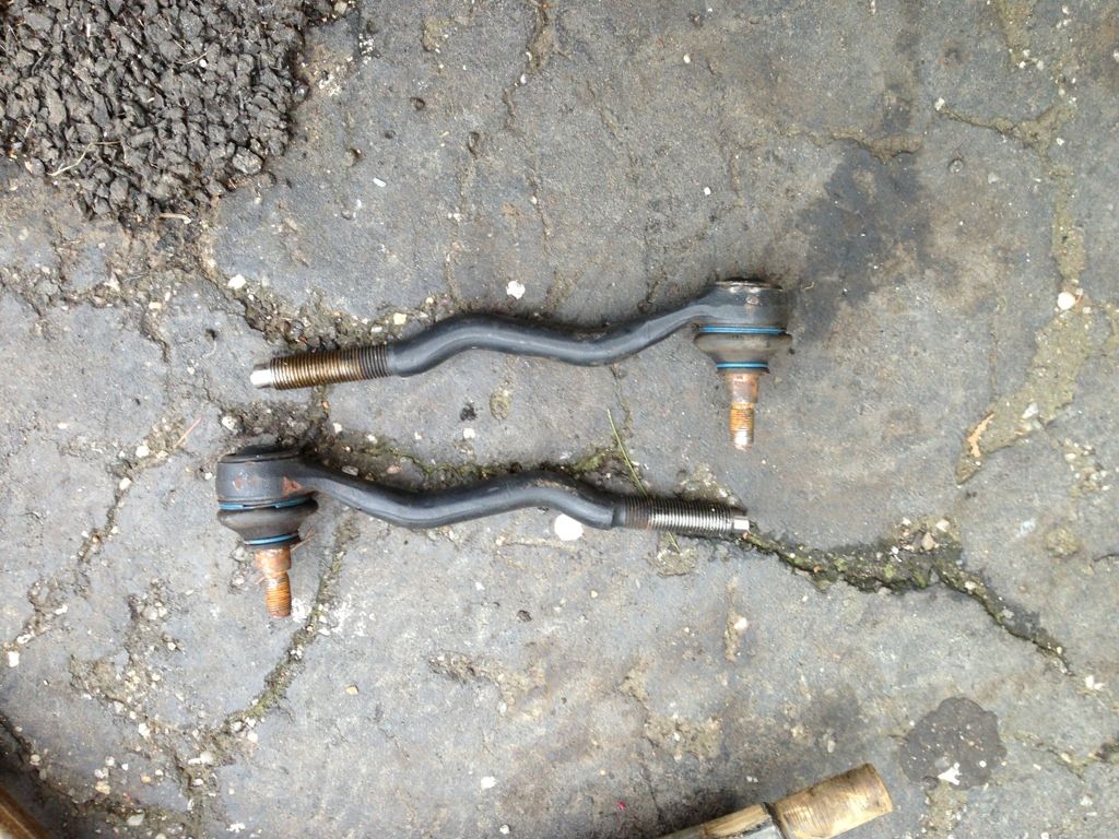

                    The only PITA part of suspension is getting the control arm bolts... which honestly werent even that bad. Everything went relatively smoothly.
                    The old control arms were unbelievable. I knew the passenger side was destroyed cause I was starting to be able to feel it over bumpers pretty noticeably.
                    So now for the "new" parts.... Lots of the suspension parts I have for this car had a couple hundred miles on them from the parts car I had awhile ago for my other m50 swapped car.
                    Control arms(brand new)
                    Tie rod ends
                    The bilsteins which I bought off another member(vinne30) since he went with the gc setup.
                    And the good sway bar end links on the sway bar. I also noticed that the sway bar was once again bigger from the 91 compared to the parts car (an 85 325e) I had by just a couple mms.
                    The car already had some aftermarked CABs which I reused. They are a 2 piece design which I found pretty cool. Not sure what brand they were.
                    And then put them on the new control arms and got the control arms on.
                    Had to break out the re-threading kit I have as I accidentely cross-threaded one of the CAB bolts.

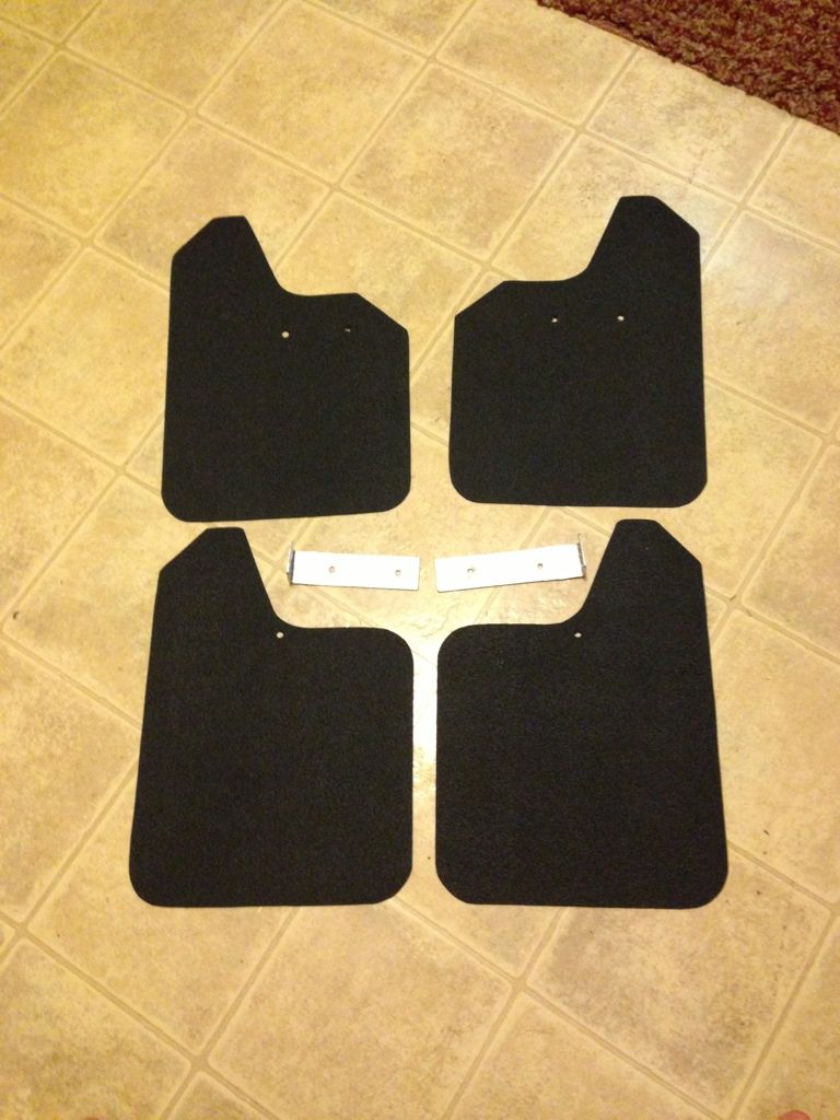

                      Also thanks again to VinniE30 who got me a nice little christmas present. KAMotors rally style mud-flaps.
                      Though they were a gift, im still gonna voice my opinion on them that I they kinda look half-assed for a product that he's making and selling alot of. The brackets are shitily done, though the material that the flaps are made out of looks pretty decent. We'll see how they hold up to this season's mud.

                              They are just mud flaps and they get the job done, if used right they will be thrashed no matter what. They have been proven tough on local rally car e30's.
                                Not the flaps themselves really. Just how they mount. Idk, I'm just scared I might lose one. I'll probably make myself some extra mounting points and some aluminum reinforcements.
