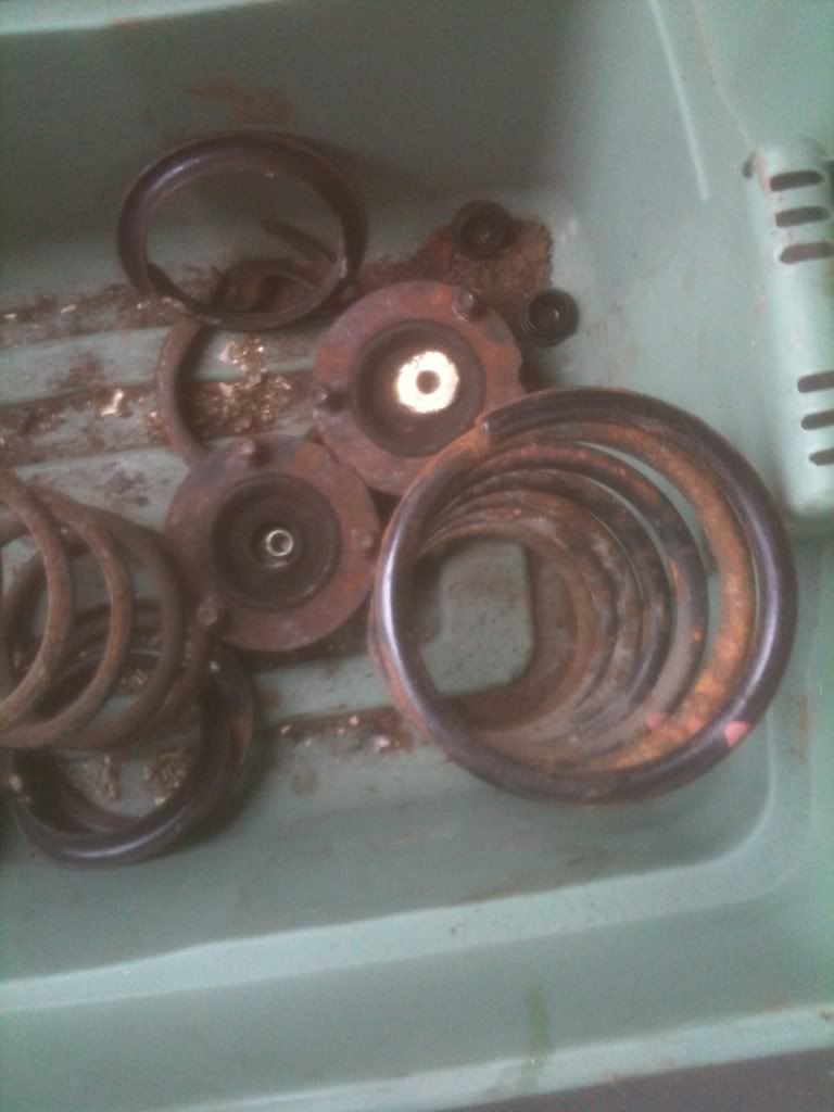

                              Got my strut housings all torn down and started to clean them up, only had a half hour spent on them so far.
                              Front struts were both blown. I have no idea how the PO drove this thing.

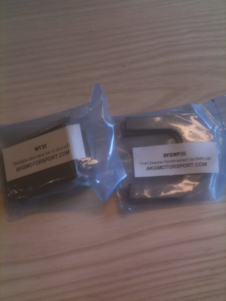

                              Got some loot from the mailman, AKG m3 style sway mounts and sway reinforcement plates. Just waiting for my new endlinks to mock everything up and mark the position for the sway mounts to get them welded. Then I'll be por15'ing them

                                I got my front strut assemblies mocked up and sharpie'd the mounting positions for the M3 style swaybar tabs, getting them welded tomorrow.

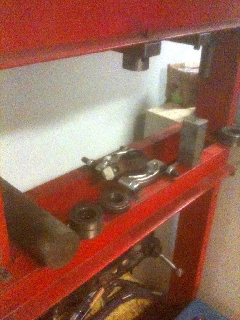

                                Next we shot over to the shop he's working at right now, forgot to snap any pics of the actual shop but they are doing some seriously big work. Most japanese stuff but nothing wrong with seeing 2x 500+ hp skylines get tuned in the same afternoon. While we were there we borrowed the press to push out my old bushings and in with the new m3 offset CAB's.
