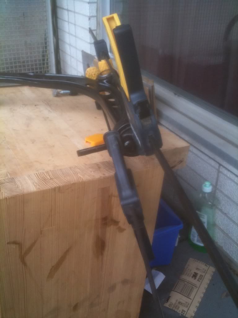

    Did a lot of running around today, had the m3 style strut tabs welded on by a local guy. He did a great job.

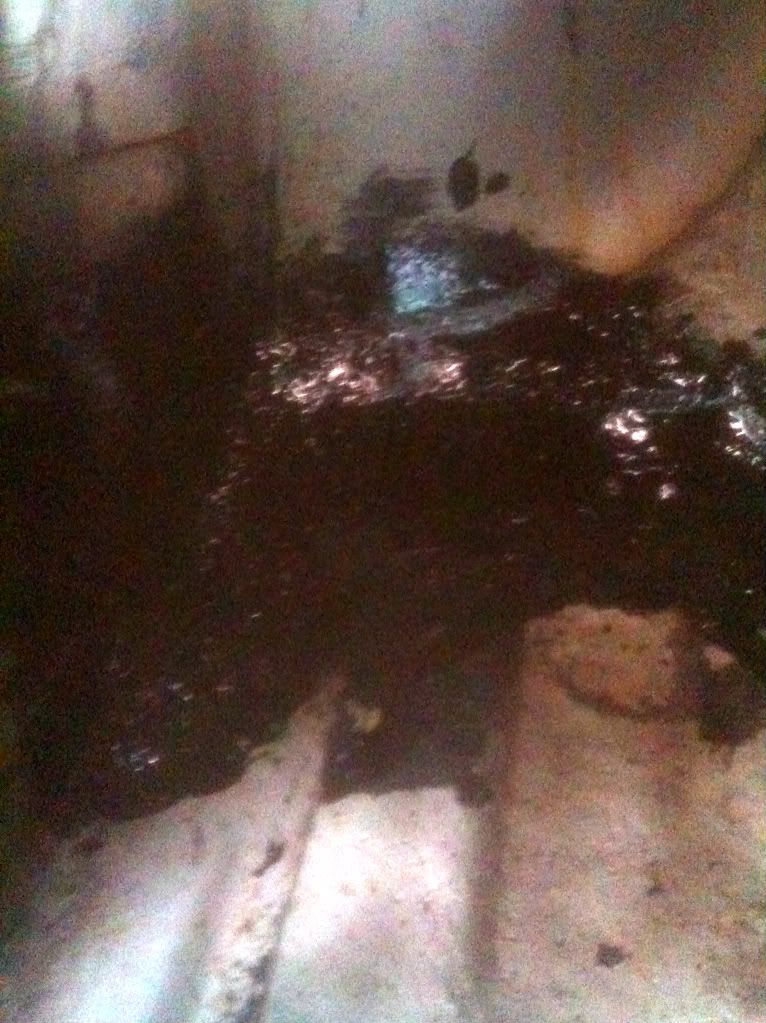

    Then started to paint everything with por-15, first time using this stuff so no idea how it's going to turn out. So far it seems to be covering really well. We'll see how it holds up, I was quick on the prep, as long as it's not rusty i'm happy.

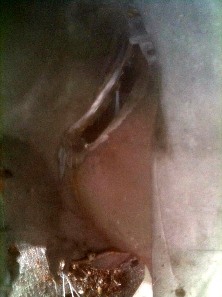

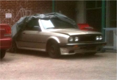

      Decided to tackle some rust today after work. I'll eff that rust up.
      You trying to get cut?

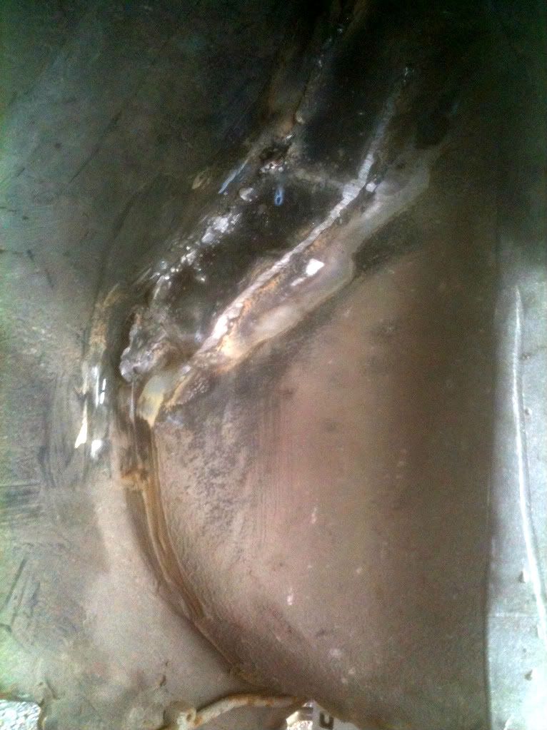

      Heres what I was up against
      Quick trip to the metal shop to cut a couple patches
      Voila, ugly but it's solid again. The fluxcore was burning through the thin sheet of the body really easily, even on lowest and slowest wire feed :(

            Turned out to be a lot of welding, patched 3 holes. Ugly but solid and thats what i'm sticking to. Welded and por15'd, covered with undercoating.
            Interior currently a disaster, but will start putting it all back together once I get my replacement hood cable run.

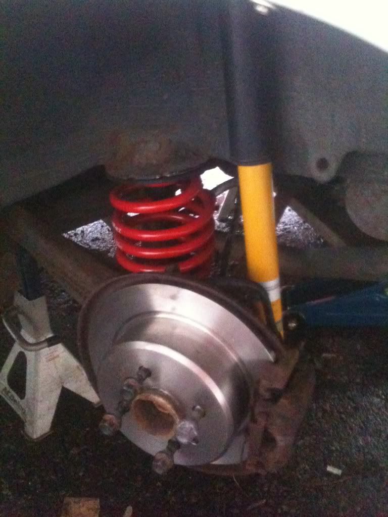

            Now that everything is dry I decided to get the front end of the car back together! I was really nervous about the positioning of my m3 sway bar tabs. I have no idea how anyone pushes the CAB's onto the control arms by hand, if you did, you are a much better man than I. I got it done though, no excuses just figure it out. Woodworker meets machine.
            Just tossed the rotors back on so I could get it on the ground to let the bushings settle.
            And the important picture!
            I'm really stoked with how it turned out. This is exactly where I wanted it in the front, it's like a 1.5 finger gap in the front, 2.5-3 out back. My jack just barely fits under the front crossmember with a mm to spare. Glad it's not any moar low.
            The front sway bar is perfectly horizontal when on the ground, and both of the balljoints on the links are perfectly centred so that was a huge relief.

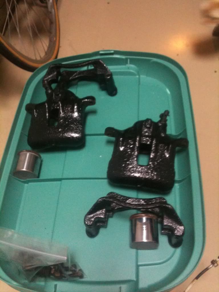

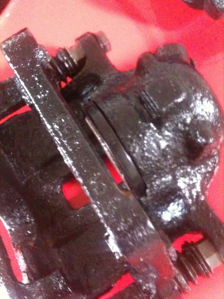

                I'm rebuilding the front calipers, decided to paint them while they were apart.

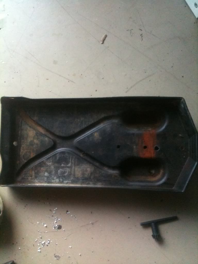

                  Made a quick battery tie down today with some threaded rod, some aluminum and a few nuts / washers.
                  drilled a few holes
                  finished.

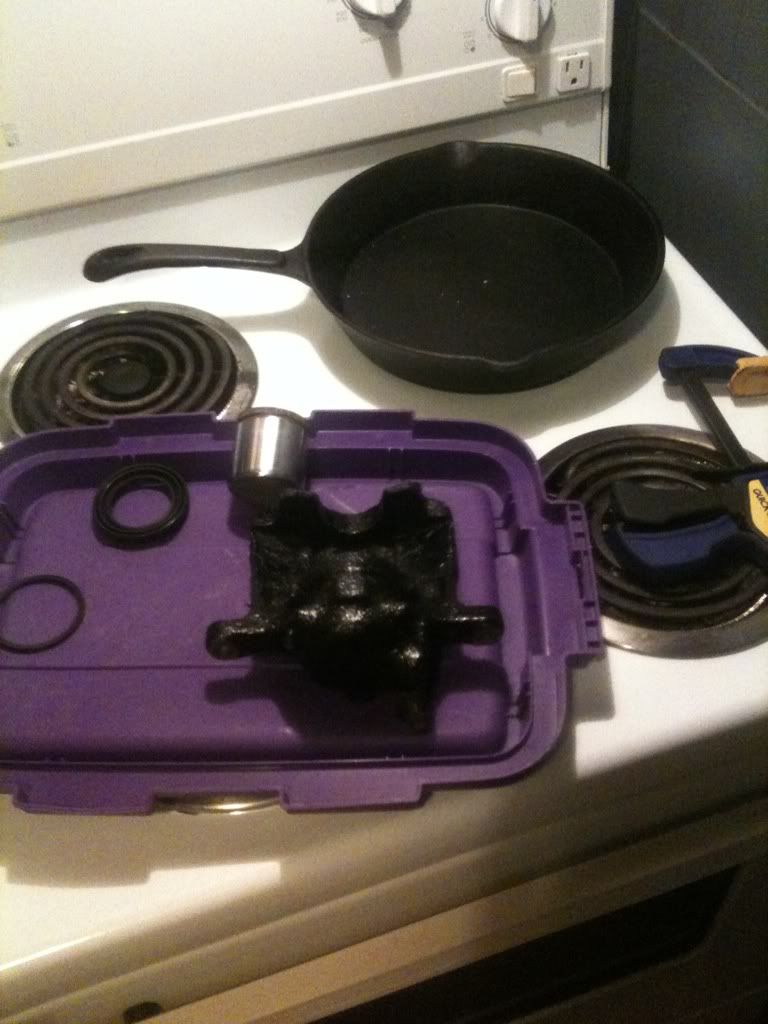

                      Decided to rebuild the front calipers and replace the guide pins and boots because well they were all pretty wrecked. The lighting in my apartment sucks, so at 1am worked the only place with decent light!

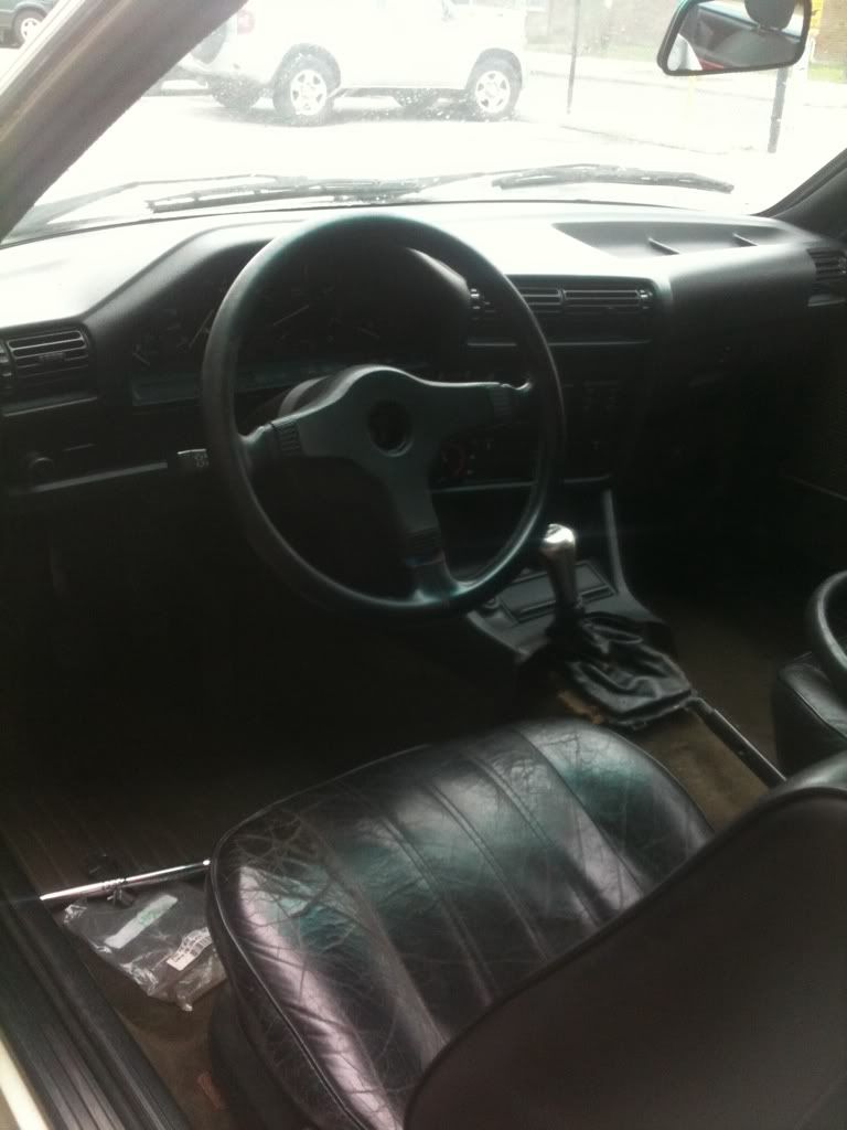

                      Mtech1, seller forgot to include the centre cover so still waiting for that.
                      Needed a shift knob so this will have to do for now, def not my favourite but it will work, unlike the threaded knob which was just placed on top of the shifter rod when i bought the car :hitler:

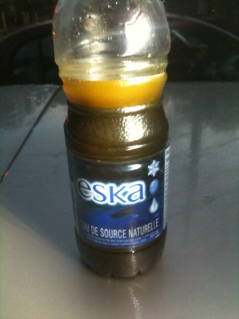

                            Then I bled the brakes. I couldn't believe how terrible the fluid was!!!
