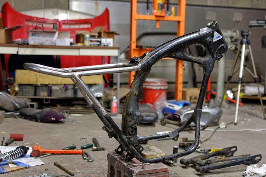

                  Progress on Fiona has been slow. Right now I'm waiting on the new inner barrels for the front wheels to come in. Once I get those I can get the tires mounted and start checking the clearances for the front suspension. In the rear the next step is to take the subframe and trailing arms to the sand blaster (my cabinet isn't big enough) to clean them up so I can weld the camber/toe adjustments on and reinforce everything.
                  I did get some new front tires in a lower profile. They seem to fit much better in the wheel wells.
                  That being said I have been busy in the shop. A few weeks ago my dad and I installed this little beauty, a 2-post, 9000lb lift. I've only used it for a couple weeks and I already can't imagine going back. :
                  At the same time we also got some pallet racking to help get all my extra parts and tools organized and off the floor.
                  I also made some more progress on the bike, stripped it down to the frame so I can get that and the swing arm sandblasted with Fiona's parts. Once that comes back I can make up the new rear shock mounts and work on forming the new seat. I'd like to have it back on the road to get some fall riding in.
