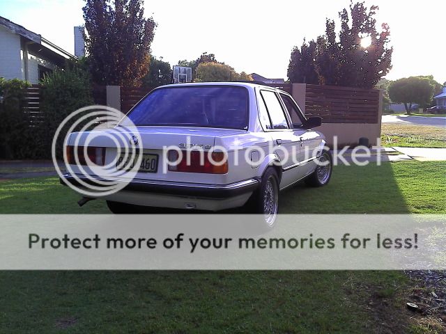

Hey guys,
Heres the build thread for my second e30, the first one became a parts car after it became evident it was truly fubar'd (bent frame, zero previous maintenance ).
Anyway, Alpine four door 325e, autotragic, blue houndstooth comfort interior.

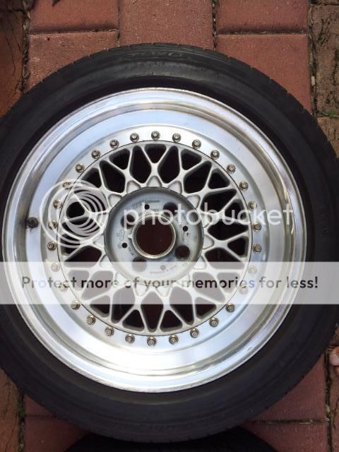

16" BBS came with the first e30... for $200
Pics!!
