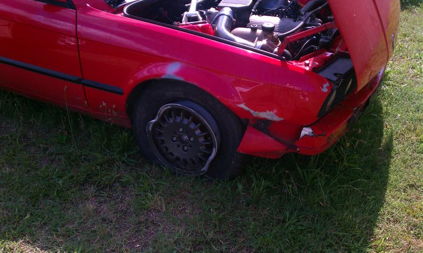

    just for fun this is the "before" pic from my first post.

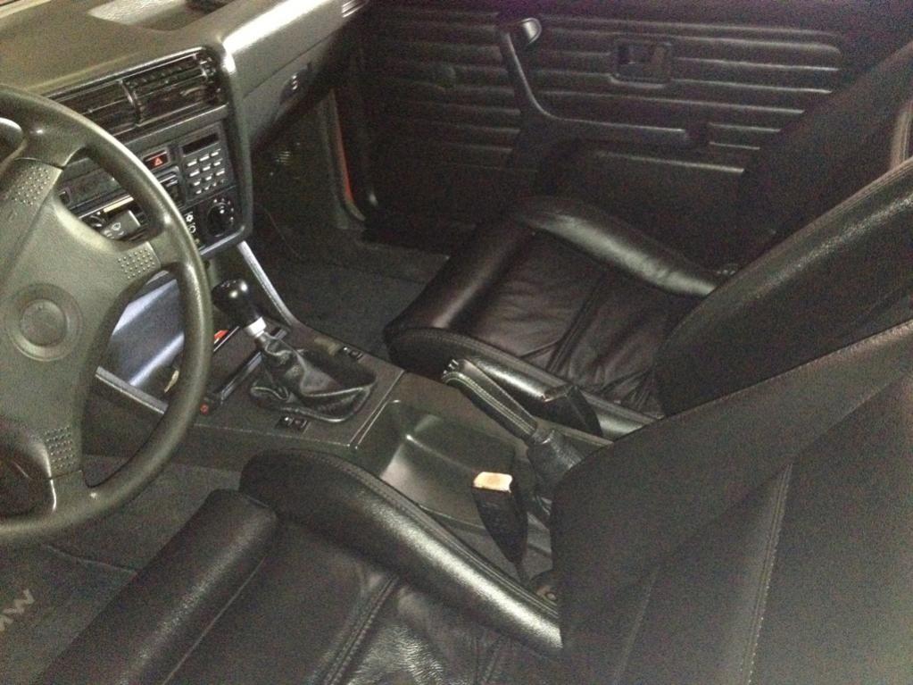

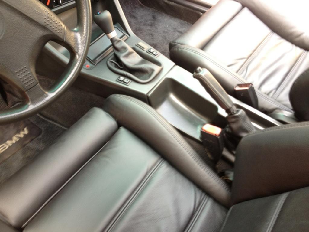

        update - new leather seat covers installed
        Still making progress. New leather seats. Installed a door panel that I got from the junk yard. It used to have tan door panels. I used new clips from the dealer. My locks are still acting up so I ordered a rebuild kit.

          Holy cow! Looks great.
