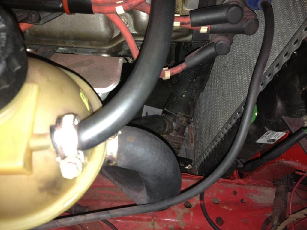

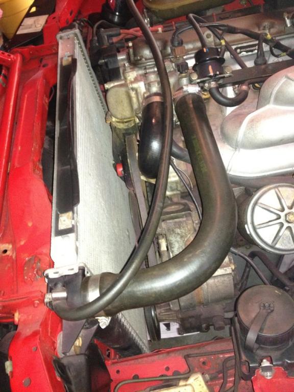

That's a very interesting coolant reservoir setup. Have any pics of how the hoses are routed?
sure, here's how it's routed. That setup was from the po. It seems to cool fine, but it limited me to running a cold air intake because of space. To bleed the system it worked better when I lifted the reservoir up high. No issues with it so far.
