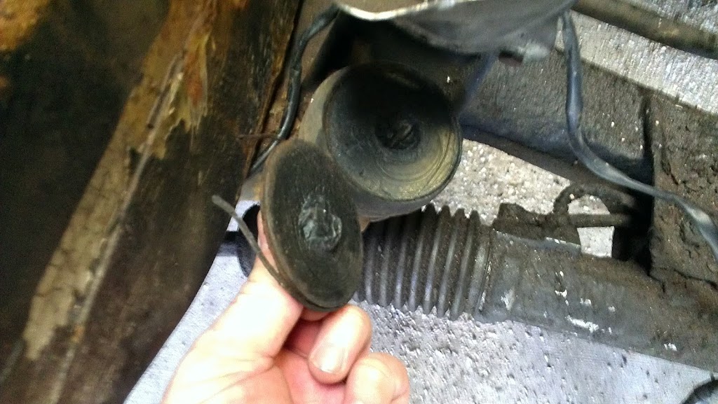

    Getting ready to pull the engine and tranny together, I crawled underneath to disocnnect and unbolt the tranny. I found this:
    Say, isn't that supposed to be connected on BOTH sides?

    After the engine was out, I took a quick look at the mounts. I didn't think I'd want to use them, and looking more closely at the passenger's side one confirmed it:
    This is the passenger's side mount, same side as the broken trans mount bolt. So the engine and tranny were pretty free to rotate that way. Yikes!
