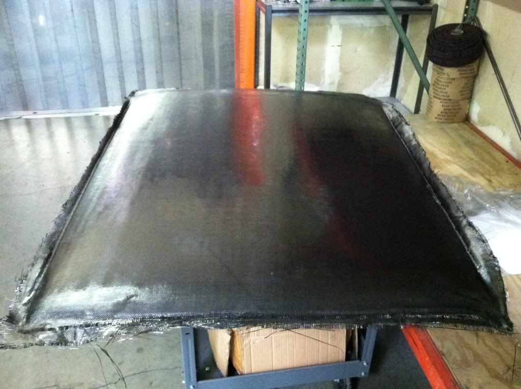

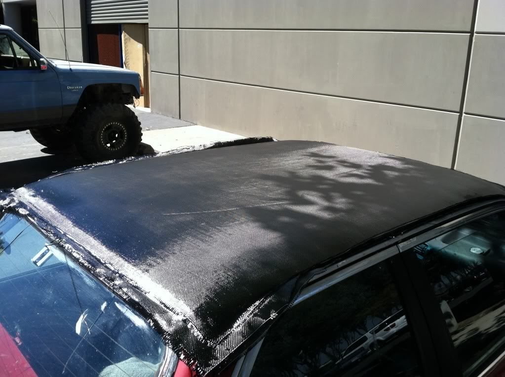

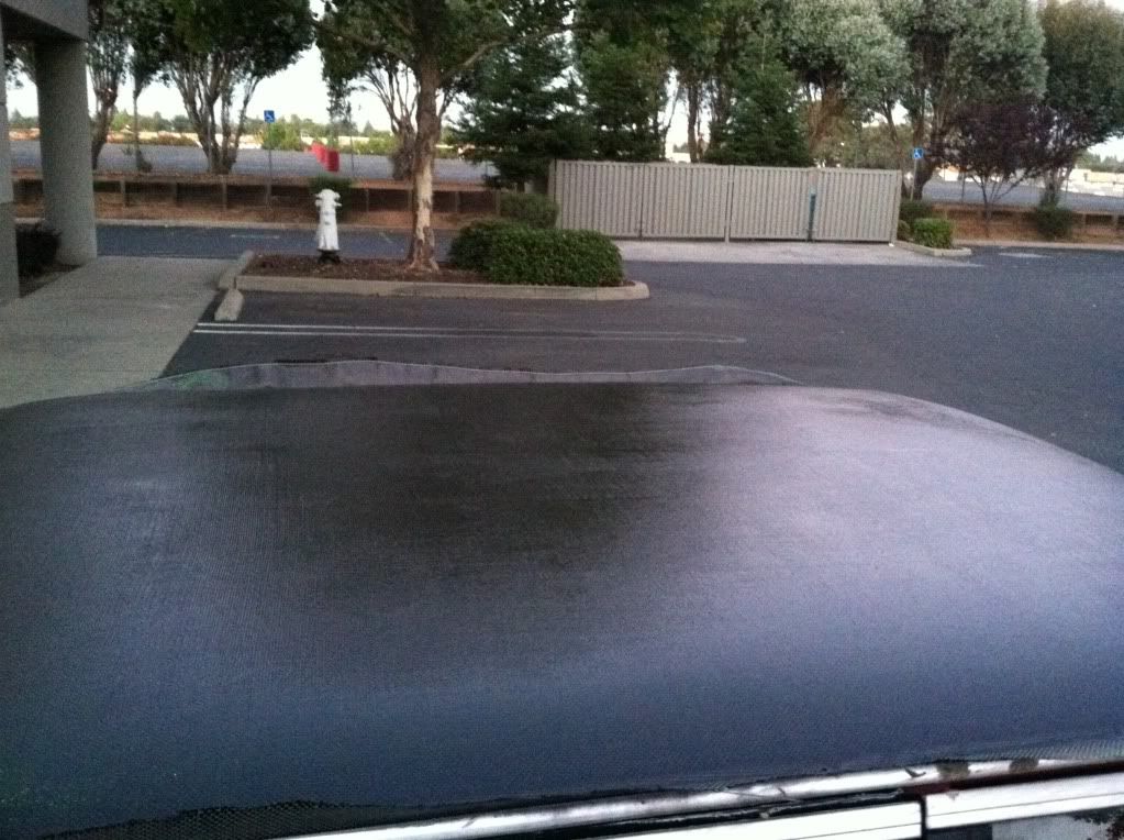

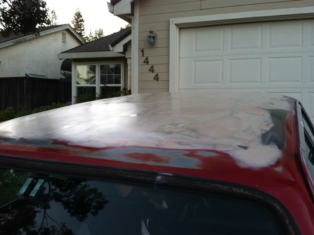

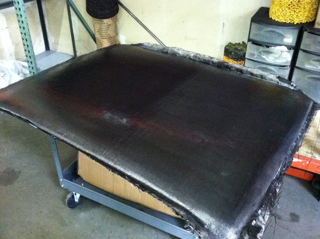

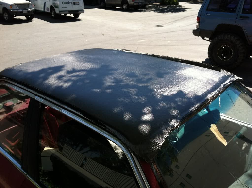

    So new to the whole e30 bmw thing. I generally work with subarus and diesels building turbo setups and everything in between. So this is a semi new thing for me. So I finally bit the bullet and started giving my e30 some attention even though my subaru sti needs it way more. After over a week of adding 3 gallons of bondo to the severly dented roof and sanding it I finally got it ready to be used as a mold/template for the carbon replacement. I will be caging the e30 and will cut off the roof once its ready to be welded and then install the carbon roof once the cage is all done.

                        "After over a week of adding 3 gallons of bondo to the severly dented roof and sanding it I finally got it ready to be used as a mold/template for the carbon replacement."

                          The cage will tie into the chassis so the roof isn't doing that job. As far as carbon supplies I've ordered from different places in the last couple weeks and don't really have a definitive source as this is my first time using composites and I choose a roof to start the learning process.
