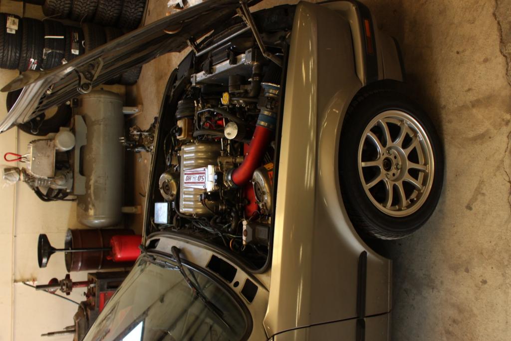

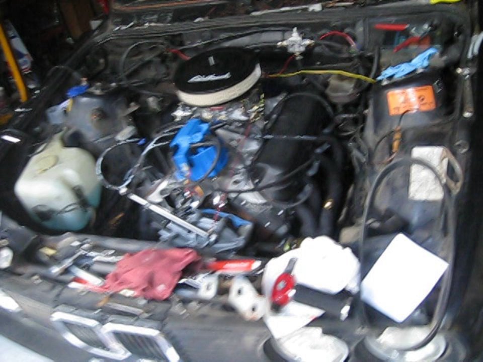

So, picture updates as promised.
Here's a shot of the engine bay as it stands now... nowhere near as clean as it used to be, which kind of upsets me. Oh well. Most of the 'messy look' can be attributed to the heater core hoses... all I had was generic 5/8" hose and without some pre-bent stuff and some mustang heater pipes, it's gonna stay ugly. Something to do in the future... but I'm more focused on getting the car running than aesthetics right now. Hopefully it'll look better once I tuck all the wires.
