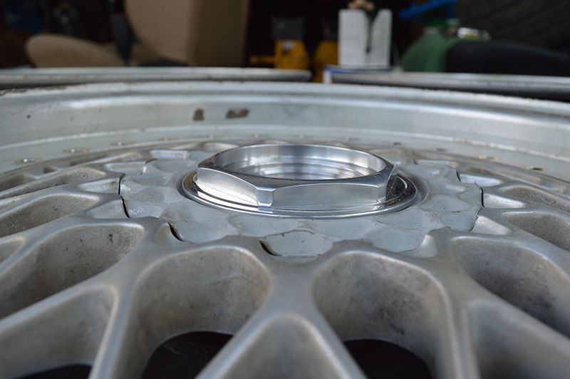

Got the Tires removed form the BBS RS (except one, bead wouldn't budge, so I will cut it off.
Wheel lips for the rear also finally made it from germany.
As well as some 1/4 Height center caps
1/4 Height
VS Full Height
