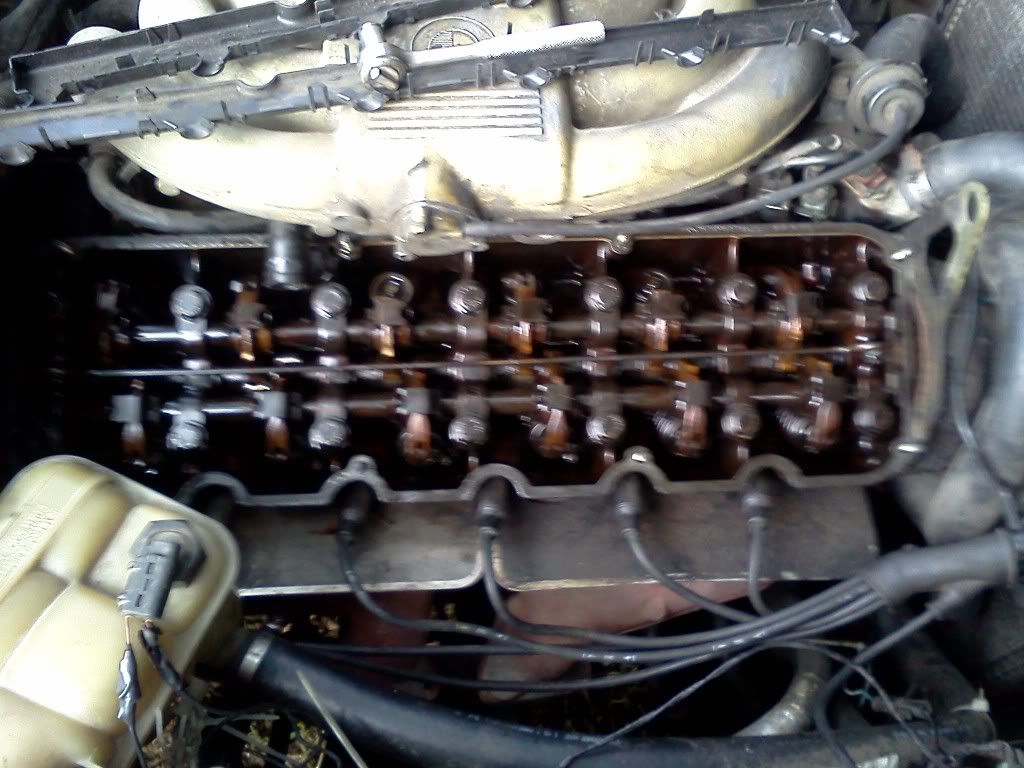

        Well guys.. the shit hits the fan. Pulled off the valve cover today to find this!
        Yup. That's two broken rocker arms. I need some to give some advice. Now lol

              Feeling a little down about not having the car for my wedding tomorrow. But heads is coming off as soon soon as the parts arrive

                Head doesn't need to come off...
                You can r&r the rockers by pulling the radiator and pulling the rocker shafts out through the front. I don't even think the timing belt has to come off

                  im pretty sure you have to have the cam pulley removed to remove the rocker shafts.

                        Do the timing belt ASAP if it wasnt done, if it allready didnt snap.

                              Did some more thinking tonight. I'm gonna go a head and try doing the rocker arms without pulling the head. It would be nice to, but I would rather not risk it. I need to do a coolant flush anyway so pulling the radiator will be a good chance to do that. Also sounds like it gonna be easier. Anyone have a write up?

                                going back on what i said.. started on pulling the head today.. should finish tomorrow night the LOTS of cleaning up till the parts come, then putting everything back together... THEN i can finish cleaning the car up.
