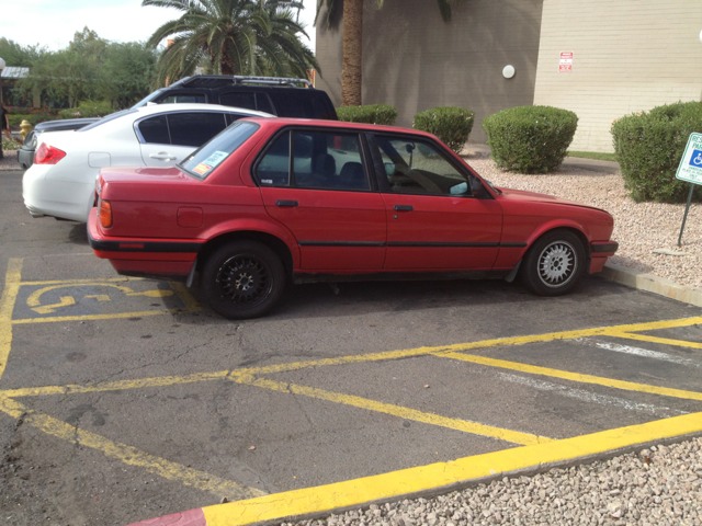

              I put the e36 rear springs in today, def a substantial lift over stock height. Seems to cycle well without drooping the axles to far. Will probably put limit straps in the rear. Here is a quick pic once it was back on the ground

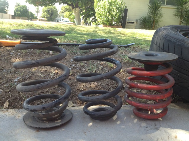

                Here is another pic of the rear springs e36 vs. e30 (vert)edit vs. e30 h&r raceClick image for larger version

                • irish44j
                  • Oct 2011
                  • 2763
                  know what the rate is on the e36 springs? They definitely have thicker coils than the e30 springs...

                  • AZRRC
                    • Sep 2012
                    • 260
                    Idk what the spring rate is, anyone know?

                      • e30polak
                        • Nov 2006
                        • 6136
                        E30 convertible springs are also taller then the coupe springs, and softer spring rate then an e36 spring.
                        Good luck with the project, should be fun!

                        • AZRRC
                          • Sep 2012
                          • 260
                          Edit: that reminded me the stock spring in my photo is a vert spring
