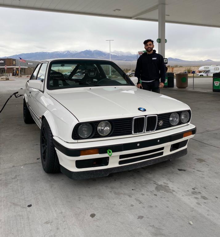

          As you know, I purchased this car from Arthur who had bought it from Simon via Bring A Trailer. It was a wonderful experience and I really regret not getting a chance to meet Simon in SoCal after picking up the car from Arthur in Vegas. I had planned to drive the car back from Vegas to NJ LOL. I flew in from NJ and my friend who would help me with the first leg of the drive flew in from Chicago. We were crunched for time, I had to get back to the East Coast for work and my friend CJ had to get back to school at Purdue for an exam. Prior to flying in Arthur was kind enough to get all season tires on the extra set of wheels he had for the car that I was purchasing also, because the weather in February on the way back was going to be lethal on the slicks that were on the car.

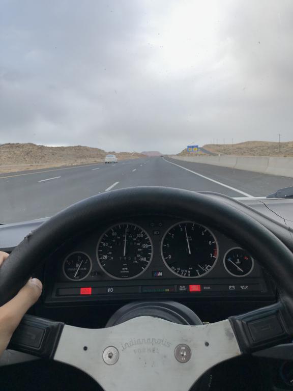

          Our plan was to break up the journey into three 12 hour legs. The Saturday (February 8th, 2020) we got to Vegas we planned to drive the first leg to Denver, the following day to Purdue (West Lafayette, Indiana) where CJ needed to be, and then I would finish the last leg of the journey to NJ on my own, something I had done many times back and forth back when I was a student at Purdue. We completed the first leg of the journey successfully, getting to Denver at around midnight. We had noticed that the coolant temp gauge was not working a few miles into the drive but could hear the fan kicking in occasionally.

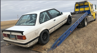

          The following morning, we made it about 100 miles east of Denver before everything began to fall apart. The car first began to smoke, we immediately pulled over, shut the car off and saw coolant had sprayed all over the engine bay. Checked everything, all the lines, oil, hoses, etc and let the car cool off. We could not see anything wrong with the car while on the side of the road. At this point, we wanted to get to the next exit so we could safely examine the car and fix anything if we needed to. We started the car back up, the car ran but was making some weird noises while under throttle, but not even a mile later of gingerly driving even more smoke began to come out from under the hood, into the cabin, and out of the exhaust. We immediately thought, blown head gasket. We were aware from the BaT listing that the valve cover had a slight leak but this was something more than that. We had made it just about 1000 miles.
          After quickly pulling over the second time, almost at the next exit, we got a tow, got the car towed to two garages in the area ( it was pretty much the middle of nowhere). Both couldn't help, so we decided to see if we could get a uhaul and tow the car back. Unfortunately, the only uhaul available without backtracking 200+ miles was a medium box truck, and the only available car transport trailer was 50 miles south. By the time we were able to get everything together and had the car on the trailer it was almost 9 pm. We drove 24 hours straight, taking 6 hour shifts to drive and sleep. We reached Purdue sometime Monday evening. I started early tuesday morning and made it to New Jersey that night. Getting there without any issues would’ve been too easy, 500 miles into the 750 mile final leg, one of the two straps holding the e30 to the trailer had completely torn through, and by the time I reached the shop that was going to be doing the work (German Car Shop in Edison, NJ), who I had called ahead of time to arrange for them to look at the car, the second strap was holding on by no fewer than 4 threads.
