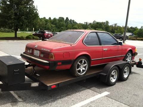

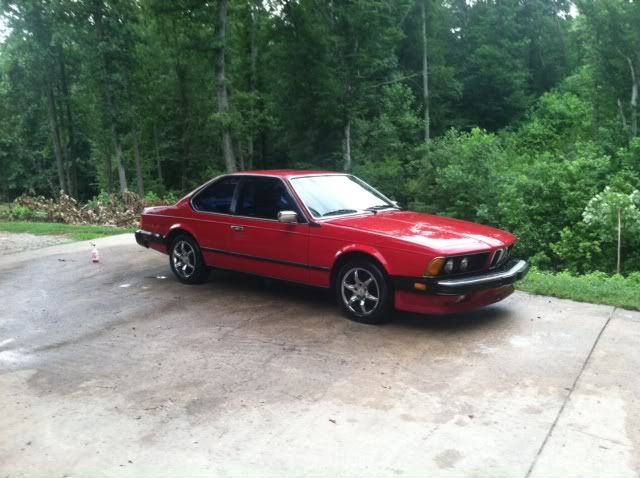

    Life happened and never came across the right e24 when I had the cash or when circumstances were right. Then, one evening sitting on the porch, drinking my Canadian Mist and perusing CL, I came across an interesting ad. One owner Texas car, e24, clean interior, good paint, bad motor. Well, as luck would have it, I had a spare m30 sitting, waiting to go into an e30. A deal was struck and she was mine. This is how she looked.

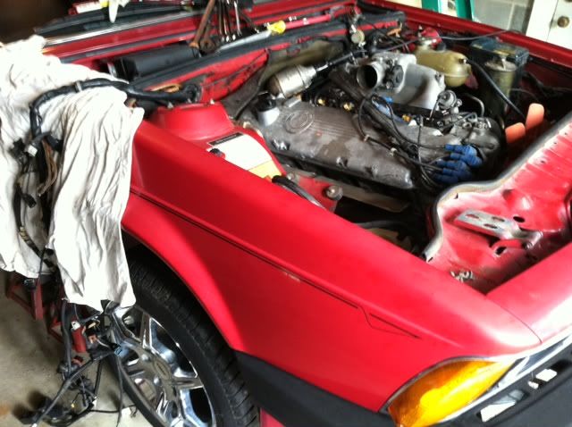

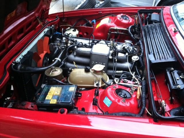

    After getting her home, A buddy and I started to prep the engine bay to swap out the m30. Turns out, the old motor had a bent valve and a broken rocker arm but only 125k miles. This one will get rebuilt and possibly find its way into my e21, maybe.

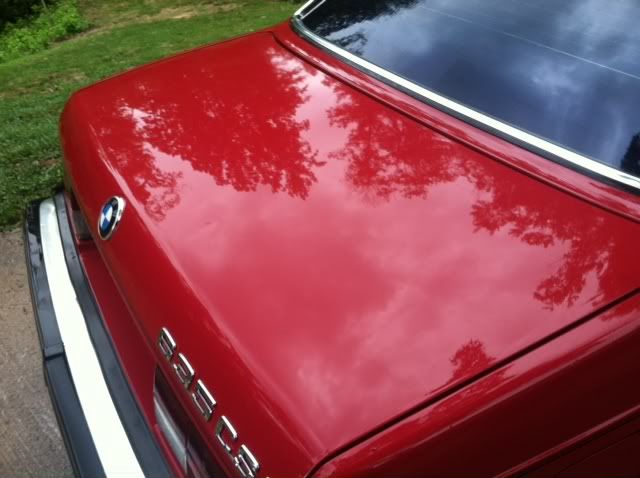

    A quick cleaning and this was the result.

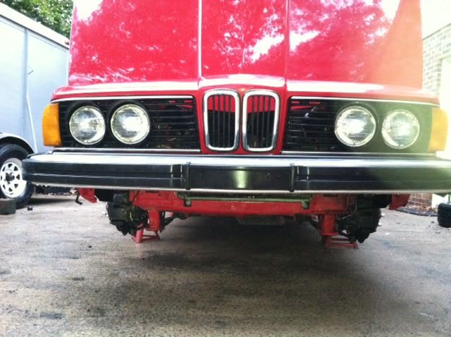

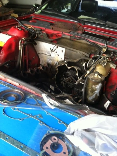

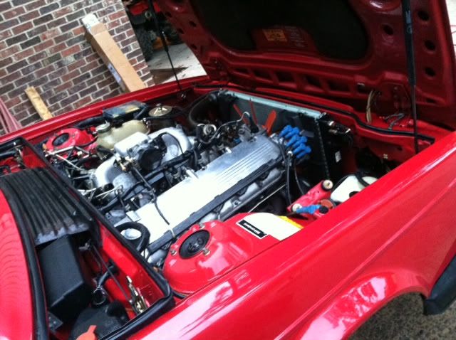

    Then out with the old
    Then I started building my coilovers. I used billys in the rear, and shortened the strut housings one inch to accommodate e30 front struts (thanks Slammin!). I am using universal sleeves and 6" springs. 385 lbs in the front and 325 in the rear. I have a few springs to play with but that is where I am starting.

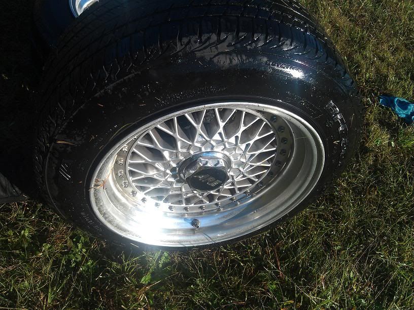

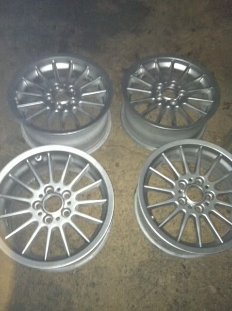

    Then I picked up a couple sets of wheels. 17" Style 32's, can't go wrong with them, and some A.R.E. 16x10s. I am a little concerned that the A.R.E.s will look to small but I am open to opinions.
    Today we begin hooking up the harness and cleaning the tank out and getting her running. My buddy is working on that while I dive into the suspension. I will keep you guys posted on whats up.

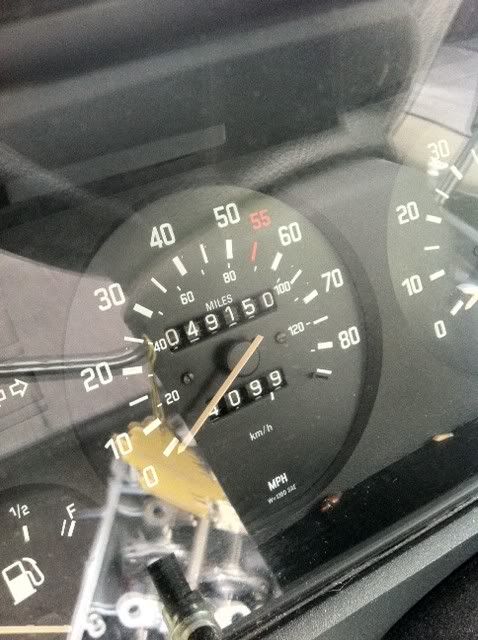

    Yes, original miles.

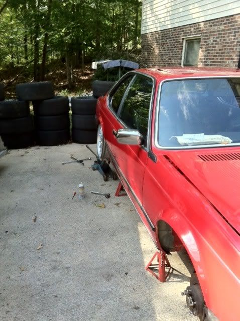

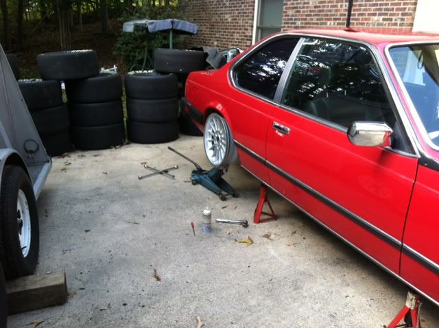

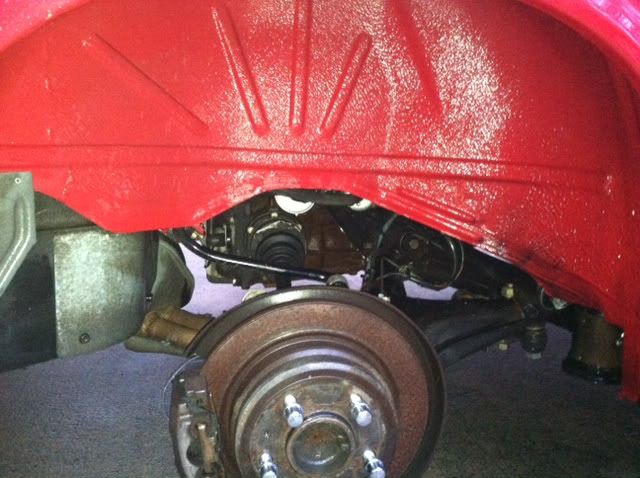

          So yesterday we were able to get the car on jack stands, old awesome wheels off, and removed the rear suspension. The plan was to have the rear coils on but the top nut on the oem shocks was fine thread and the billys were not.. So.. I hit true value on the way into the office this morning and we are good to go. Should have them on this evening and the rear mocked up with the style 32's. Also did a little cleaning while we were in there. Original plan was to paint the wheel wells black but this is what happened after a little degreaser and pressure washing..
          Also got the motor wired, plummed, and cleaned..

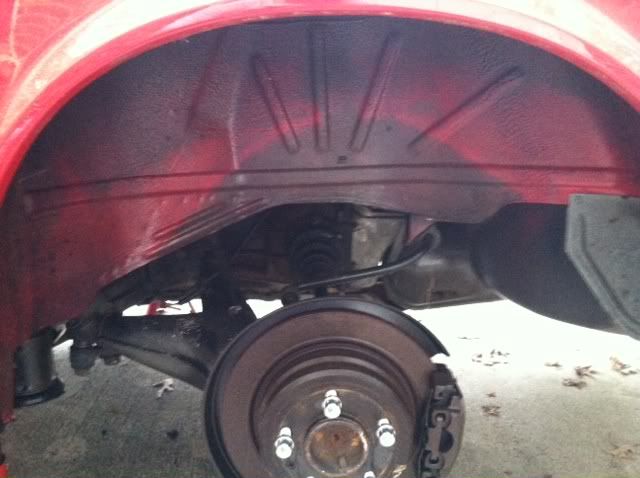

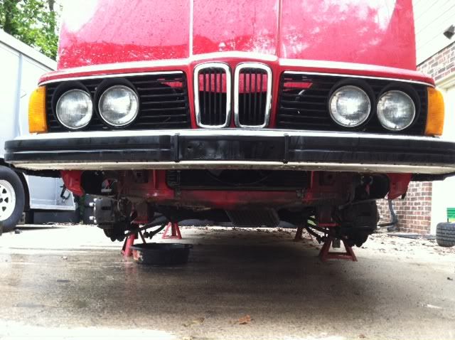

                            Rear suspension is done.
                            This is with the rear suspension unloaded. I expect to be tucking wheel in the rear once it is off the jackstands.
