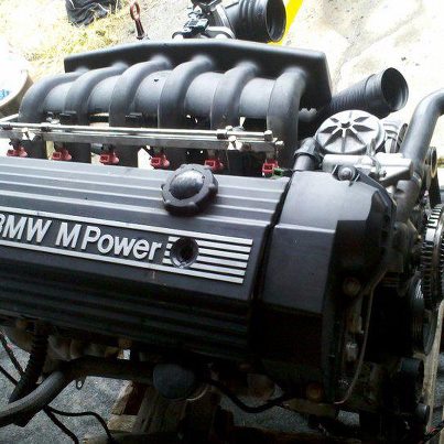

    So I picked up a 1999 S52 out of a Automatic convertible with 130k.
    Iv started ordering swap parts
    Im going to use a 260 trans
    24v 260 trans brace
    e21trans mounts
    AKG harness and motor mounts
    ebay headers
    E30/E36 Eyeball Arms - Control Arm Bushing Set
    Billy sport with H&R race spring with E90 drop hats
    KAMOTORs Cold Air Intake
    Euro smiles
    technique sway bar kit
    Im driving up to seattle to pick up 260 and 325 driveline,flywheel and selector rod.
    I still need to pick up a E34 oil pan and OBD1 harness and Intake.
    All the parts should be arriving next week
    Let have some fun!

    S52 looks to be in nice shape. What did you pay for it?
        2140 delivered!

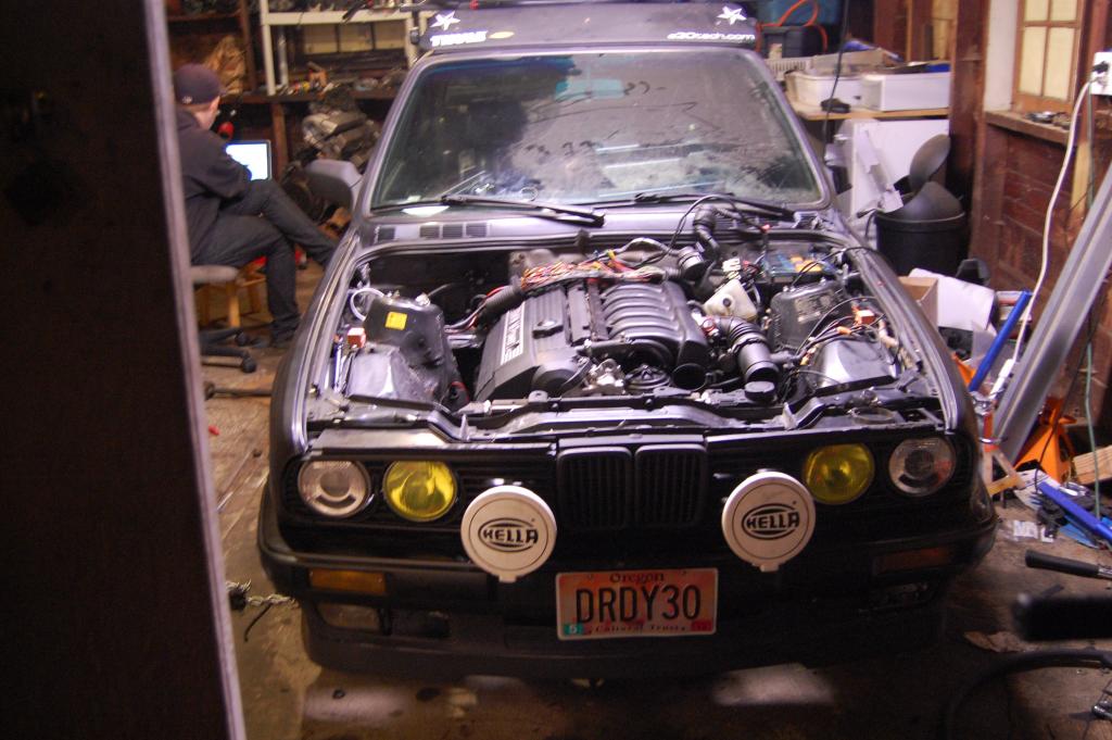

                        Its Been a little while but between waiting on parts and running into minor issues, I have the S52 with M50 Manifold converted to OBD1 back together and harness hooked up. Motor should be in and will try to start it tomorrow.

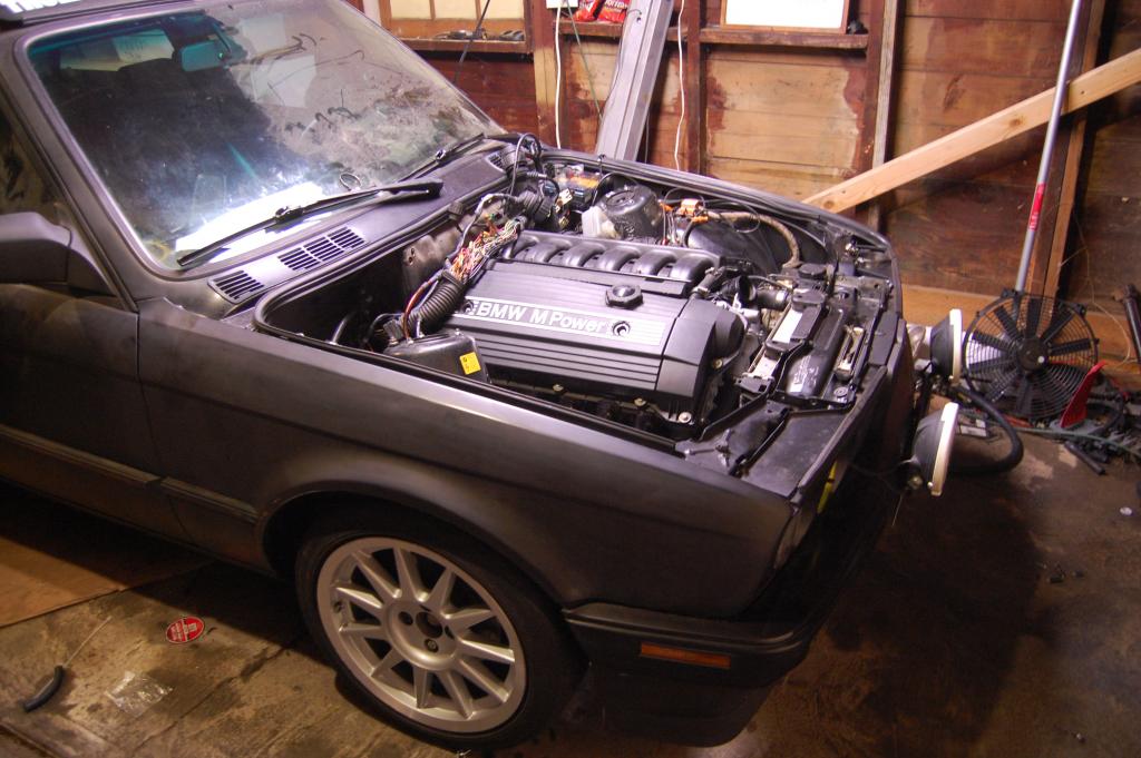

                          Finally got the motor in today and bolted up!
                          Im going to ad Fluids in tomorrow and Fire her UP!
