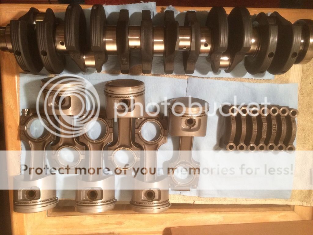

          On to the photos. I think all I really managed to accomplish was sort out the nitty gritty of the engine build.
          Cleaned (and I mean ca-LEANED!) everything. Like 4 times.
          Honed block
          Crank machined .25mm -----Shout out to George at Industrial Machine, Santa Rosa. Measurements were dialed :up:
          Head decked
          In process of replacing valve guides.
          Zero effing around...except it's getting assembled next to my bed...
          Other engine related purchases include:
          Early model +.25 main bearings. Christ, if you're rebuilding an M20, get a late one.
          Ireland Engineering windage tray
          ARP main and rod bolts/studs
          Total Seal piston rings. I mean, with a name like that...
          New intake and exhaust studs
          Good friend Nick traded me some long tube headers
          New coolant plugs (whatever)
          Here's a few photos of the process:

          Clean crank case
          [IMG][/IMG]

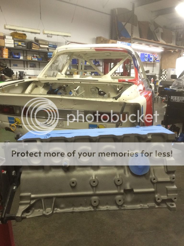

          This is when I was checking crank tolerances in front of the Spanish Touring Car Championship winning M3. Some spiritual E30 vibes going on for sure.
          [IMG][/IMG]

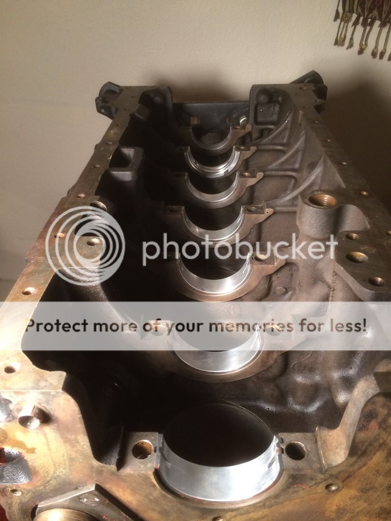

          My super clean bottom end. ;D
          [IMG][/IMG]

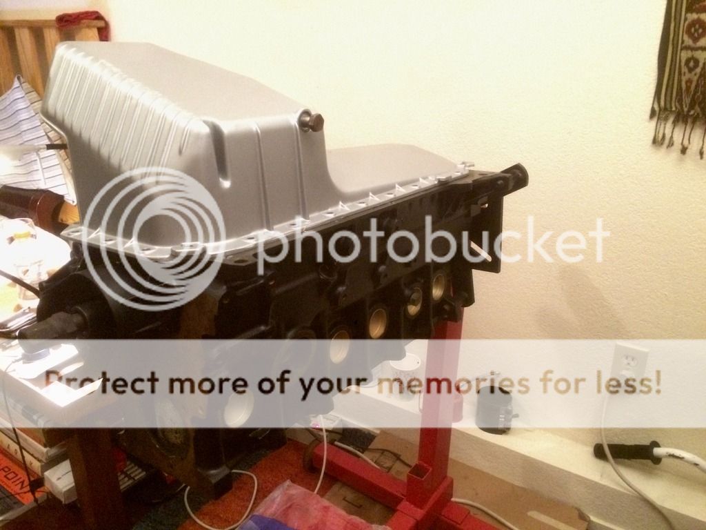

          I am still in process of painting everything that goes on the block the same semi gloss black. This is a shot with the oil pan mocked. I went with silver for superior oil leak identification capabilities and plus I mean, it looks really awesome.

          Bottom end torqued with one billion dollars in nuts and bolts
          [IMG][/IMG]
          Pistons and what not on the flip side
          [IMG][/IMG]

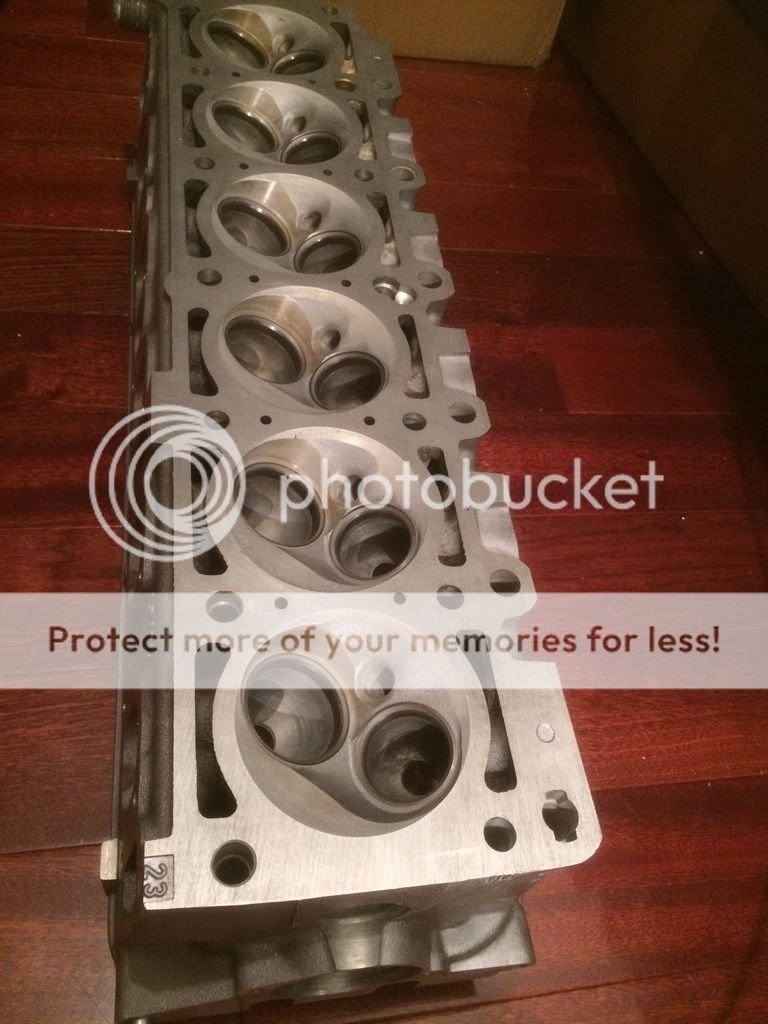

          Moving on to the head. A quick shot of the new deck.
          [IMG][/IMG]
          And I took this shot right after butt-clenchingly removing the valve guides. Which was just the butt-clench warm up round for installation.
          [IMG][/IMG]

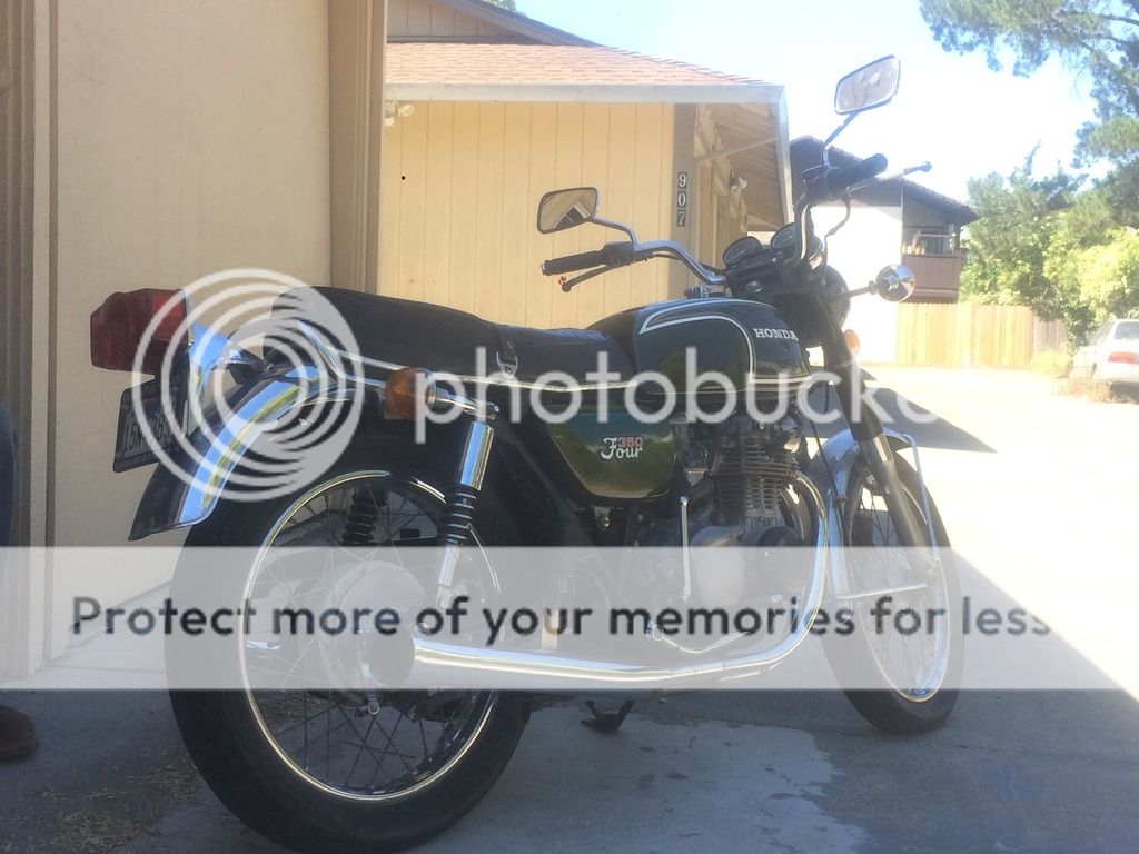

          Other petrol related things going on for those of you into motorcycles, I just picked up a 1973 Honda CB350F for a deal. Planning on tinkering with it and getting it running like a top, which it already does, so I think I'll just ride it. It's my first bike so I look forward to to its simplicity and easy learning curve. It makes an E30 look like a Porsche 918 in terms of complexity.
          [IMG][/IMG]

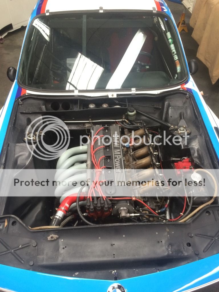

          As per usual I will end this post with the best photo I took since the last one. This is a shot of the bay of (one of) Hans Stuck's IMSA 3.5 CSL's, known as "Chassis 987" on which an S38 head has been retro fitted to an M88 block. Go shit your pants like I did when I found out it makes somewhere between 5 and 6 hundo horses. Extra shout out to Bill for figuring that out. It's been an honor and a pleasure to be near these cars.
          [IMG][/IMG]
