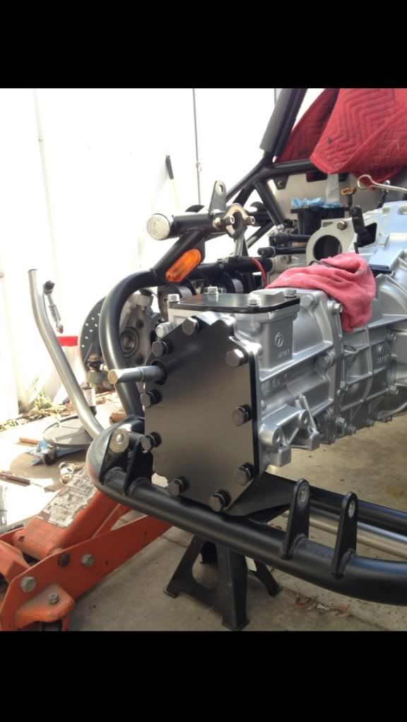

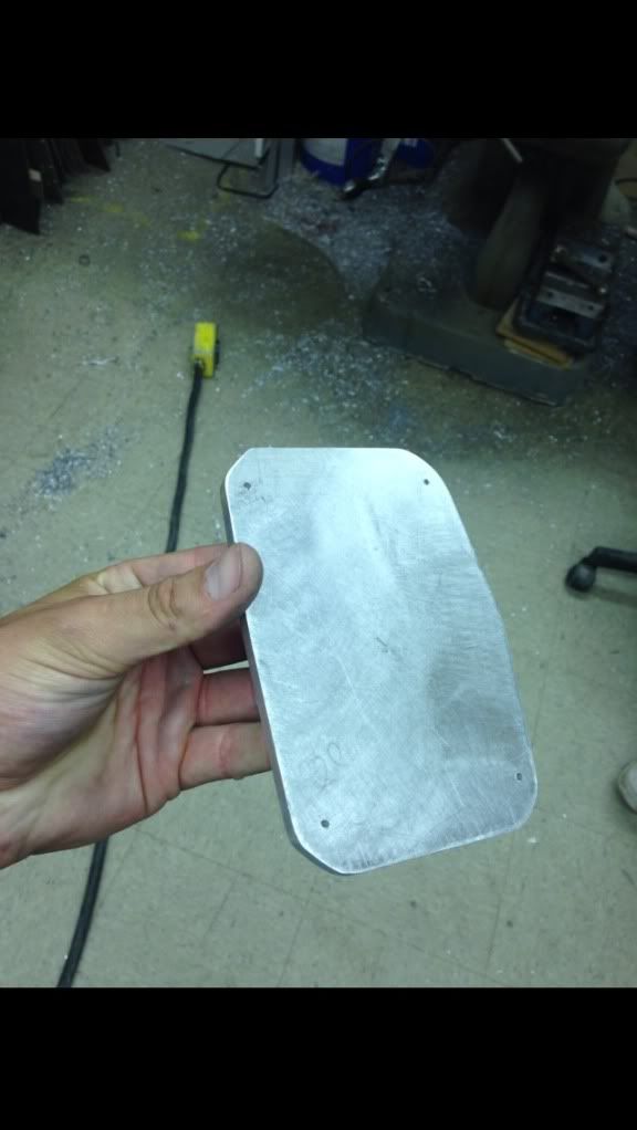

                          Because we converted this to a permanent FWD transmission (RWD for our purposes) we needed a block off plate for the rear of the trans. So I built one out of some 3/8" aluminum and powder coated it black. I also made the other block off plate on the top of the trans (the stock one has a huge hole in it) and did that in black as well.
                          This is the top plate:
                          And here's both of them

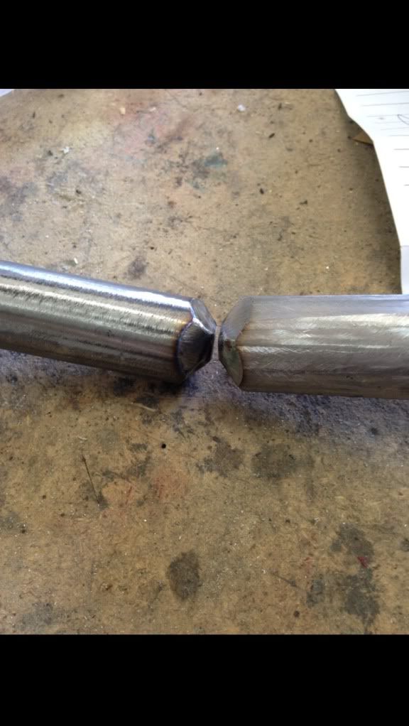

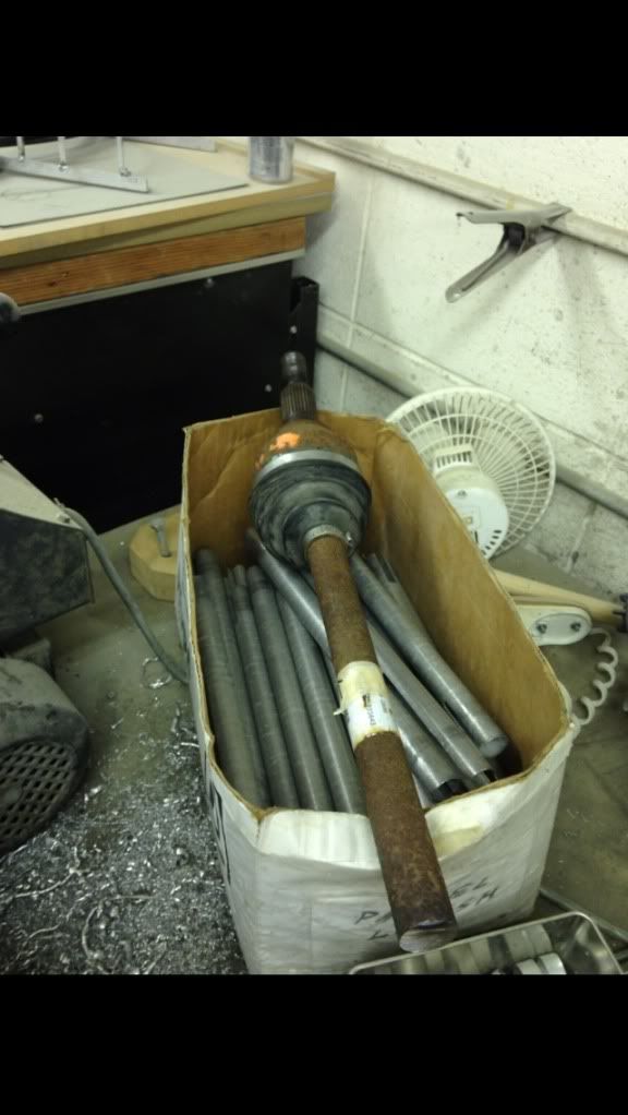

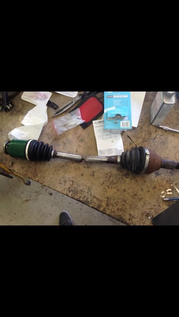

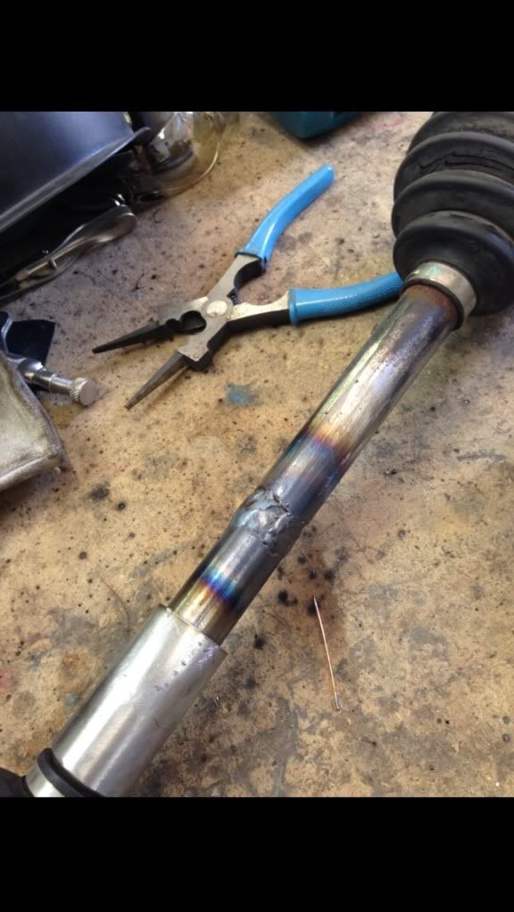

                          We also got started on the axles today. Pontiac--->Subaru.
                          Test fitting/measuring
                          Cut and beveled. Ready for weld. Don't forget the sleeve!!

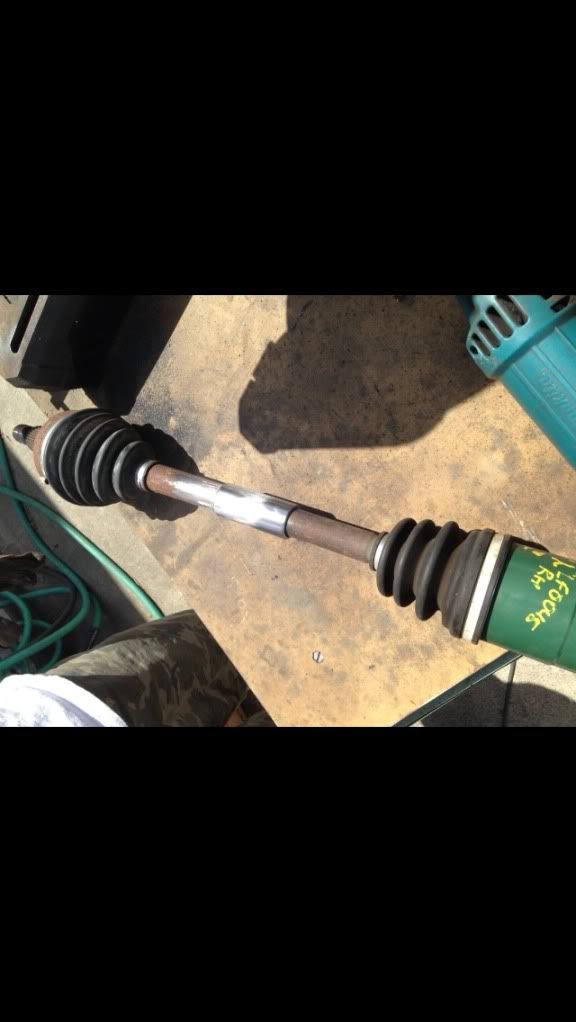

                          Jigged up

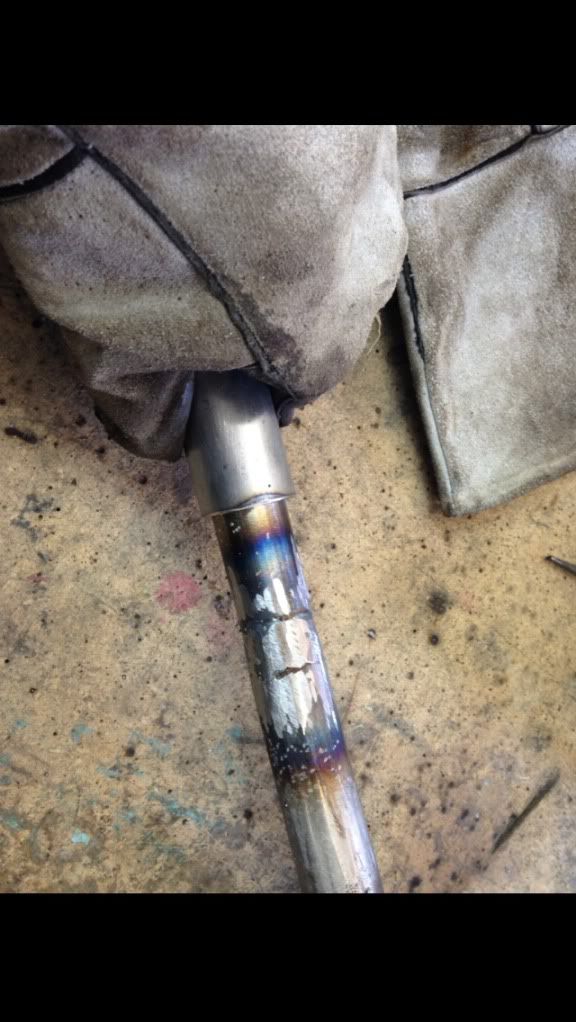

                          Welded/ground. Sleeve will be welded tomorrow.
                          We are hoping these welds will hold. The sleeve should help immensely as well.

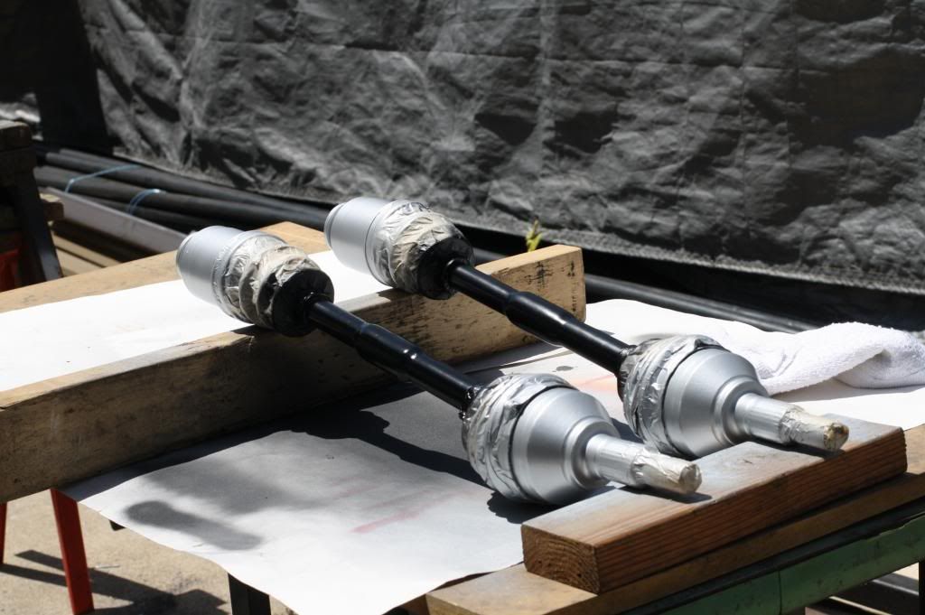

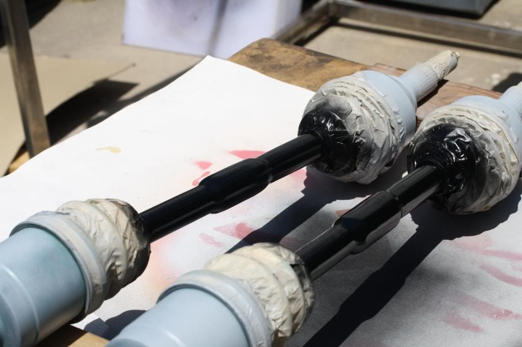

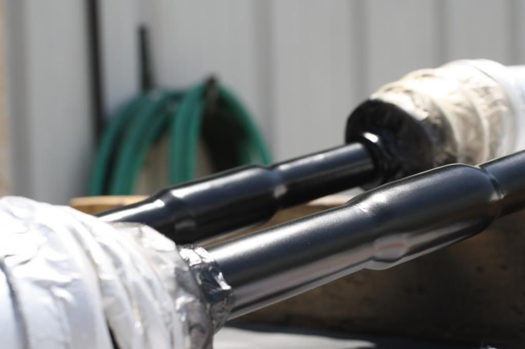

                            Got some more work done on the axles today. They are finished except for a strip of different colored paint so we can tell if the axles twist at all.
                            Rust deletion
                            All sanded and prettied up. Self etching primer time
                            Painted the middle black and the ends silver.
