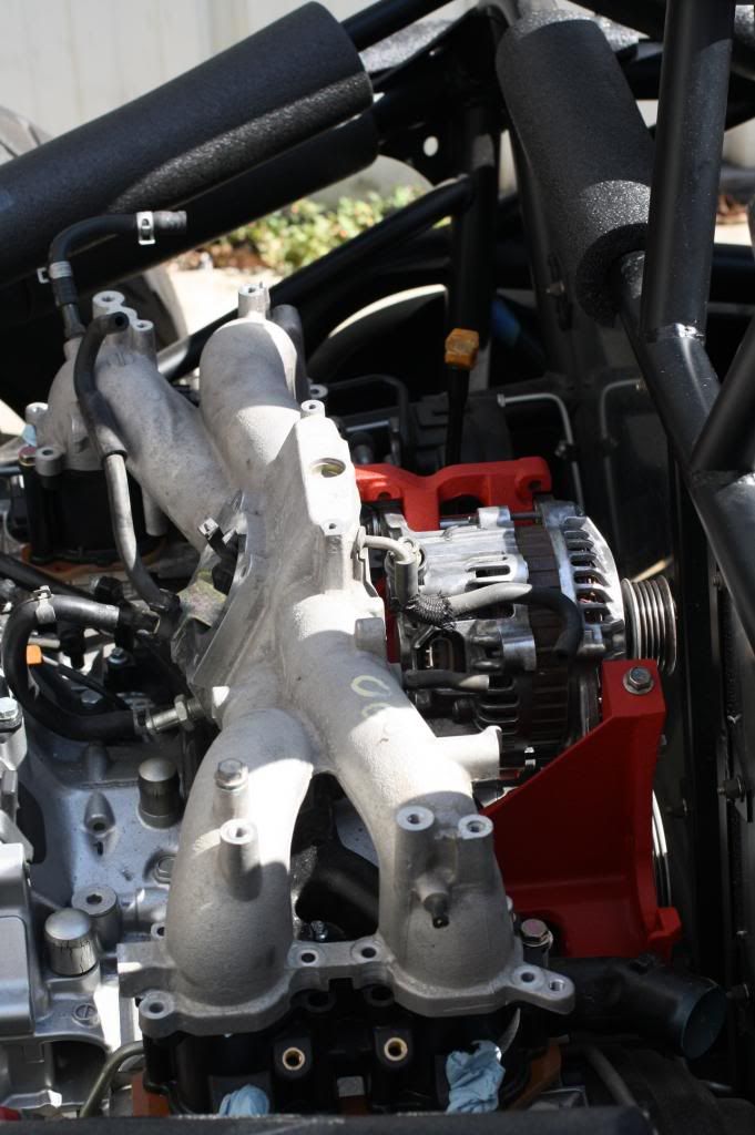

          Got some updates over the past few weekends. We have been out of town so not much has gotten done but here's some pics for you guys

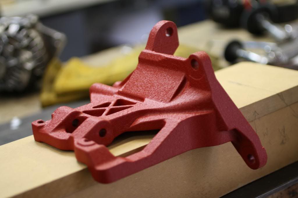

          Got an alternator and cleaned it up a bit. Powdercoated the brackets that came off of our spare EJ20 engine wrinkle red. Turned out very nice

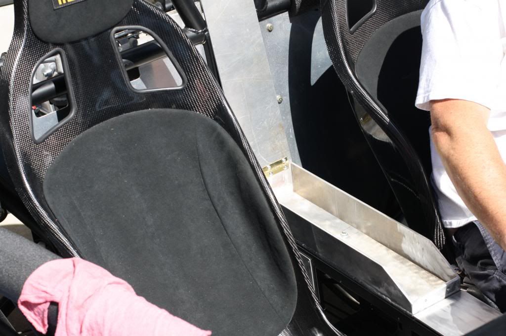

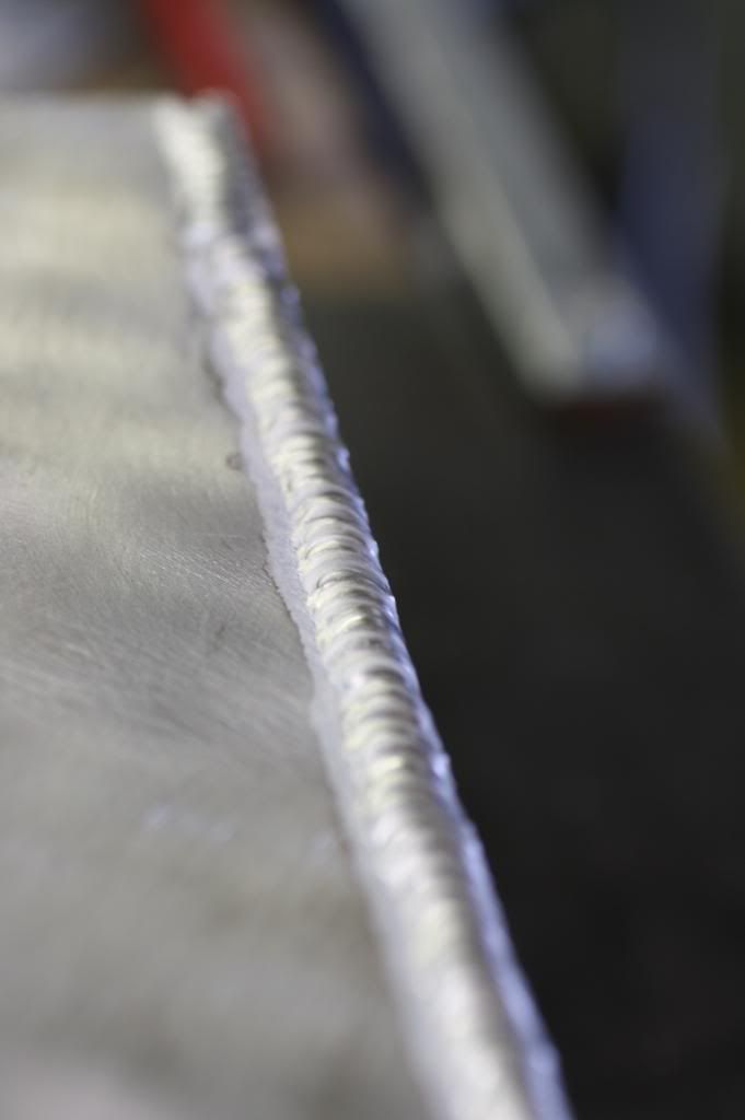

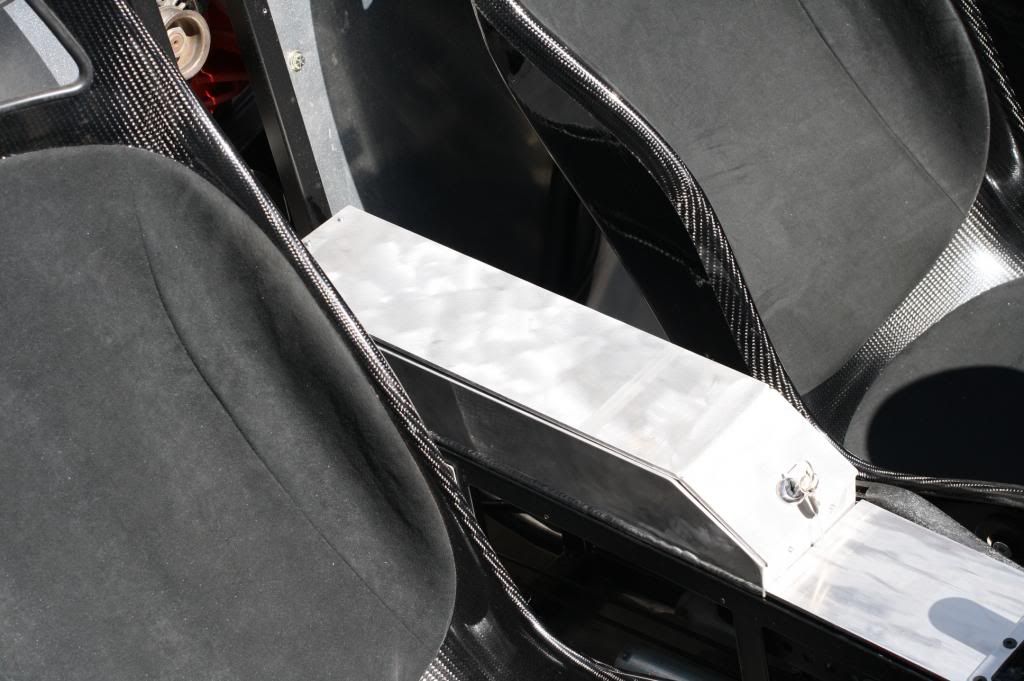

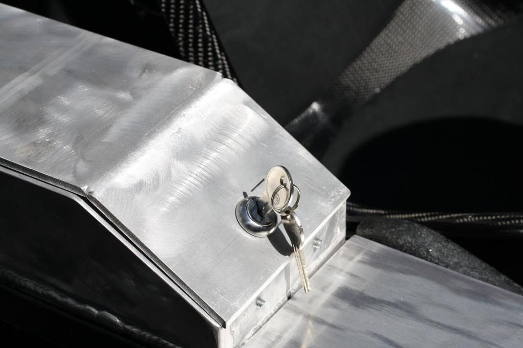

          I built a locking glove box. It turned out pretty nice. We will be leather/foam wrapping it so it will have some cushion to it.. First time welding 3/16" aluminum. Still learning!
          The hinge in the rear is a piano style hinge
          It isn't aligned yet. We need some brackets that hold it in place but this is where the lock is placed. The screws will be ground down flush.

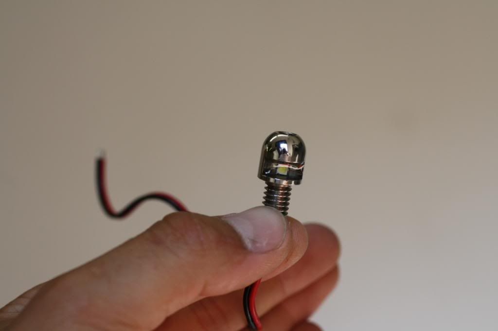

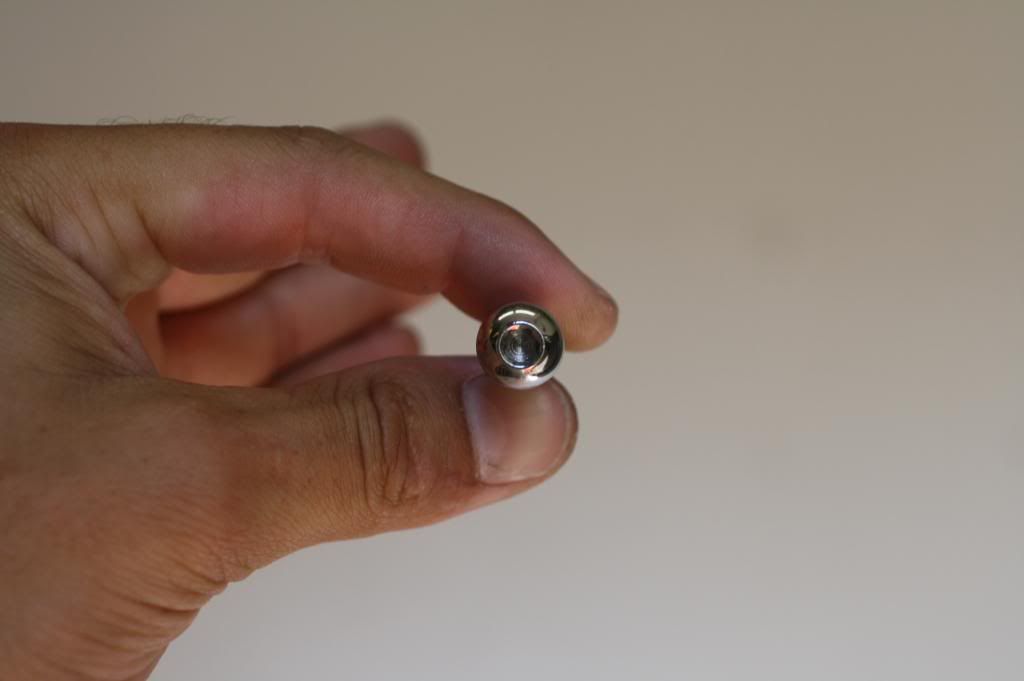

          Also got some license plate bolts......
          Built in plate lights!

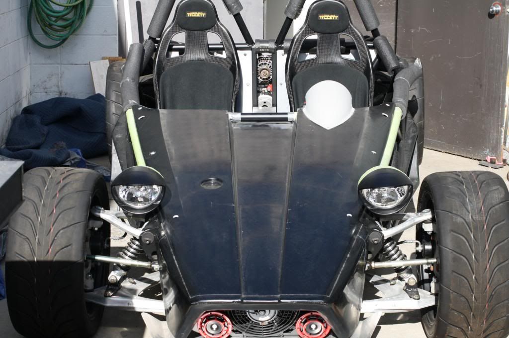

          We also got the headlights mounted and the front mirrors/turn signals mounted. I forgot to snap some pics but I'll try and get some this week!

                How do you ensure the bolts are both tight and aligned properly to illuminate the plate?
                    It doesn't thread into the frame. There is a plastic nut that keeps everything tight

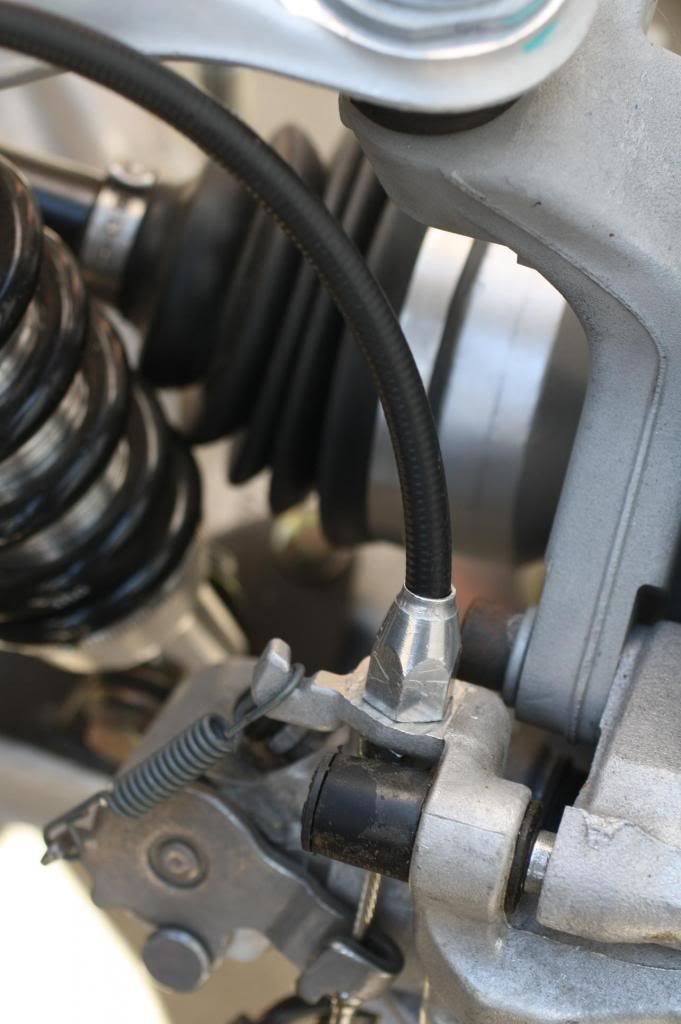

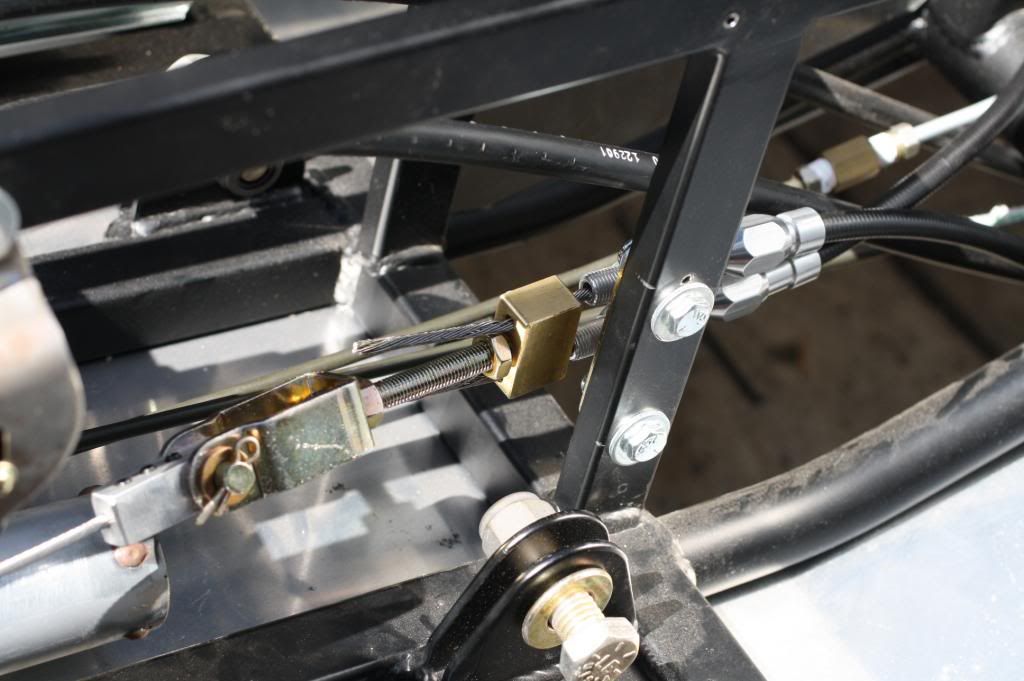

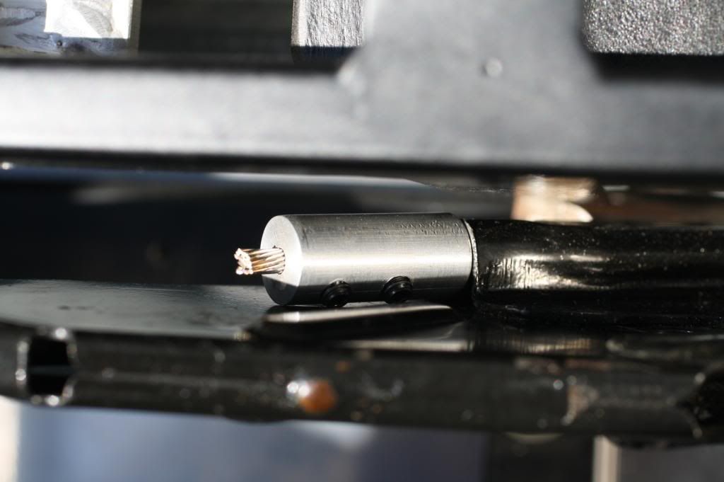

                        Finished the parking brake today. Made some of these clamps for the cable.
                        Cable at the e-brake handle
                        Here's how the cable attaches to the caliper
                        Pic of linkage

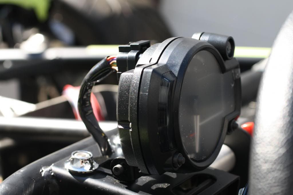

                        Cluster is mounted.

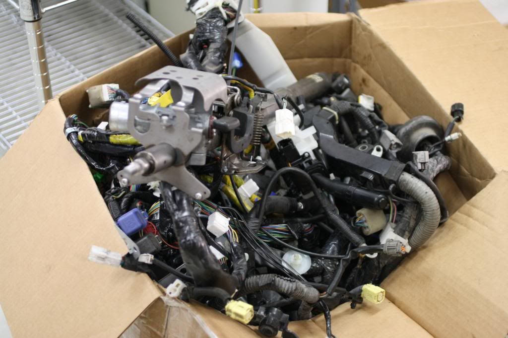

                        And here's a box of.....????
                        Engine harness.....

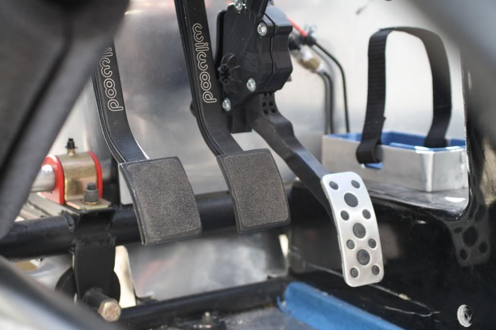

                            Mounted the STI pedal. The engine/throttle body is DBW so we had to get the DBW pedal.

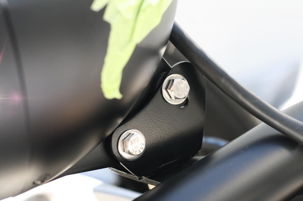

                            Headlight brackets
                            Here's how the headlights look...hood on, hood off
