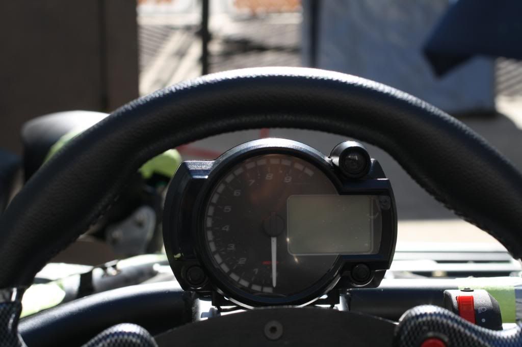

Yes. This one has a 10k max RPM but they make the same model w/ a 20k RPM
It reminds me of the one I had on my RC51. Is this a kit you can buy with all the sensors or did you pull it off a bike? Just curious how it reads out, magnet based like a lot of them?
