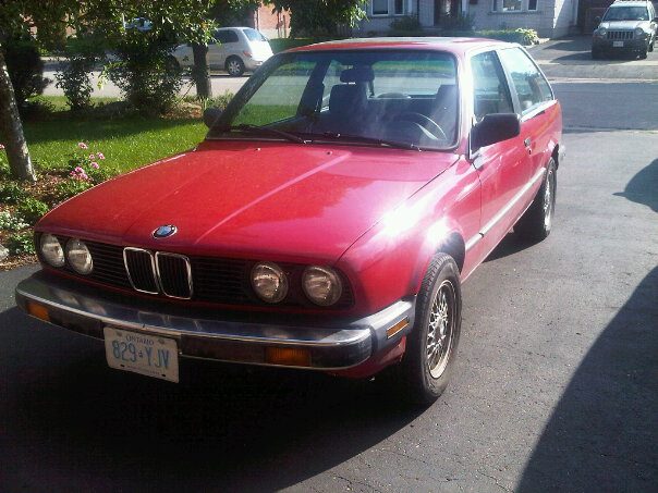

    I immediately replaced the brakes and rear shocks and started driving the car. It was a great deal of fun, but I started to realize that a stock e30 wasn't going to be enough for me.
    The first winter I completely overhauled the suspension with IE3 springs, bilstein sports, all new bushings and fixed a bunch of rust. The battery box, jacking pocket, and both front jacking points were completely rotted out and replaced, and anywhere with surface rust was hit with some POR 15 and fresh undercoating. Sorry I do not have many pics of this part of the build :sad:
    Once the spring time came around, this happened.

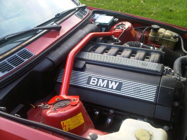

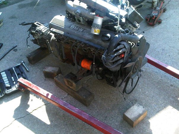

    And then this happened.
    M52b28, full obd-1 conversion, s52 cams, tuning from TRM. The swap was a lot of work, and I learned a lot from doing it. So now my zinno coupe is my daily driver, and next year it will be seeing regular track duty. It is dead nuts reliable, and the m52 is powerful enough to be a lot of fun on the track without being too much to handle as I am still learning a lot about how to drive well on the track.

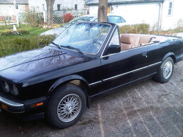

    A few weeks ago, me and a buddy were trailering back the e30 he had just purchased, and we saw this black vert with a for sale sign on the side of the road. After a few weeks of trying, I was finally able to get in contact with the owner and we set up a time for me to come look at the car. Needless to say, I bought it and am now the proud owner of 2 e30's. I suppose I just need a 4 door, m3 and touring now to complete the set :grin:

        Originally posted by dashboardmonkey
        Nice, 24v is a nice upgrade
        Yeah I absolutely love the m52. Sometimes I miss the 12v rawness of the m20, but I dont miss the constant valve tick and burning oil :D
        Originally posted by Poorboyz
        Very clean engine bay!!! One day...
        Thanks a lot. Yeah the m42 harness covers really go a long way to making things look nice and organized. They are really not as hard to fit as a lot of people make them seem, just a few minutes with the zip ties to get the harness in there.
