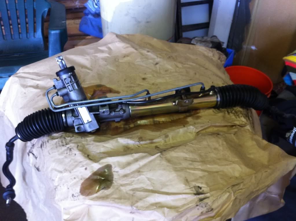

                      I found a nice Z3 that Massi at Saab and Volvo Dismantling let me pick something off of:
                      Z3 2.7L/L Linear Steering rack
                      :firehop: :firehop: :firehop: :firehop: :firehop:
                      Isn't she pretty? :mrgreen:
                      Pulled from a 1999 Z3 2.8 with 61k miles that failed because of electrical problems.
                      Just replaced a few O-rings and this beauty is good to go; ready to mount

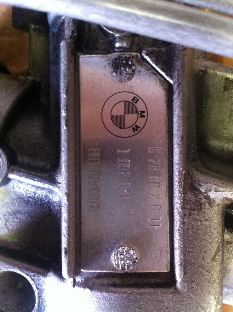

                      Here is the part plate; these racks have been discontinued by BMW and have been replaced by e36 racks with 2.7L/L. They won't have the same travel distance because they have been cut short. If you want an original Z3 Rack 2.7 L/L with the 54.5mm travel, you need this part number!
                      It reads 1 092 031
                      BMW complete part number reads:
                      32 12 1 092 031

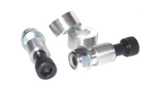

                      Just need to find new tie rods; should order my spacer set from AKG within the next few days.

                        Ordered my AKG steering rack kit; should be here by Thursday. Super excited

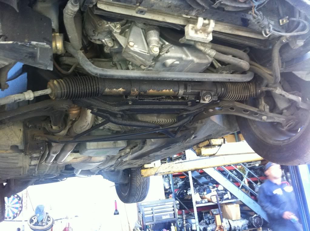

                          Here's a picture of the glorious Z3 rack before being pulled just to null you all over (it's the only pic that seems to work ATM)
                          (And yes, I did replace that tie-rod ;D)
