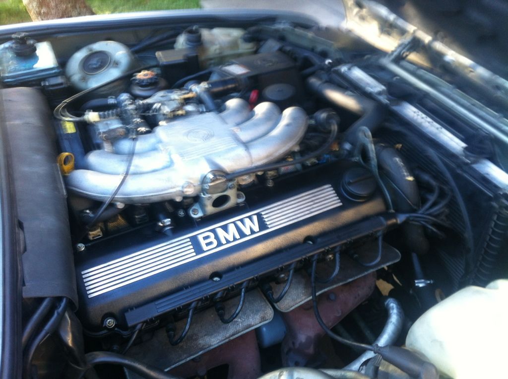

                    So I've had this box from BMA sitting for the better part of a month
                    All sorts of goodies inside
                    Opted for the more expensive good stuff as well cause well.. It is an iS ( )
                    GRAF Water Pump
                    INA Timing Belt Tensioner
                    Continental Belts (Timing, AC, Power Steering, Alternator)
                    Behr 80* Thermostat
                    Genuine BMW Coolant
                    New OEM Breather Hose
                    New OEM Intake Boot
                    Red Rocket Labs OBC Temp Sensor
                    Bosch Spark Plugs
                    (Installing the last two at a later time)
                    You guessed it.. IT'S TIMING TIME!
                    Rise and shine! (7:30AM)
                    Splash guard out.. FILTHY!
                    Hoses out! radiator out!

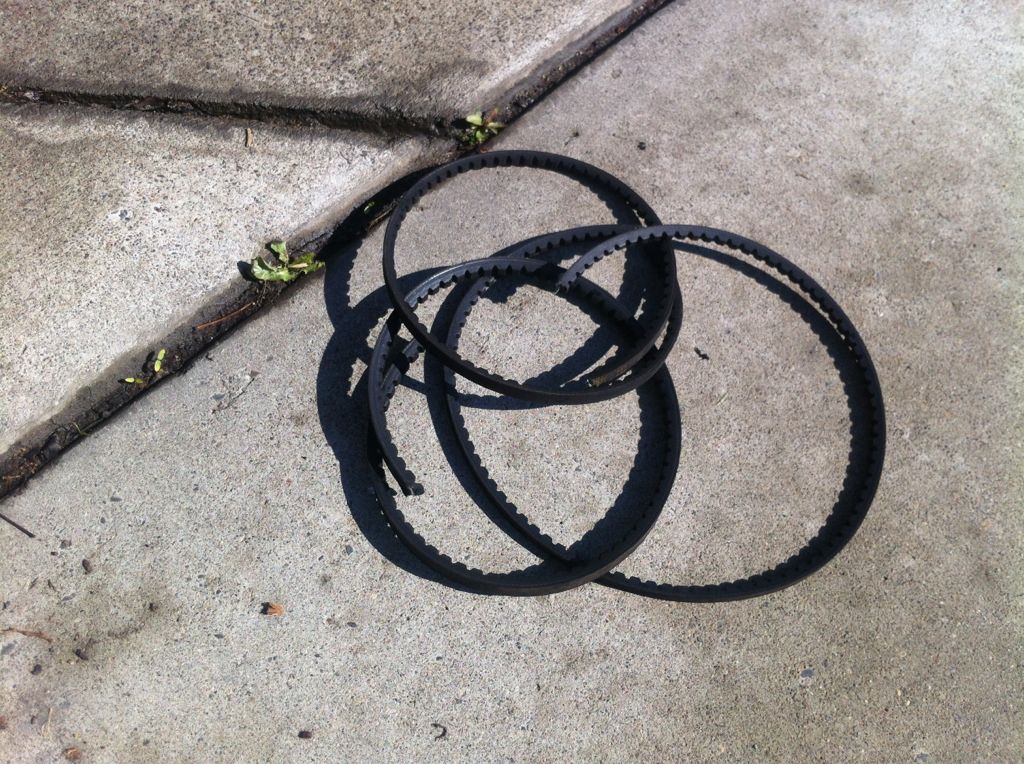

                    Belts out!
                    Mechanics, aka monkeys with wrenches, love to over-torque these dang fan clutches. WHERE THE HECK IS IT GONNA GO??? It has a reverse thread for petes sake!
                    This has happened to my last e30, so i followed suit like i did last time by ending up removing the whole water pump assembly with the fan clutch still attached, then taking it off outside the engine bay
                    Some mental swearing, brow throwing, and about 30 more minutes later, VIOLA!

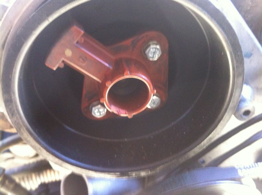

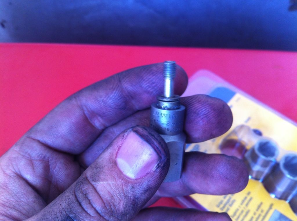

                    Then I stripped those dang Allen key bolts on the rotor :curse:
                    Luckily, I had my extractor sockets that I ended up buying for my 5-speed swap when we stripped the starter bolts. Tools really do pay for themselves don't they?
                    Another 30 minutes later of hammering away in tight clearances
                    BADABING BADABOOM KACHOW BROWNCHICKEN-BROWNCOW
                    Cut 'er loose cap'n!
                    After that, everything went smoothly; timing belt n, tensioner in, water pump on, pulley on, bottom crankshaft on.
                    Then we got to the rotor. Had to custom grind some 8mm bolts I picked up at the hardware stor from down the street. By no means pretty, but better than those Allen key bolts. Screw you BMW; Screw you. :weak:
                    Perfect for when I have to replace that rotor soon

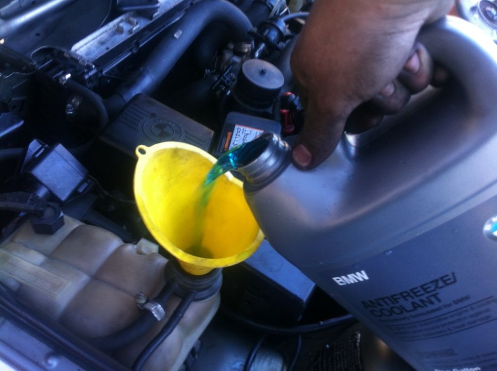

                    BM-Freakin-W Blue bling swag coolant
                    In it goes
                    All buttoned up and ready for another 60k miles
                    Ending time: 5:57PM
