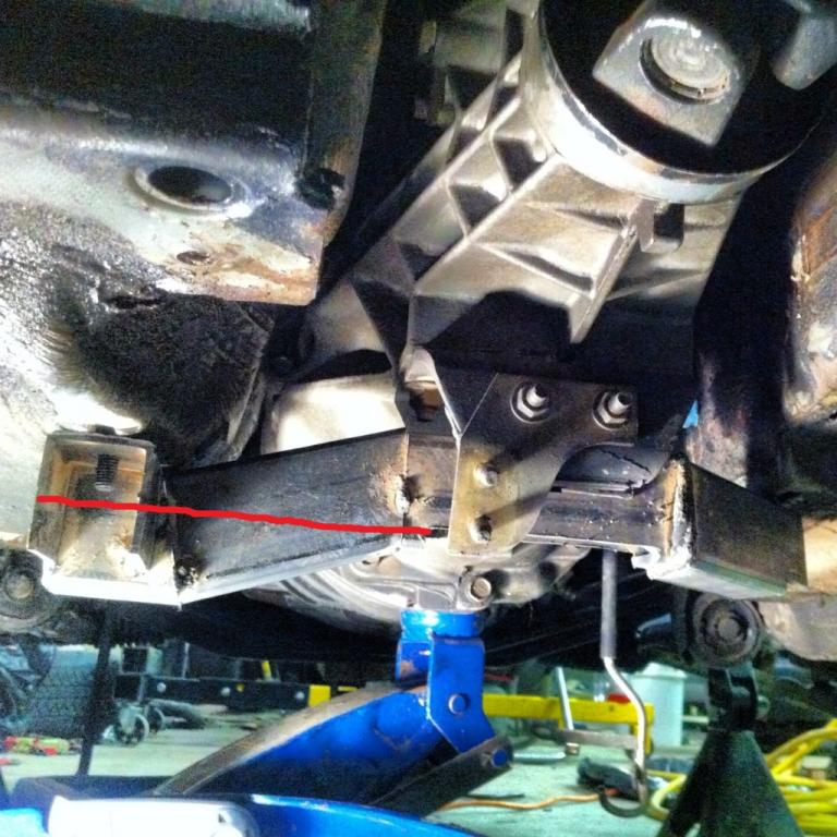

      Your car is also very low, you are bound to bottom out and catch on speed bumps. I would remove the brace and cut out this bit pictured below then box weld the bottom solid. If the other side hangs down I would do the same.
      Build looks great though! Godspeed on the first firing of this new power plant.

          The tranny brace isn't as low as it looks, but i am doing what you mentioned in that pic. Just gonna cut that section out and weld some plate in.
